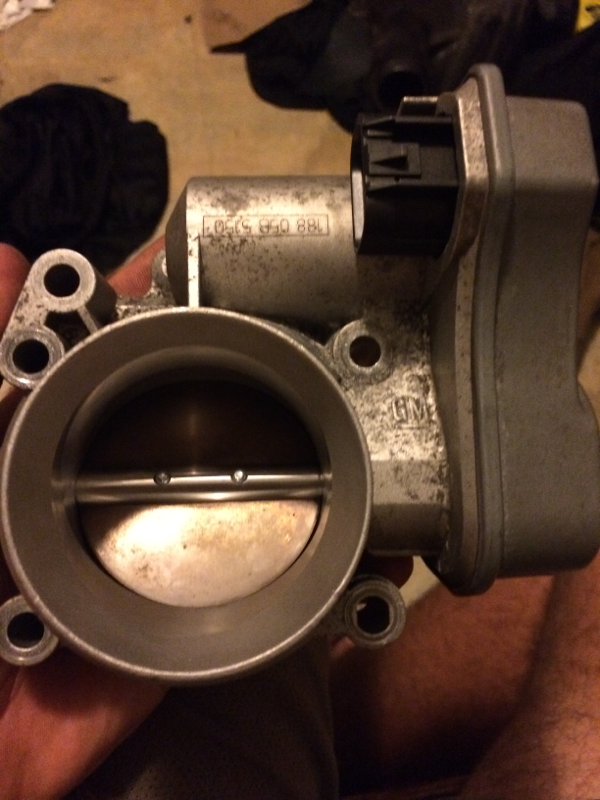

So I have this throttle body I bought on here. I have a 2009. This throttle body looks significantly different than mine and it even has the butterfly valve in the opposite way of mine. Don't know what this means. Could it possibly be that it's from a different year so it won't work?

As soon as it started up it was really loud for a split second and then died down and turned off. I put the old throttle body back on and she runs normal again. I just wanna know if I can use this throttle body.

That looks like a 2005-2006 throttle body to me. Do you have the adapter for your 2007+ wiring harness? Because if not you can't run it. Also you generally can't run a bigger throttle body without a tune. The throttle body scalar and idle airflow needs to be tweaked. There are some exceptions. I ran a 2010 TB from a 2.4 on my 08 and didn't have any problems for the year I ran it that way. It also needs to be synced so the computer knows where closed throttle is. Anyone with HPT scanner can do this (It's called "throttle body cleaned reset.")

I have the 6-8pin harness. I think what you are saying is what's wrong with it. I'll just sell this one and say **** it. I'm gonna buy a lsj throttle body because I wanna piece a supercharger kit together. Not worth the hassle of finding someone with hptuners

Did you unplug the battery for anywhere between 10-30 minutes?

I unplugged the battery for the time I took off the throttle body and put the new one on.

The pins on an 8 pin 2.4 tb and an 8 pin lsj tb are different. I'm pretty sure zzp's connectors the 8 pin side is designed for the LSJ so even though you bought the connector you would need to re pin it to make it work right.
Damn well, i might be selling an engine block I have this Saturday and I'll be able to buy a supercharger from mongo after I do that and then I can buy an lsj throttle body with this next paycheck. And just part after part until it's ready to be built. Selling the 05-06 2.2 throttle body as well if someone will buy it and I'm keeping the adapter for the lsj throttle body.
