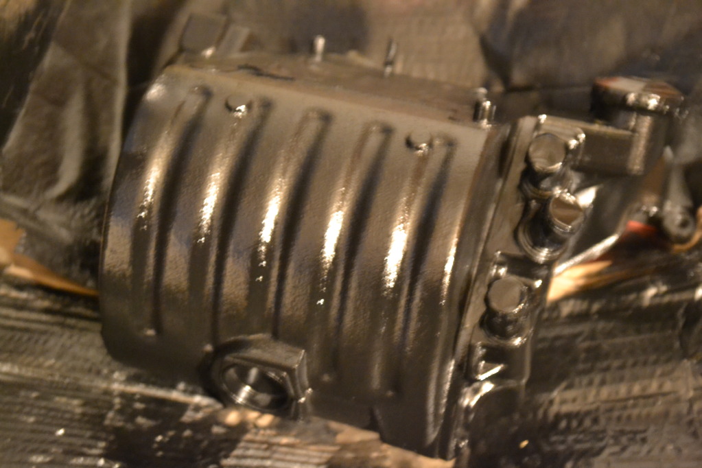

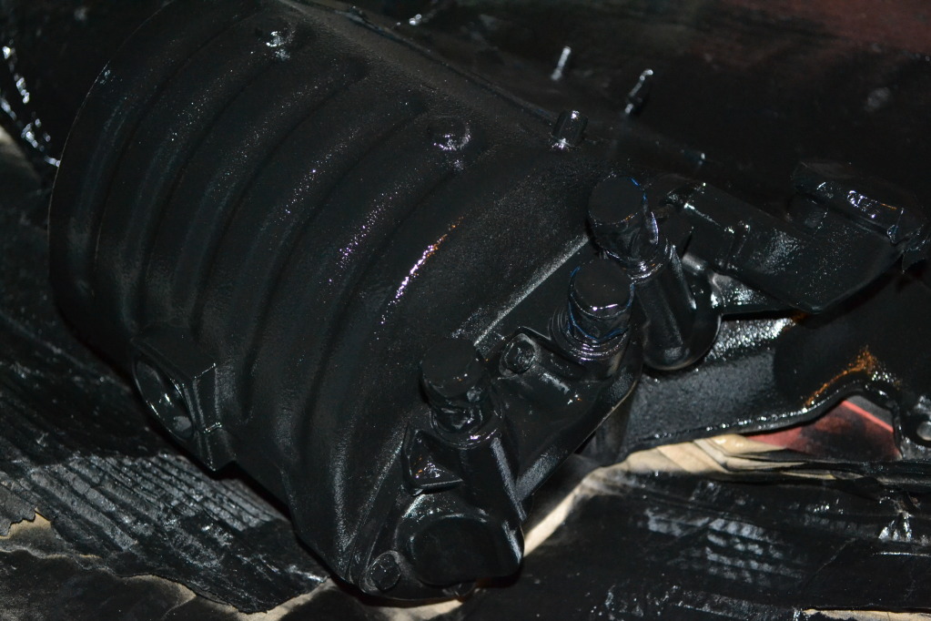

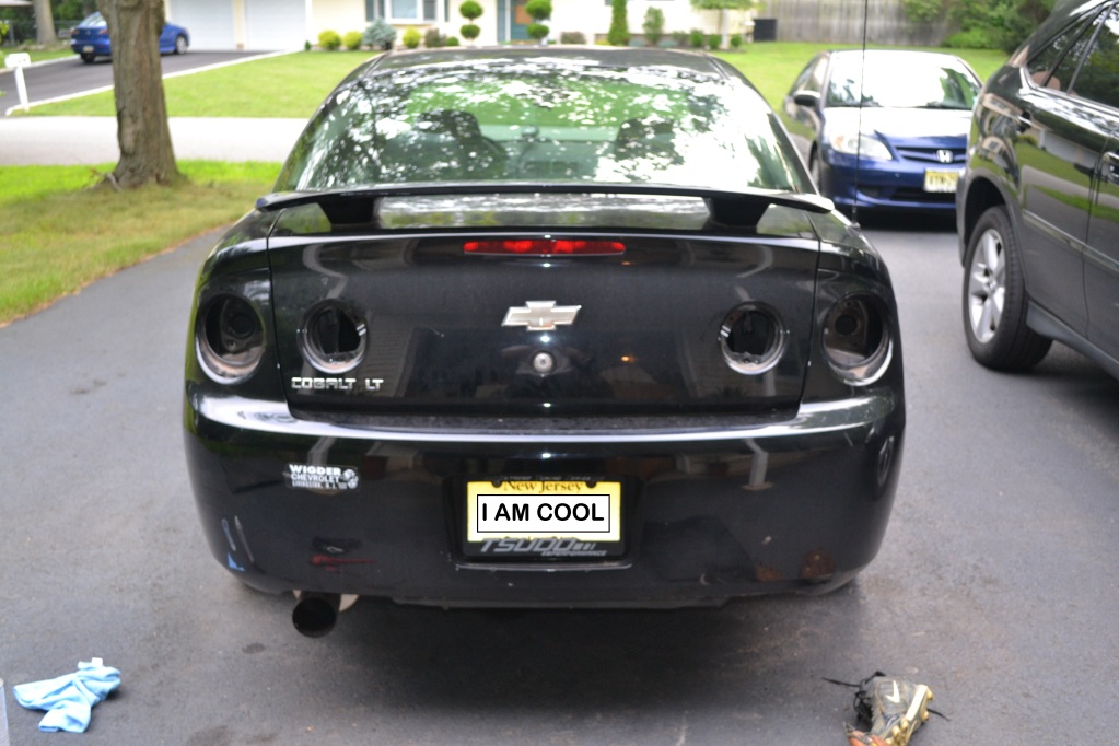

Decided to paint my intake mani. Tried tinting my tails with plastidip smoke, but i ran out before i can get it darker. maybe another time haha.

Thought this looked cool lol

how did that dip smoke work out?

I went through a can doing light coats before it got dark enough and it just looked like my tail lights were foggy. im gonna try again but start with 2-3 cans and probably thicker coats.
