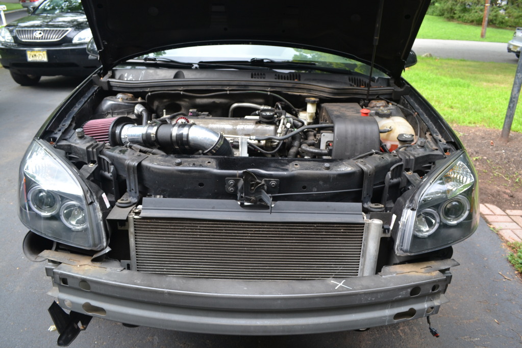

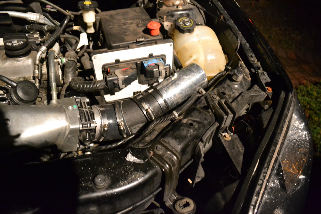

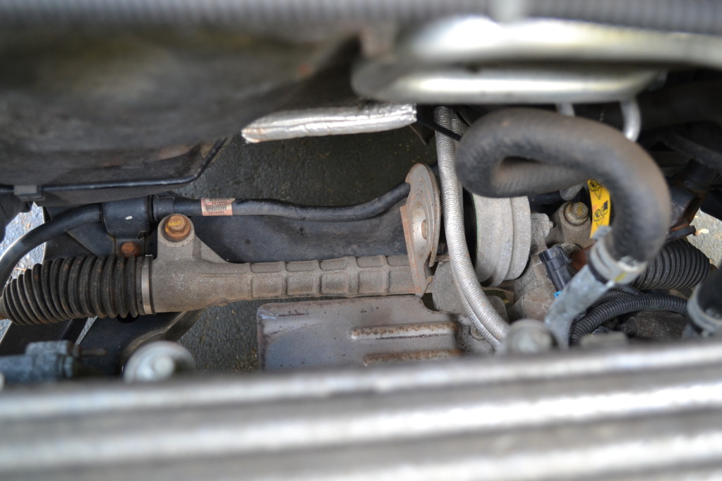

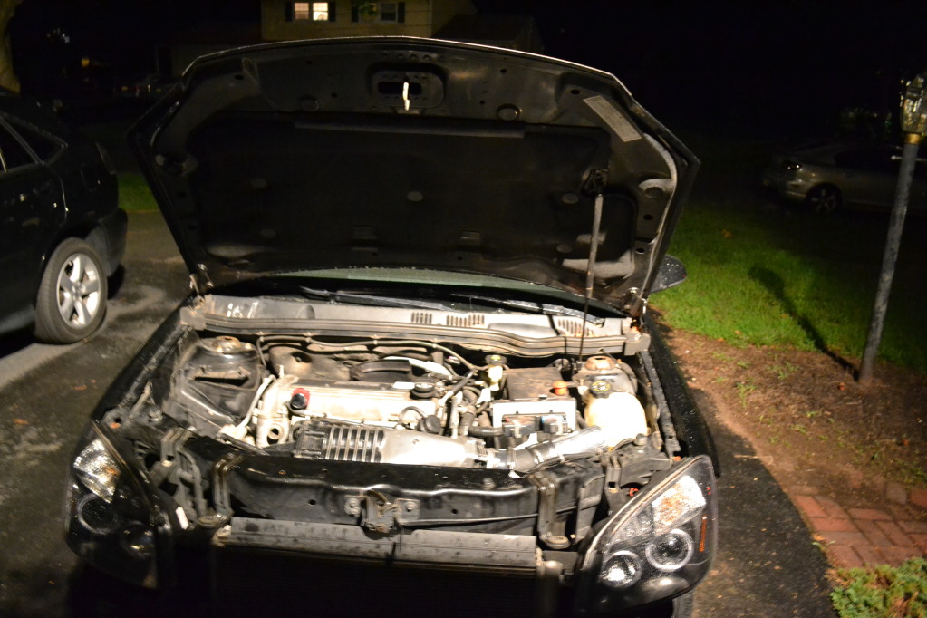

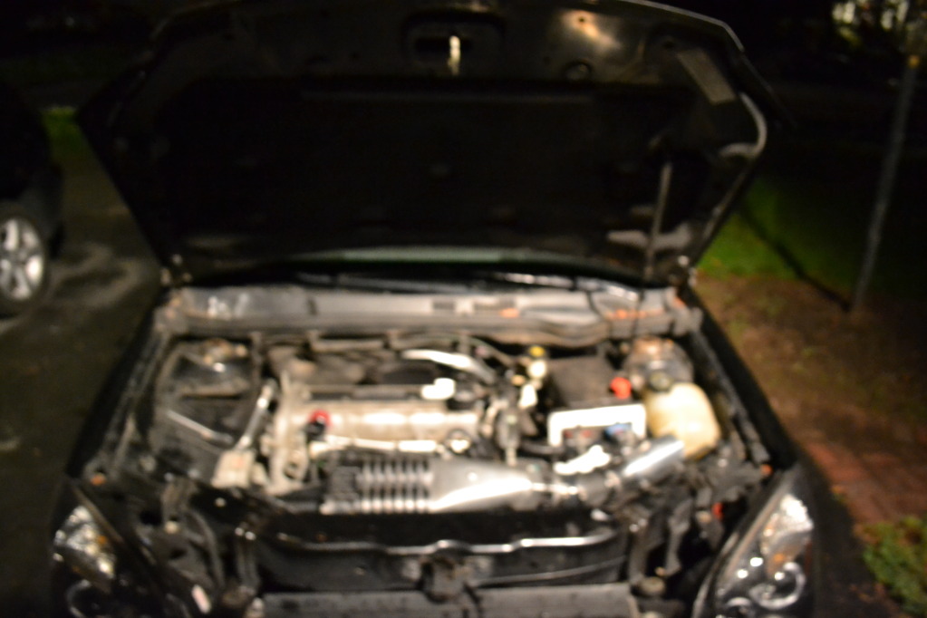

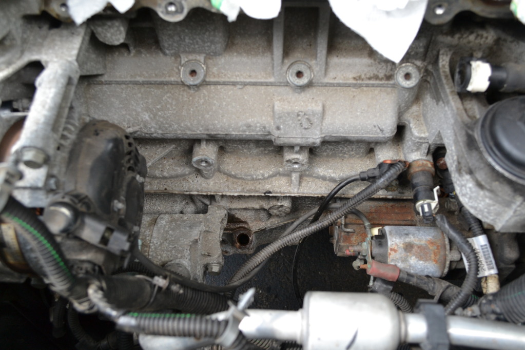

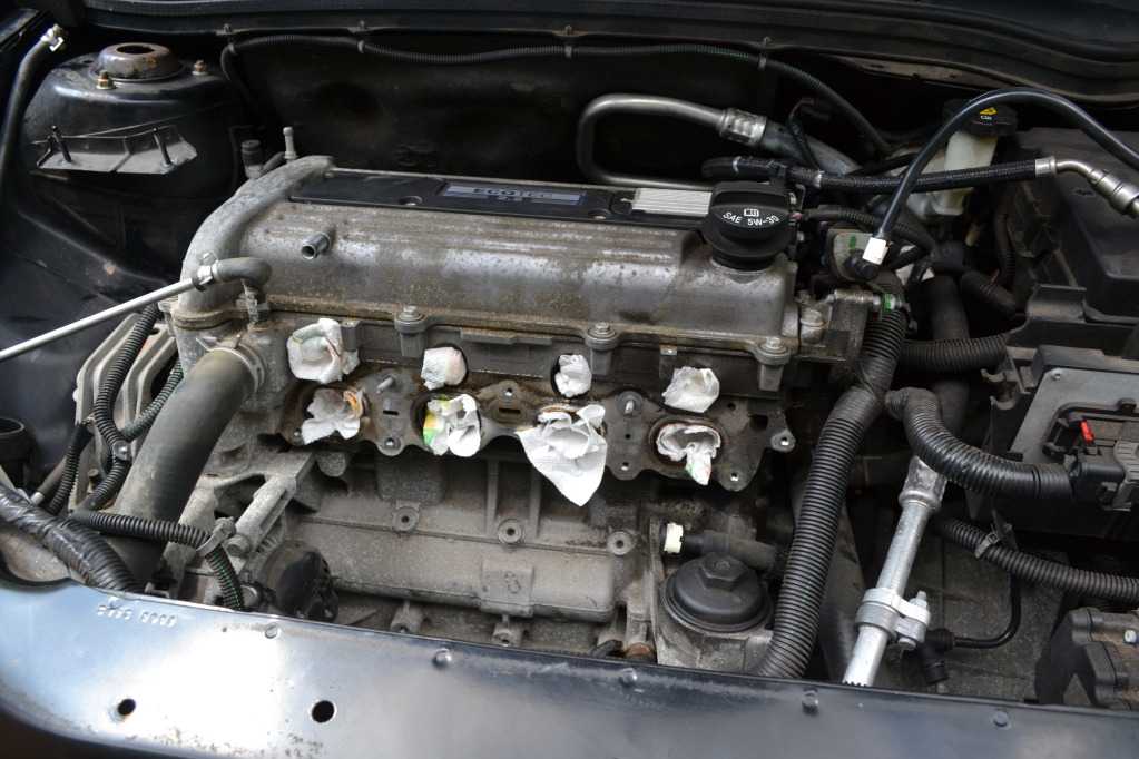

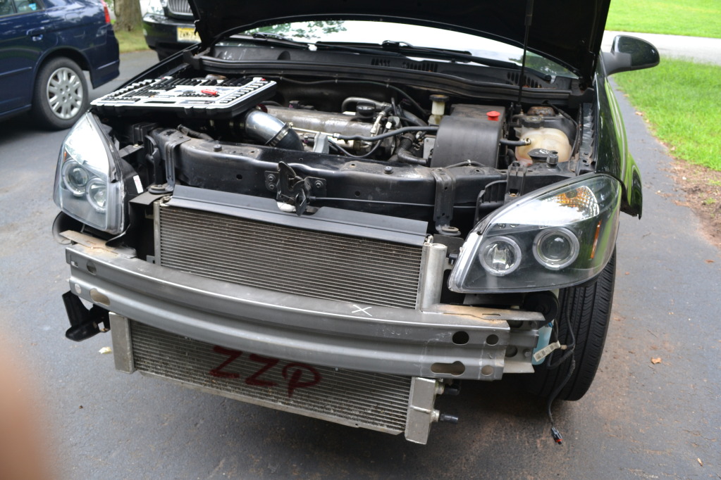

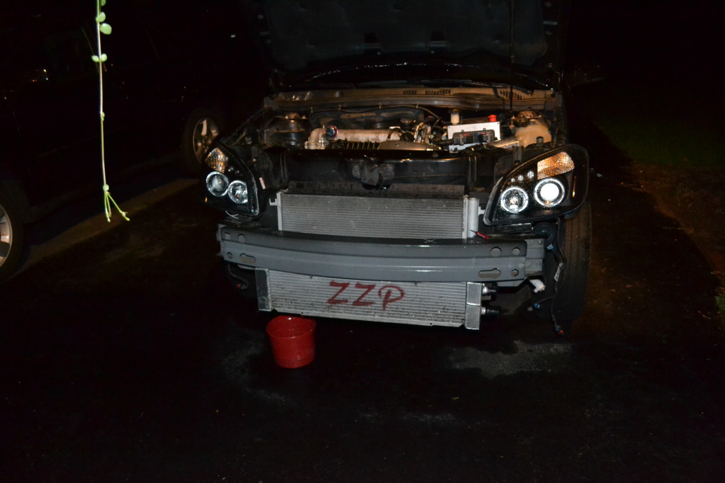

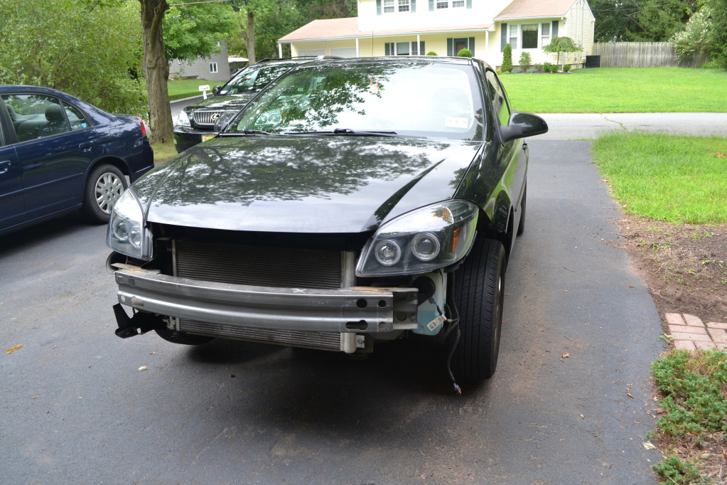

did a fuckton of work today lol. i got carried away. my tune isnt even gonna be ready till next week but i figured i'd start. and ended up nearly finishing. all i have to do is the plumbing, wire up the h/e pump, finish jerry-rigging the intake, and tune. still deciding on an aftermarket downpipe. 3"catless sounds good? or ill just get a bung on my stock one.

wat does the larger nipple on the supercharger supposed to be connected to?

figured it all out. my build is basically done, just need to install the downpipe, connect the hoses to the coolant tank, finish the intake, and get one more fuel injector clip (don't ask haha im stupid). and then the tune. :-)
