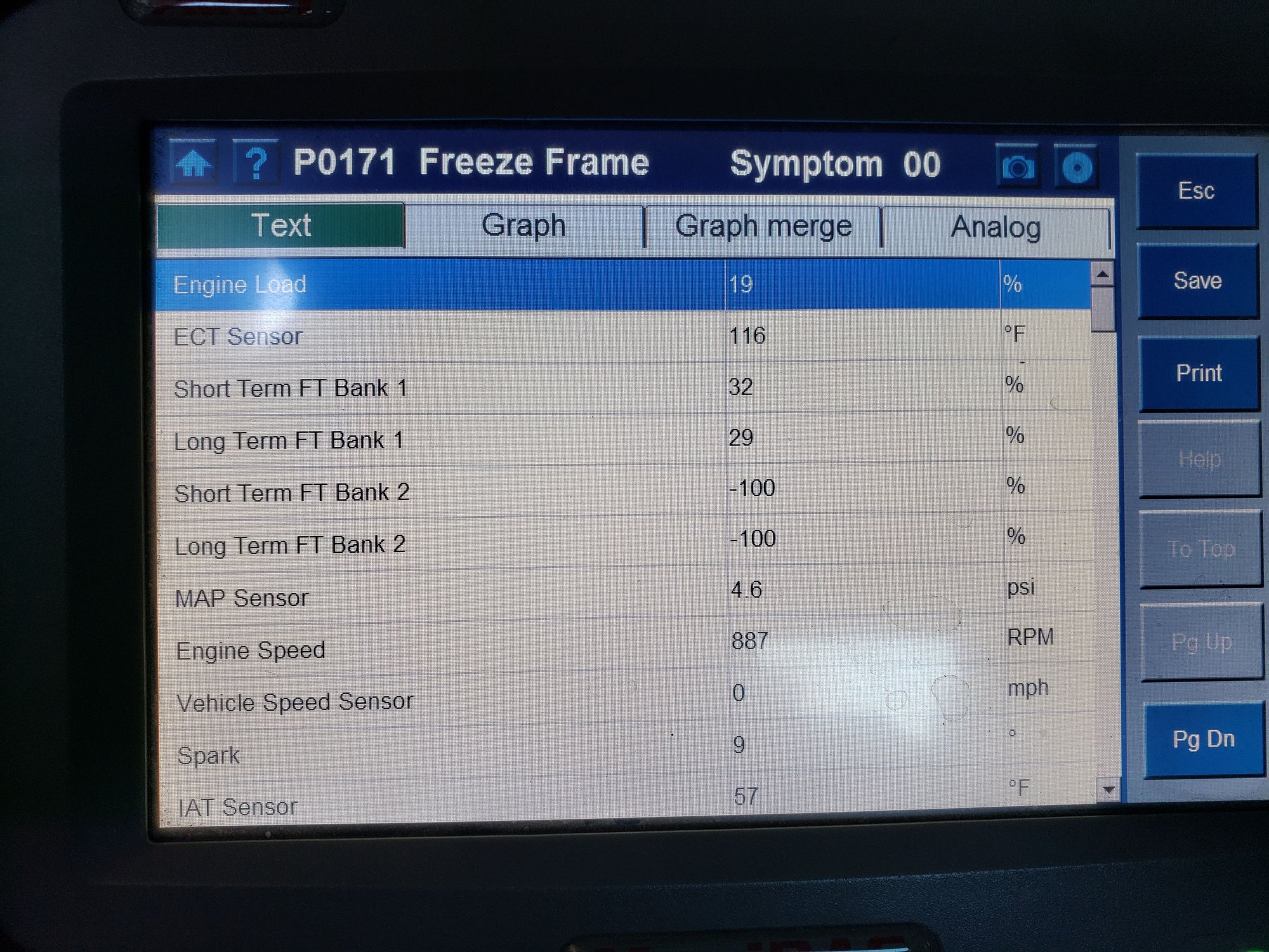

Have a p0171 lean code. Need some help figuring it out. Ass soon as cobalt starts engine stumbles a little. Short trim goes to +30 and long trim goes to +28 . Press on gas and no change until I let off the gas and short trim goes down a little bit and then back up . Here are some freeze frame data in pics. Has new map. New cat. New etc sensor. New air filter. New upper 02 sensor. I've tried 5 different mass airflow sensors. I've smoked tested motor and exhaust with no leaks. I've tried carb cleaner trick while running to see if idle will change no effect. Only thing I notice is fuel pressure key on is 55psi and once I start goes up to 68 psi running 50 to 60 is range but would that really cause a lean code? Also tried a set of different injectors with no change. Ecu is refurbished new also. Any help would be appreciated

You're throwing a lean code because you're running lean; Fuel Trims maxed out and O2 sensor shows lean. You may as well slap a fuel filter in there, $12...
Do you have hptuners? Need to check your tune or re-flash it with a factory tool. Refurbished ECU might have the wrong fueling (airflow) calibration for your engine because it seems like you've covered most of the bases for this type of problem.

Your baro is off by 1 psi for Omaha Nebraska checked as of now, but I assume you took the snap shots at a different time. Still, if Sensor 1 is reading lean, then by golly the ECU will throw fuel at it, you can see this in the fuel trims. You may have to get down and dirty, continuity check the O2 wiring between the connector and the ECU, and check all those wires for a short to ground. You'd be surprised...

Map sensor was withing spec 96kph I believe key on engine off
