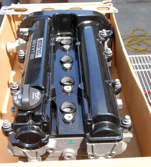

I just sold my assembled head to a guy doing a nice LE5 HHR SC build. Moved it fast cause I priced it to go: $600 and were close enough to just hand it off.
I will hold onto the meth kit for a bit for you.

That would be ME!
Not going too wild on my SC install, just a semi daily driver that I like to park and bs at some cruise night type places around me, and show her off some.
And i'd like a little more Ballls than the 2.4 auto trans is giving me currently, none.
I can't wait to get going on this Project.
