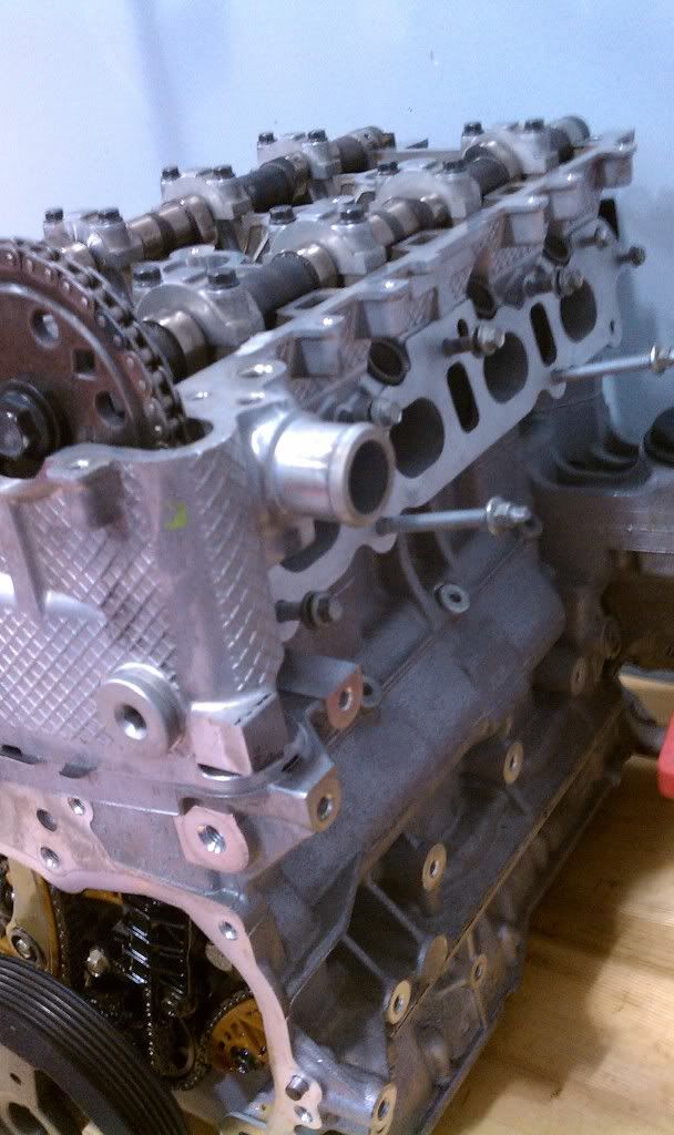

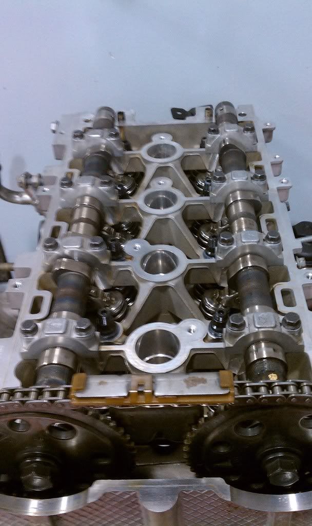

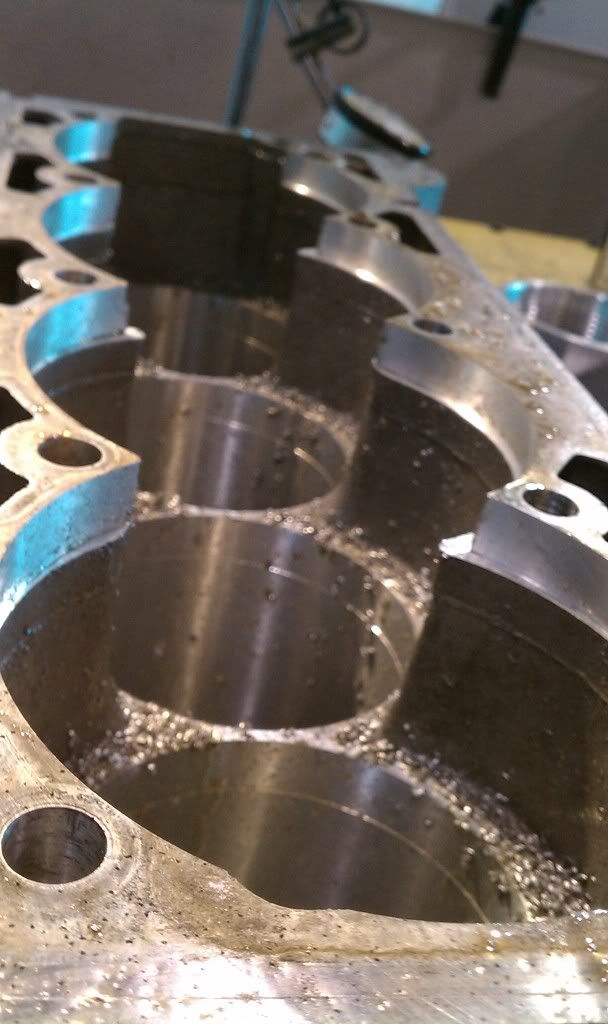

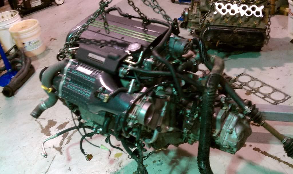

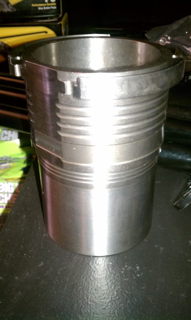

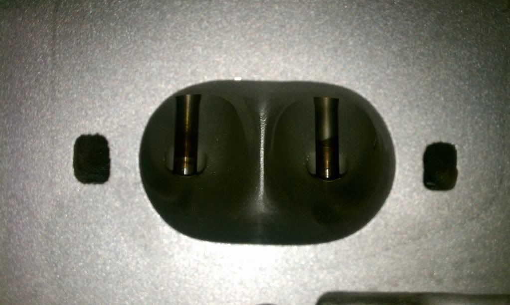

Picture Timeline

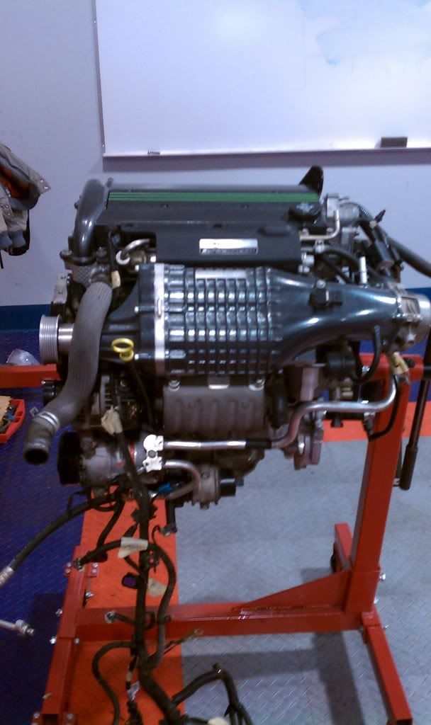

Ok, I will post up some pics of the process that I uploaded from my phone:

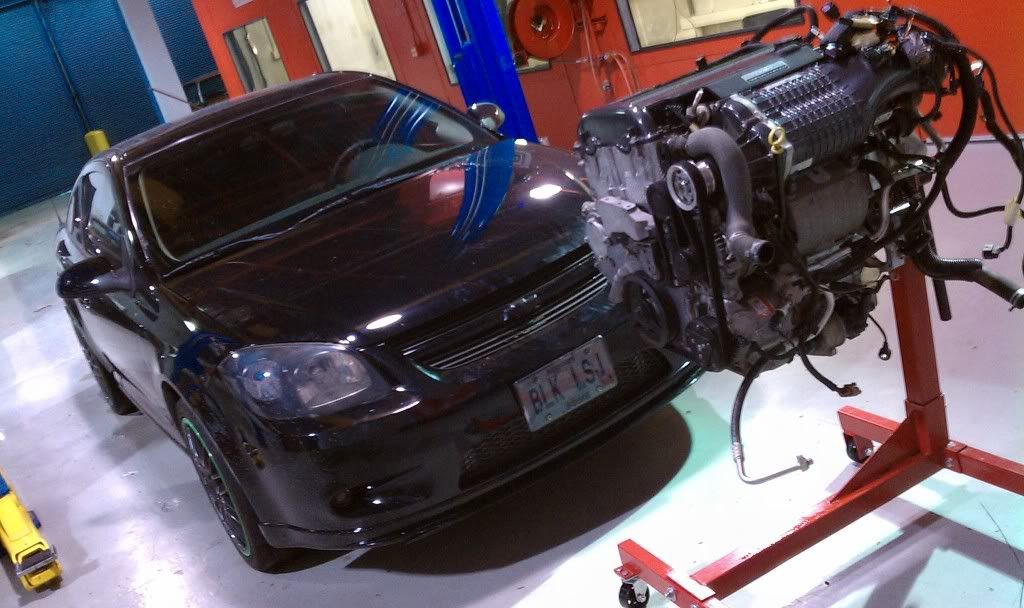

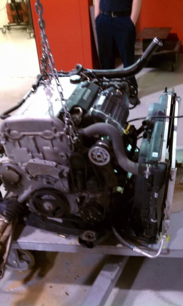

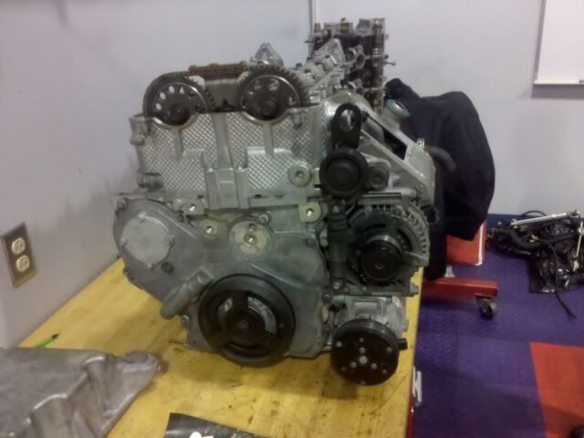

When the engine was first pulled out

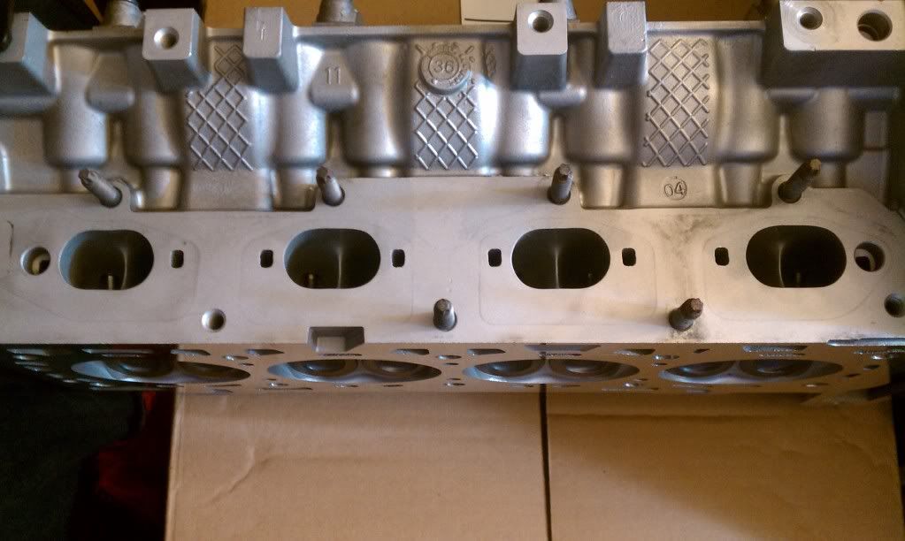

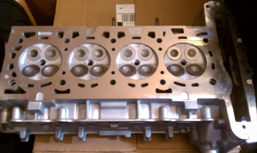

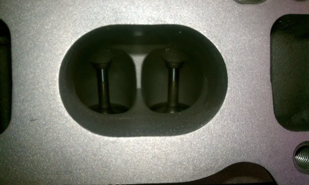

Ported head (Intake)

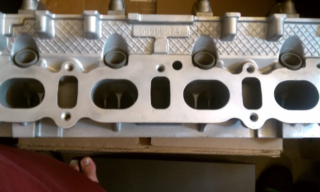

Ported head (Exhaust)

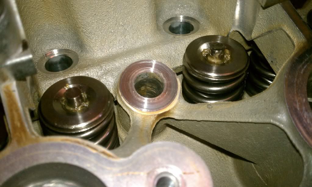

Valves/Springs

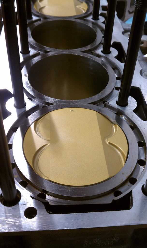

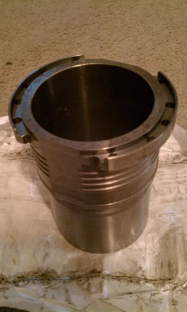

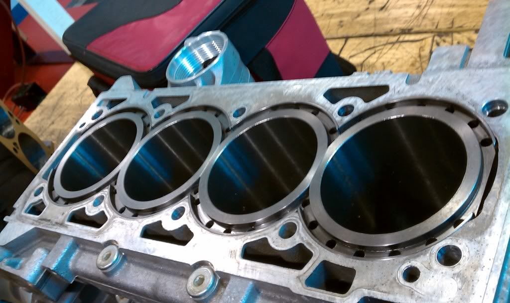

Sleeves

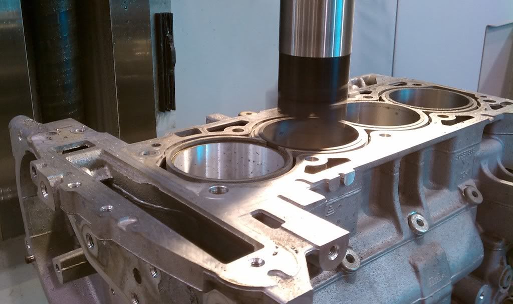

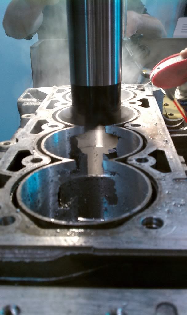

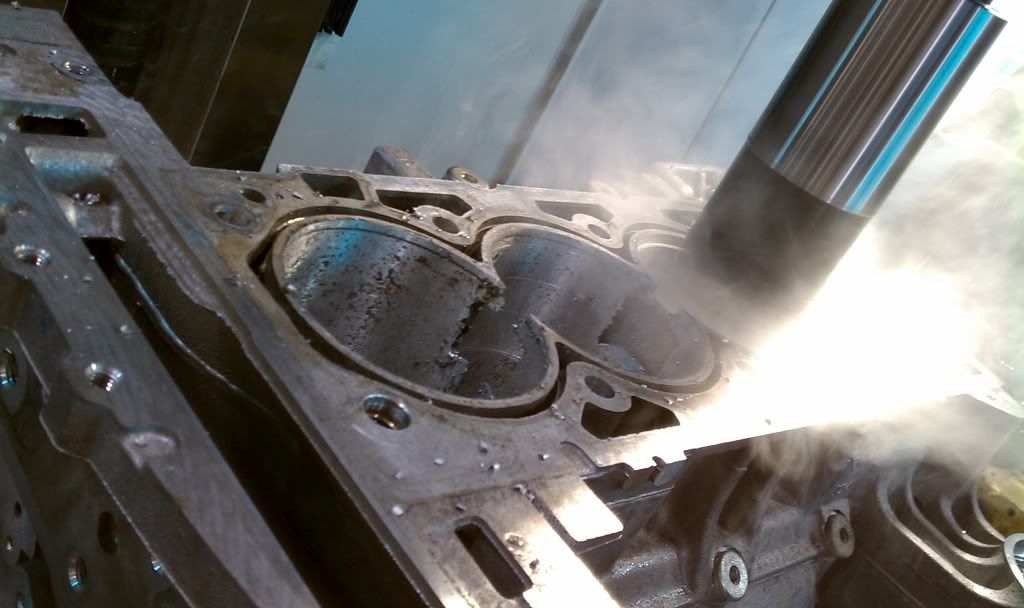

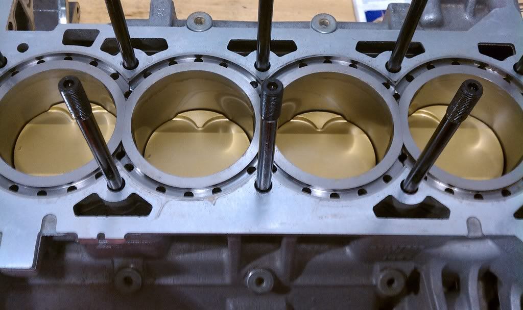

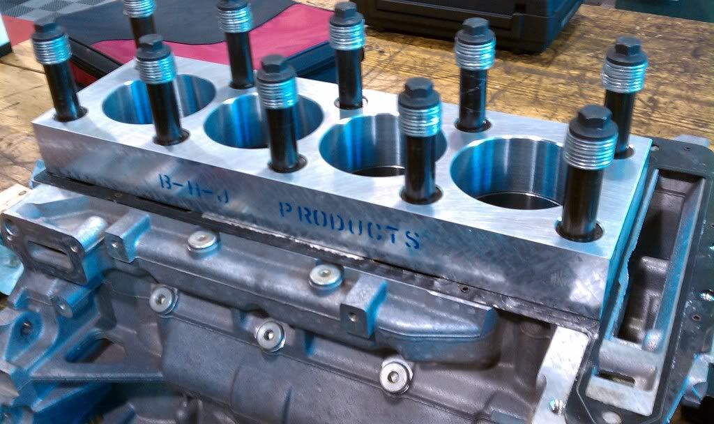

After the engine was torn down, got it on the CnC machine to remove stock sleeves

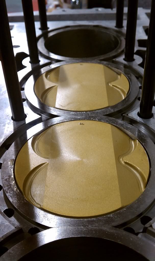

Pressed the sleeves in, then torque plate overnight
Then decked it

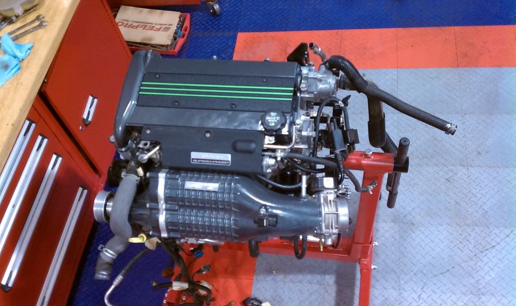

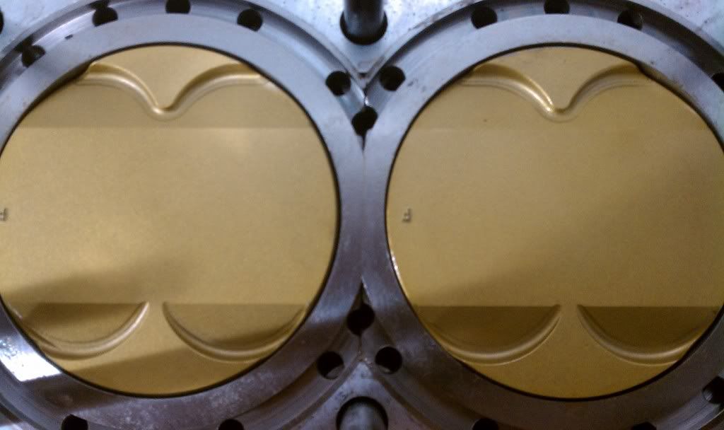

Then the fun part
Then put the head on, timed it, ect...

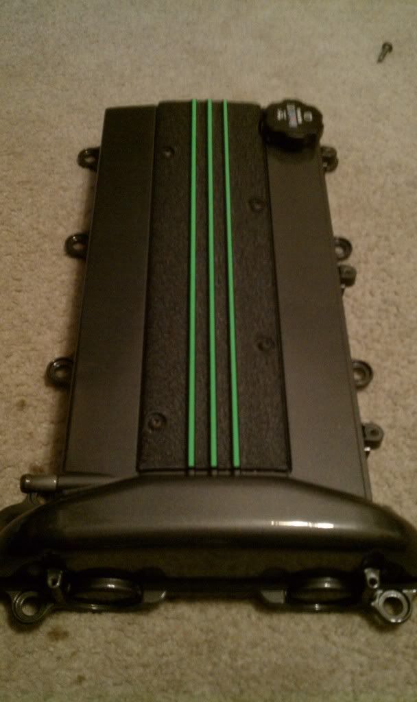

Front cover on and accessories going back on, including my newly powdercoated valve cover
Tranny back on

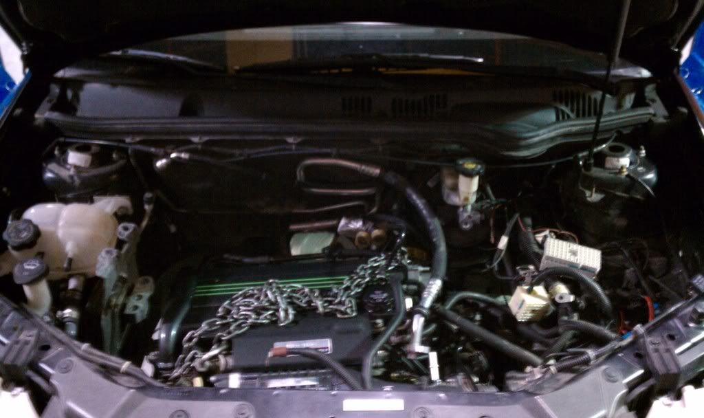

Brought the car back in
Almost in
Done and home
