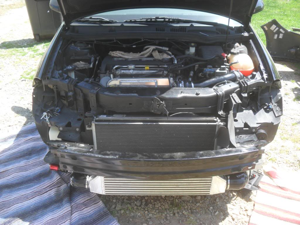

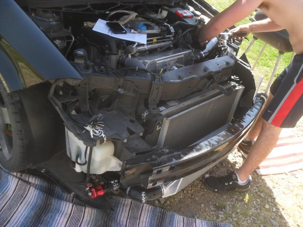

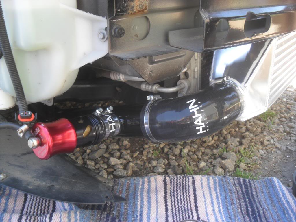

Progress on intercooler and charge piping begins.
Good ole ground clearance
All put together. More parts to come. Stay tuned.

Damn that charge pipe hangs LOWWW
Old Apr 9, 2013 | 02:00 PM
  #115
jonathan923's Avatar
Joined: 01-07-09
Posts: 7,851
From: Queens, NY
lol i highly suggest you take off those worm clamps and get Tbolt clamps asap or you wont be able to tune your car at all lol
other than that its all coming out real good
Old Apr 9, 2013 | 02:02 PM
  #116
Tony Pshenichnykh's Avatar
Joined: 01-17-12
Posts: 423
From: Potland,OR
Looks tight, can't wait to see dyno results
Old Apr 9, 2013 | 02:07 PM
  #117
Joined: 01-07-09
Posts: 7,851
From: Queens, NY
another thing, the charge pipes on your intake side are probably going to start hitting the plastic guard inside the fender. just letting you know because little by little the tires start eating all that plastic and you end up with a hole there lol.
and question, do hanh steel do charge pipes made of steel and weight like crazy?
Old Apr 9, 2013 | 02:51 PM
  #118
Bad-A-SS's Avatar
Joined: 10-18-11
Posts: 1,389
From: Hickory
Yes they are heavy as hell and why should i go to t bolt clamps. Do you really not think they will hold? Anything else i need to know
Old Apr 9, 2013 | 03:38 PM
  #119
Joined: 01-07-09
Posts: 7,851
From: Queens, NY
i am sure they wont hold, trust me the minute you start tunning your going to see your self putting back lots of pipes lol i had the same setup same piping and got the same advise from fellow turbo lsjs with same hahn parts. but in general with any kit its much much better to go with much better Tbolt clamps than those shitty ones they send.
in the end you tight them once and never again you have to bother with them. also i had to replace some of the hahn couplers after a while because they tend to brake easy with lots of boost pressure...other than that i think everything else is fine..
the good thing about those pipes being made of steel is that since your passenger side pipe goes under the subframe when it hits pavement or bumps it doesnt crack or bend as easy

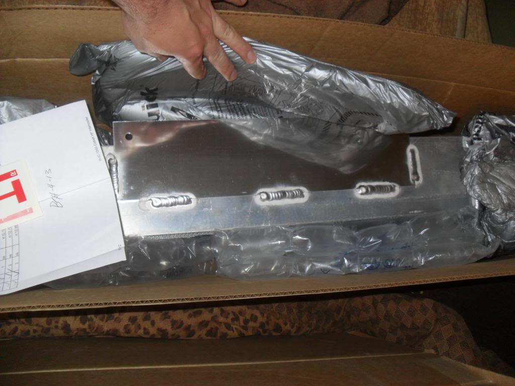

Parts are here
More pics soon to come
