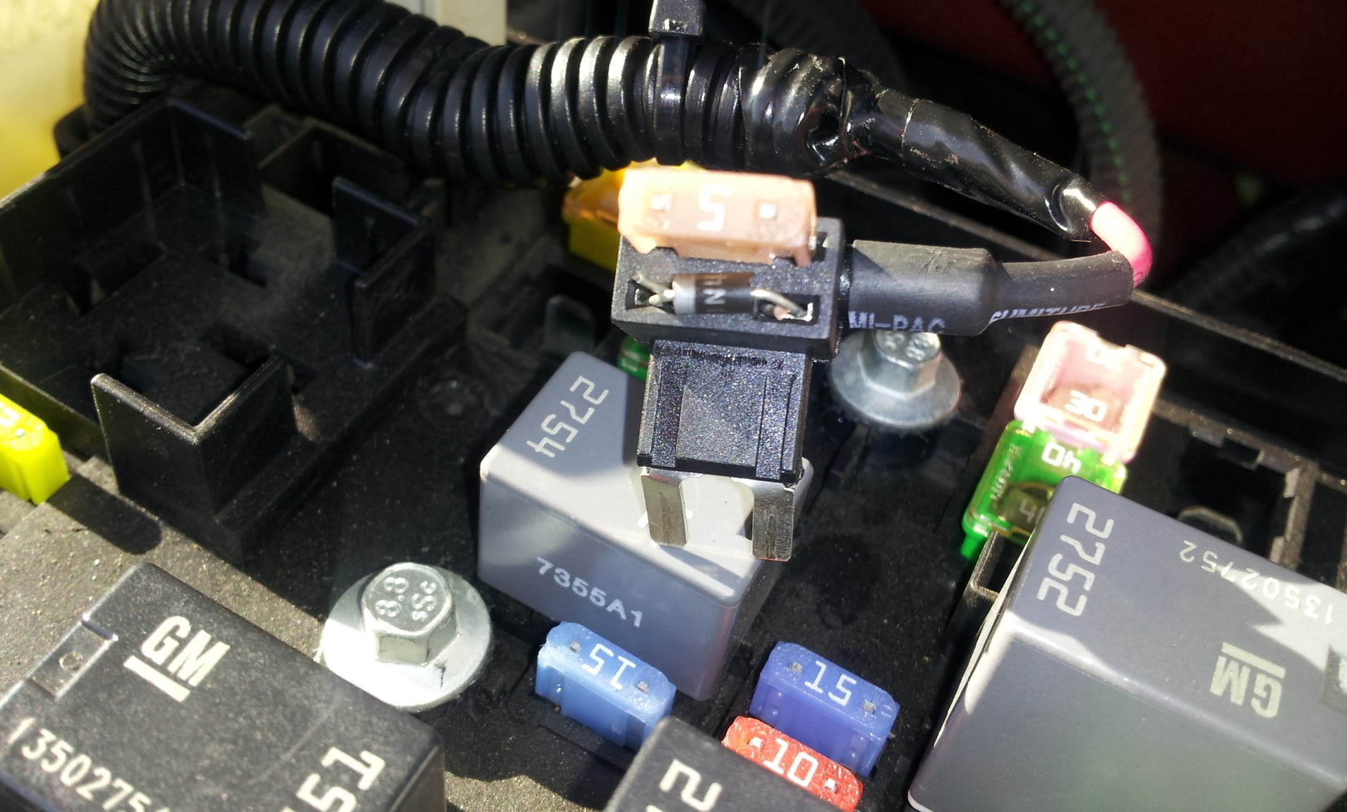

Or buy a set of LED halo rings are strips, then use a fuse tap on the DRL fuse slot, run that to a relay, then connect the relay to the battery (fuse box positive pole) and the LEDs.
Just a small amperage fuse on the top slot, then a diode in the bottom fuse slot if you want the LEDs to stay on with your low beams.
Run the wire to either the 85 terminal or 86 terminal of the relay. Ground the other terminal. If you're OCD, connect that wire to 85, then ground 86. Either way, the polarity on those terminals don't matter. Connect the #30 terminal to the battery, then connect the 87 terminal to your LEDs.
Important: Make sure it's inserted this way or it won't work. So you'll have to bend the prongs.
As you can tell, I basically made my own relay harness for my LED halos. Been working great with no issues for over a year now.
