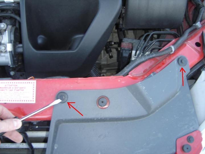

I've searched but can't seem to find the correct clips for the upper grille part. Anyone help me out? Thanks!

5973400
Old Jul 14, 2015 | 06:30 PM
Anyone know the number for the one in between both arrows he was asking for?
Yours fall off after your intercooler swap too?? LOL. I had 1 for a while after but it fell too lol

I had both but for some reason when they painted the car they didnt put them back in and i got one from a salvage yard but still need one more

Originally Posted by snail_ss
anyone know the number for the one in between both arrows he was asking for?
22552599 08.024 bumper, hood adj frt a 2005 - 2010
25530263 08.024 bumper, hood frt (push-in) a 2005 - 2010

Originally Posted by Fsanti87
5973400
Says 1/2" stem size though for that one. I measured the hole and it's only 3/8"
Did you measure the hole on the grille or the frame? That's the only part number they list for all 2005-2010 models.
Plus before you push the pin down it'll fit through a 3/8" hole. I got one in my hands right now

Found some that are really close if not the exact one the car comes with
Part number is 22535007

Yup and that crosses over into the 5973400 number I posted
