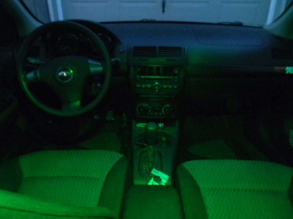

Got them in today from superbrightleds. I got white and green dome lights, trunk lights and a white license plate led. Here are some pics of the green that i have in right now. Ill get some pics of the white and the license plate light up soon.
Super easy instalation. Just pop off the dome light, press tabs inward and light falls down. Clip new one on and good to go. Trunk just pop off clear cover, unplug old bulb and pop in new leds. License plate light assembly comes out after the 2 screws are taken out. Twist to release, swap bulbs and but everything back together and in.

Very nice, I want blue

Seems dim in the pix

Ya it does, i think its cause it was still light outside. They look brighter when its pitch black and of course the white will be brighter then the green.

Looks great! This makes me want to put blue ones in mine
