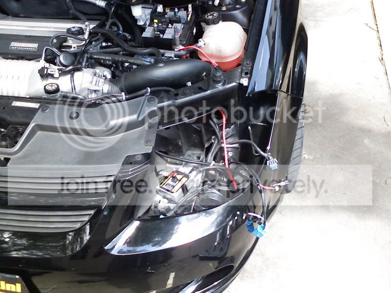

I have Gen 2's and the 3bspec HID kit.I have them out of the car now, just wiring the bulbs in. I have the harness already wired to the car, grounded and powered to the pole in the fuse box.
The light blue plug in my 9007 adapter that came with the 3bspec kit. It has the light blue wire, a black and white that go to nothing (General ground and high beam wiring, according to their manual)
Do I need to splice this off entirely or plug it in?
Everything comes on BUT the HID's. I don't want to cut and splice that in if I don't need to/it'll **** something up.
I think it's a remote wire?

do you have a pic of the wiring of the headlights itself? I Have wired up my 3rd gen projectors with the 3Bspec kit and i just cut the blue 9007 connector off the HID harness and spliced into the low beam wires on the projectors and plugged in the 9007 connector from the projector headlights into the stock harness. hope this helps. It was super simple but i don't know if the wiring for the 2nd gens are the same as the 3rds.

I assumed that's what I'd have to do, but decided to wire them without the harness for now; I still need to aim them, but they're in, and working.
