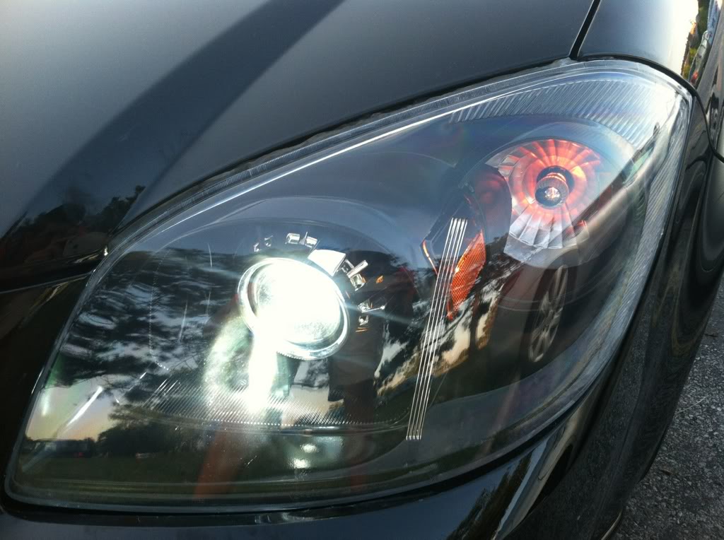

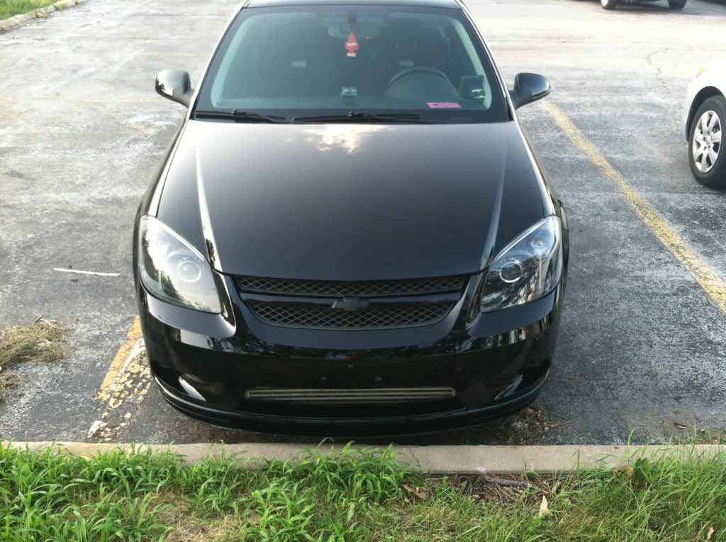

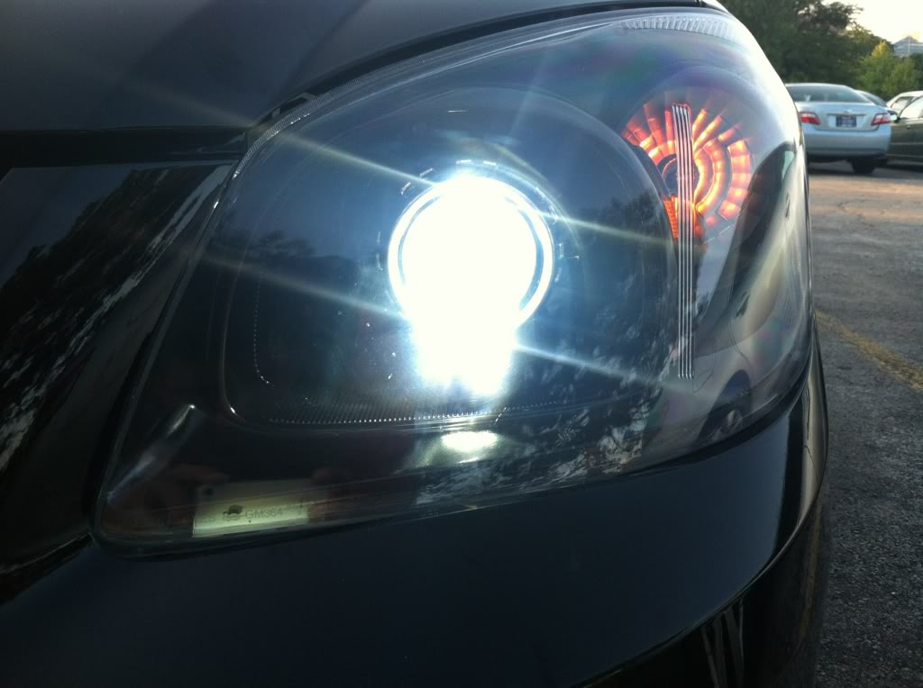

Just some pictures of the lights finished. Overall I think that they turned out pretty good. There are some slight imperfections but hey for my first set I wouldn't expect them to be perfect. I decided to go with a reflective paint that wasn't as bright as stock turn signal reflector

The biggest shourd our housisn can take is 120MM I have a 130mm G37-R Shourd..also dont get the adapters..they are still off level wise..at least mine are..ima redo them and manually align them.

Yea it's a big ass shroud! Didn't have too many problems with this one, I think it's a very good looking shroud. I'm already planning my next build. Maybe go with some real projectors out of like a Audi or something lol

oh hows your level with the adapters..I didnt relize you had finished em when I posted lol
Old Jul 25, 2012 | 11:05 PM
kdub1492's Avatar
Joined: 12-07-10
Posts: 2,766
From: Chicago
level is pretty good. I will get a couple pictures tomorrow night with the cutoff. I am pretty pleased with how they turned out overall...btw I really like those shrouds!
