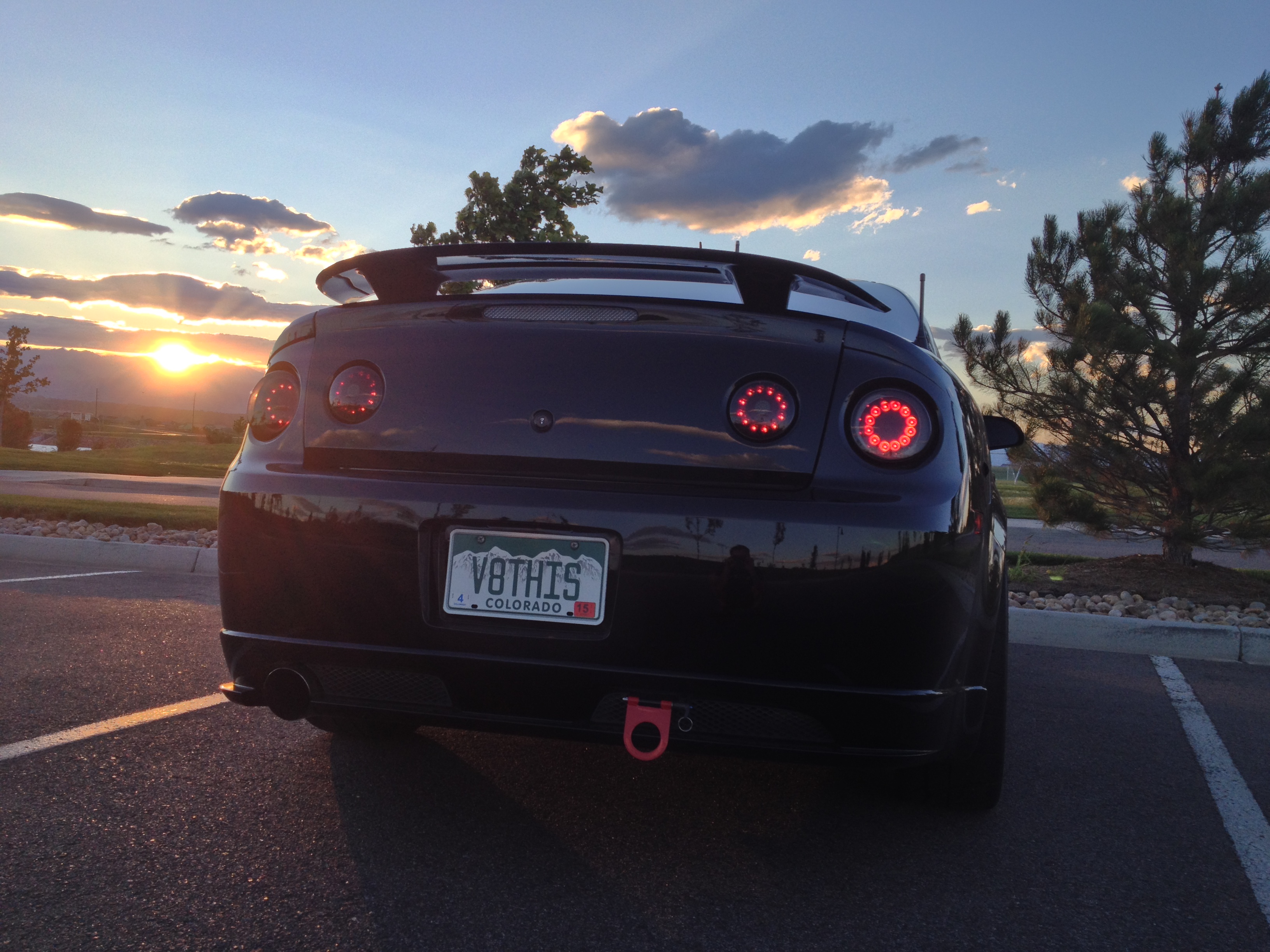

Originally Posted by nobody2u
Please get a shorty antenna.
Totally off topic, but I actually got one in the summer of 2013. You're welcome.
Proof:

The ARK one looks so much better than the MPX in my opinion.
Works great too
