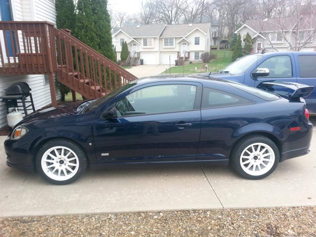

The previous owner had installed a 3" catted Megan Racing 3" downpipe, K&N air filter, and replaced the muffler with a chunk of pipe. I immediately purchased a Powell XXX bar, Team Dynamics Pro Race 1.2 17x9 +30 wheels and some 255/40/17 BFG Rivals. There was enough evidence on these forums that I was confident that this wheel/tire combination would fit without issue. The bar and wheels (only 3 days from the UK!) came right away so i got the bar installed and test fit the wheels to confirm there would not be any issues. There is over a half inch of clearance to the calipers and about a 1/4 to the "ears" of the strut, which can always be ground down without problems. Check of the picture below for caliper clearance. I also got a set of camber bolts installed and the front aligned to -2.1 camber up front.

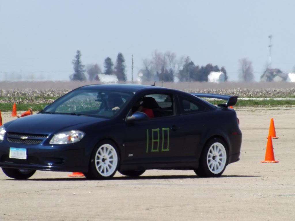

Unfortunately, my Rivals were back ordered for nearly a month, so I had to race the first event of the year on the all seasons that came on the car. This was a highly frustrating race day as the car wouldn't handle worth a damn. Despite this, I ended up 3rd of 5 in STX and 26 of 68 overall in PAX. While I would have liked to have been much higher, I really can't complain for it being the first time I raced the car and on crappy tires nonetheless. Here's a shot from the day; it appears I couldn't get much closer to that cone!

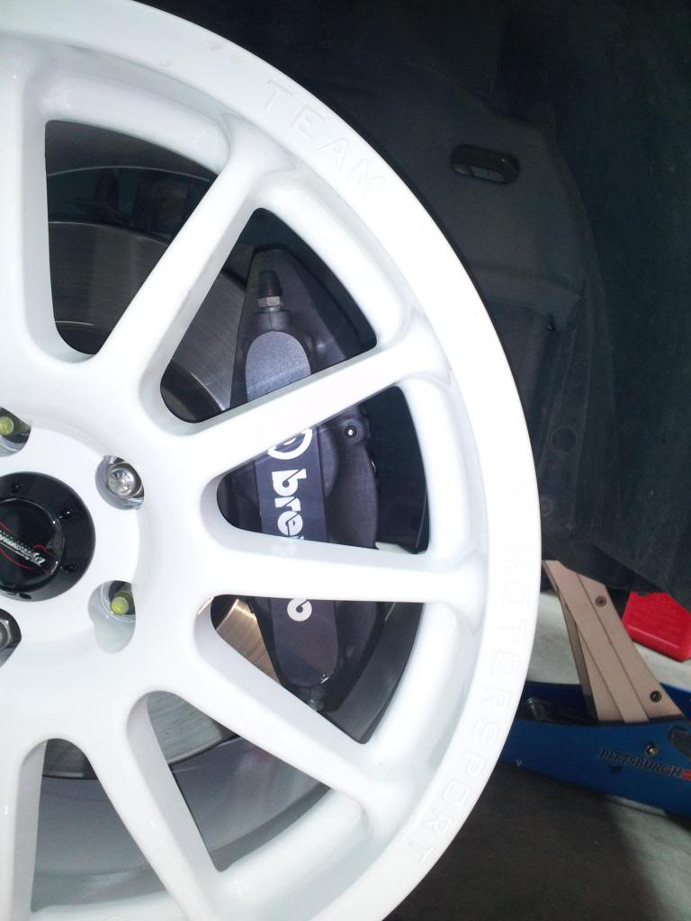

My Rivals of course showed up the following day so I got those mounted immediately and then tried them on the car. I believe the result can be described as "Mexiflush" as you can see below.
There is no clearance issues whatsoever with these wheels and tires; I have not had ANY rubbing, even after driving on the street for 15 miles or so. As I was pulling off one of the all seasons, I noticed a huge crack that had developed on the sidewall, which ran around nearly the entire circumference of the tire. I checked all the tires for this and 3 of 4 had had this occur from racing. A picture of this can be seen below. I don't know what to blame this on, other than garbage tires. You can see the wear point/shoe polish where I took care to not have any rollover while racing. This resulted in me dropping another large chunk of change on a new set of Continental DW tires for every day driving and rainy day racing.

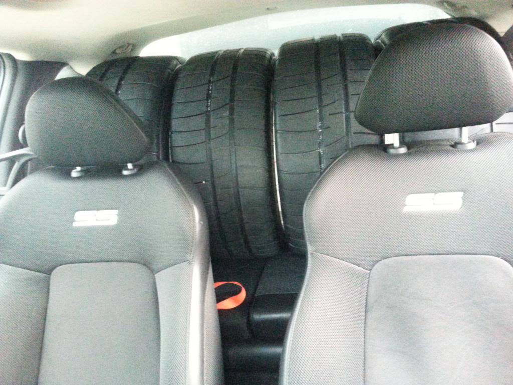

The following weekend was the next event; I'm lucky to live in the middle of three SCCA regions so I can race just about every weekend of the spring/summer/fall. I had yet to procure a hitch for the Cobalt to use my tire trailer, so I had to get creative on my tire transportation. See the picture below for the result! I was still scrubbing molding compound of the Rivals this event; they started off with disappointing amount of grip but got far better by the end of the day. I ended up 1st of 6 in STX and 7th of 44 in PAX. I was definitely still learning the car as I coned a lot and was still dropping time towards the end of the day. I have no pictures from this event, but will eventually get a video uploaded.

You are welcome on the tire transporting idea! I hooked a ratchet strap to the child seat points to ensure the tires didn't come flying forward if I had to stop on the brakes. Depending on your tire width/height, you may run into clearance issues with the roof at the C pillars. I ended up sticking pieces of cardboard up there to prevent black marks on the headliner.

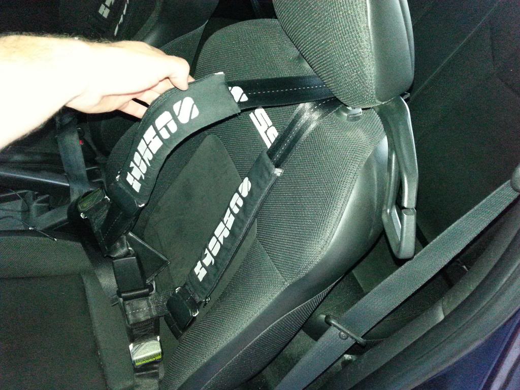

After these two events, I began to contemplate getting a harness setup for the car as the G forces were pulling me out of the driver seat on left turns. I am very tall and have to sit cocked towards the passenger side to begin with to allow my helmet to clear the roof into the sunroof area. After some research, I settled on the Scroth Rallye 4 as being the option that I would go with. Several days later, a used set showed up for sale at less than half the cost of new, so I snapped it up. These came very quickly and I was able to get them installed yet that week before the next event. The installation was very easy, although I did have to bore out the bracket that bolts to the bottom of the door frame by about 30 thousandths to fit the stock bolt. I'd say the installation took about an hour total for both harnesses. Here's a picture of the finished product.

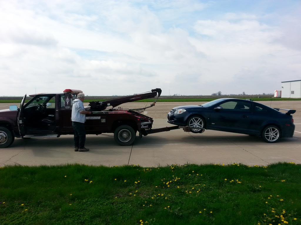

The following weekend was the next event. Attendance was quite light as the weather forecast was poor, but we ended up having good weather. I finished 2 of 6 in STX and 9th of 29 overall. My overall finish could potentially have been better, but on my last run the car shut off halfway through on a hard corner. I coasted out of the way and tried to diagnose why the car had died and would not restart. The car showed a P0087 code and 25ish psi fuel pressure on the RPD, making it appear the fuel pump had died. My racing wheels/tires and stuff came off the car and I pushed it out of the venue and called for roadside assistance. The dealership confirmed this diagnosis and a new fuel pump is being installed thanks to the powertrain warranty.
