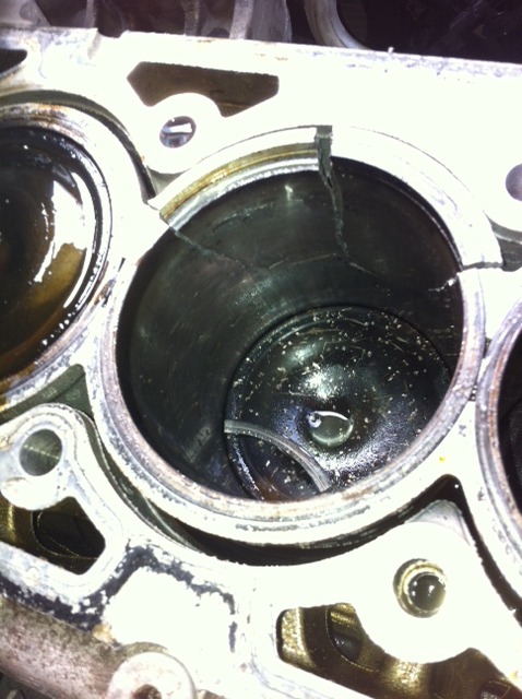

And boom goes the dynamite...
Old Oct 7, 2012 | 04:38 PM
  #4490
Garret's Avatar
Joined: 03-09-09
Posts: 2,259
From: Winnipeg
Y U NO HOLD 20+ PSI TVS
**** man that SUCKS! big build I'm guessing now

Holy ****.. What would have caused this..? Too much boost ? Tune not quite right?

I'm guessing aggressive tune not logged for cold ass weather.

My guess would be a flaw in the block casting coupled with having over 100k of wear and tear.
Old Oct 7, 2012 | 06:39 PM
  #4495
Kennyspec's Avatar
Joined: 06-20-06
Posts: 1,162
From: winnipeg
Really. Flaw in the block!?! How much hp is a stock block supposed to handle?

The tune was spot on. I wasn't knocking during it because my interceptor lights up like christmas otherwise. I guess just too much boost for the stock block.
Well from that regard... Less haha.
I mean 100k wear and tear cups easily reduce the block strength.
Old Oct 8, 2012 | 02:15 AM
  #4498
Projekt's Avatar
Joined: 06-03-07
Posts: 24,270
Yes, Putting mileage on any vehicle will wear down the internals on a motor, But Dustin cracking his sleeves has nothing to do with that. Hes not the first person to put high horse power in a LSJ and crack stock sleeves.
