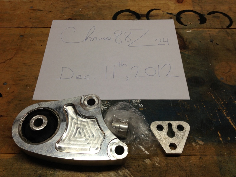

https://www.cobaltss.net/forums/part...mpener-290747/
I can now clearly see from the picture in this thread that you were sent the correct parts. As I'm sure others will confirm, that is a voided bushing and those are .5" thick spacers. I would suggest you stop lying.
it looks just like the parts u sent me and the parts u sent my friend, im guessing op must have do something wrong during the install if his didnt fit.
The picture is after I already re-sized them to the right dimension (the spacers). You fail again!

Why does your website now list replacement spacers for the mount kit?
Would it happen to do with the originals not fitting with the new bushing?
Hmm?
Failure.
You might be able to make new members look bad, but I've been on the internetz too long to be fooled. Keep trying!

if you look at under the replacement bushings listing you will see this...
"If you are upgrading from the voided bushing to the solid bushing you will need a thinner set of side spacers. These are sold seperately.""
so they probably added the spacers for the people that lost/ upgraded there bushings.

You have the aluminum center bushing with voids on the right and the thick spacers also on the right. You have the correct parts..... The bushing on the left has a steel center and is solid rubber.
Old Dec 12, 2012 | 01:00 PM
  #43
Josh@ottp's Avatar
Joined: 01-26-07
Posts: 3,286
Likes: 15
Also in the picture from a few posts up from your thread. https://www.cobaltss.net/forums/part...mpener-290747/
You said you resized the spacers. Well the thick spacers are .5" thick and the thin spacers are .3" thick. The two holes in the trans mount that bolt it to the trans are .5" wide holes. They look the same to me....

You should go back and re-measure the right parts because they were off by a half of an inch. It sounds small but it makes a huge difference when you're trying to install something that has close tolerances to begin with, such as a transmission-frame mount.
Just trying to help and save others the wasted time.

Seeing as my name is used in this thread, and OTTP did not invent or develop these mounts , I did, I will say this.
The ears on the typical Delta cradle for the front engine mount are 66.5 mm apart. The cheap really sad ex Vdub insert that OTT uses is roughly 40.8 mm wide at the center of the insert. The more expensive better made GM insert that I used initially and are still good in Blazin07SS'car in Florida, and in cars running around here, are 51.1 mm wide.
The outer diameter of the bushings is roughly the same, the cheap really sad ones are a white metal sleeve that is not truly round, and varies in diameter as the sleeve is such poor material. The GM one is steel material and is truly round and overall better made.
so you do the math, its easy to see what happened to the OP and its easy to see how he could get upset about the parts not working for him as the spacers were not correct.
I do say " thanks" to all our customers for considering or choosing genuine Powell hardcore race parts.
Now we can see the root of the problem. He has been getting his info from you. Are you really so biased that it makes you blind? Look and the pictures as anyone can and you can tell he has the right parts.
Your other comments don't even warrant a response in this thread.
