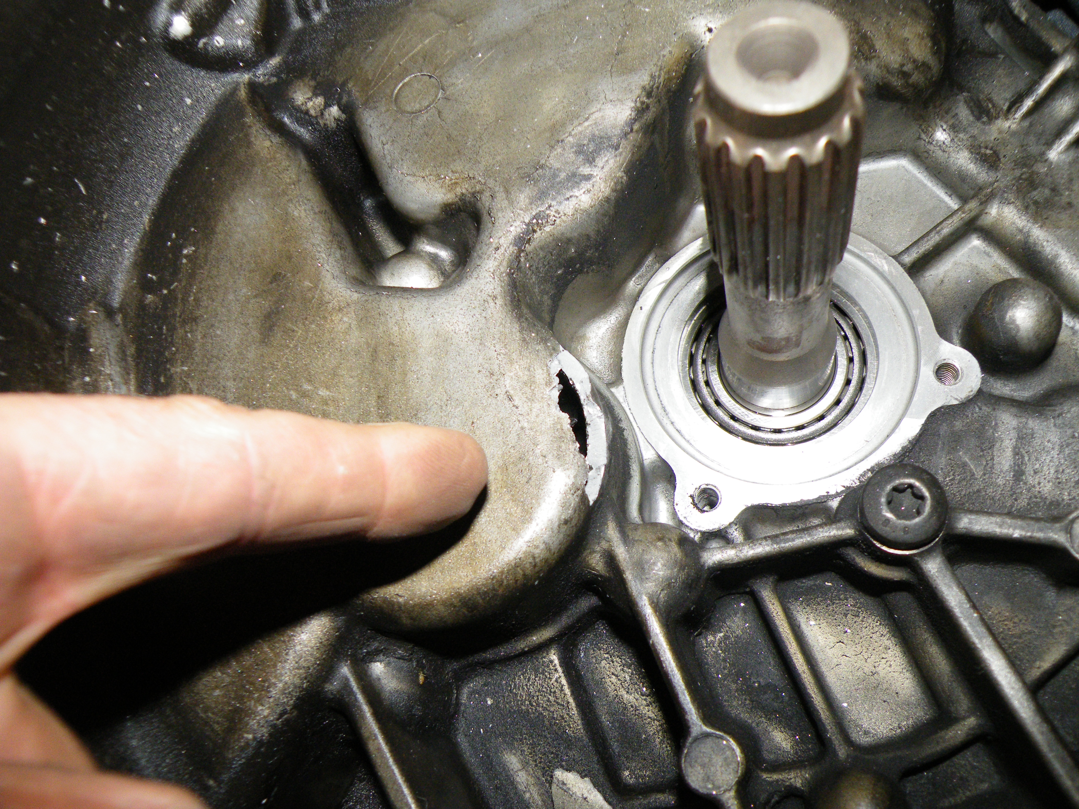

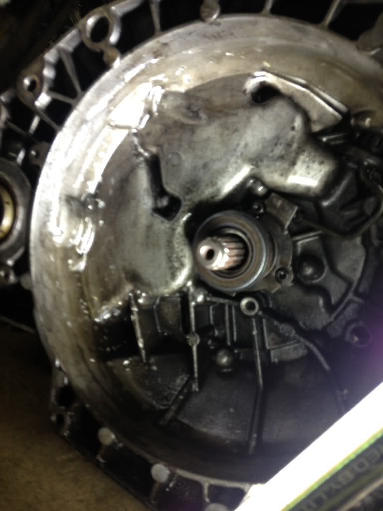

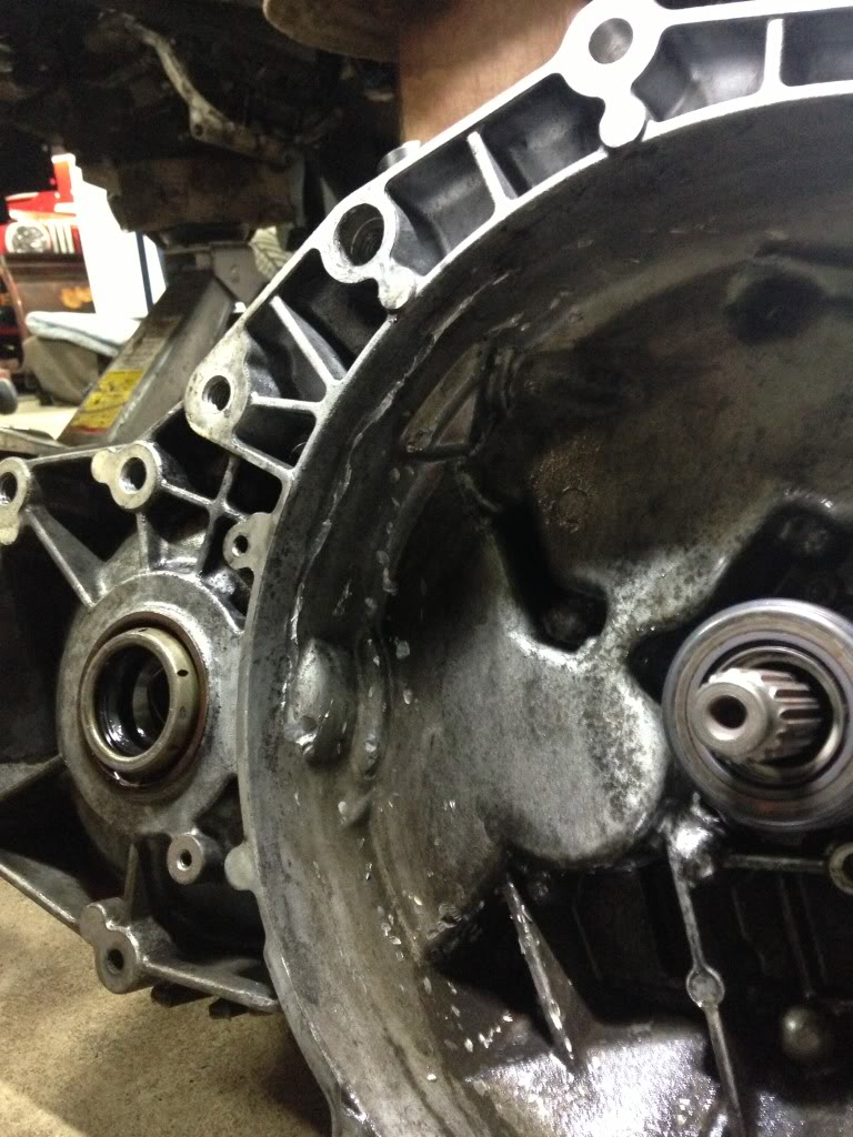

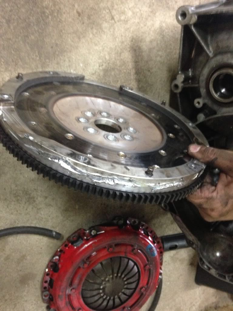

Old Aug 28, 2013 | 06:18 PM
Shane H's Avatar
Joined: 03-01-12
Posts: 220
From: Norton Shores, Michigan
Well I got the trans out and this is what I found. The case is cracked in 4 places can't really see the cracks from the pics.
The big hole is where the bolt was supposed to go most people don't even know its there. ZZP is covering the damage to the case and any internal problems. The clutch disc is fine the pressure plate has some nics in it but is still usable. The flywheel I'm going to have to grind the burrs off the damage and reuse it.

Old Aug 28, 2013 | 06:23 PM
Wert842's Avatar
Joined: 07-12-11
Posts: 4,301
Good to hear man! Glad they are taking care of it!

Old Aug 28, 2013 | 09:48 PM
Powell Race Parts's Avatar
Joined: 04-25-11
Posts: 6,128
Likes: 47
From: Port Perry
You are right. I forgot that bolt. Super that ZZP are standing up for you, they are good that way.
