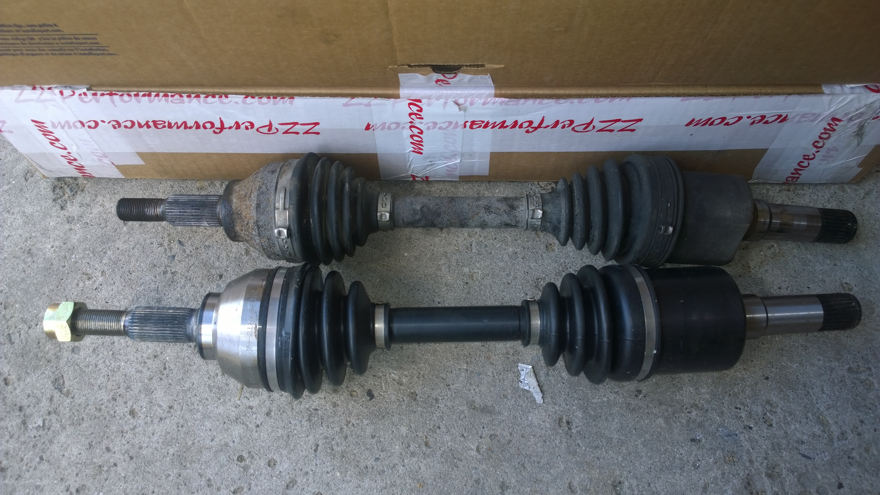

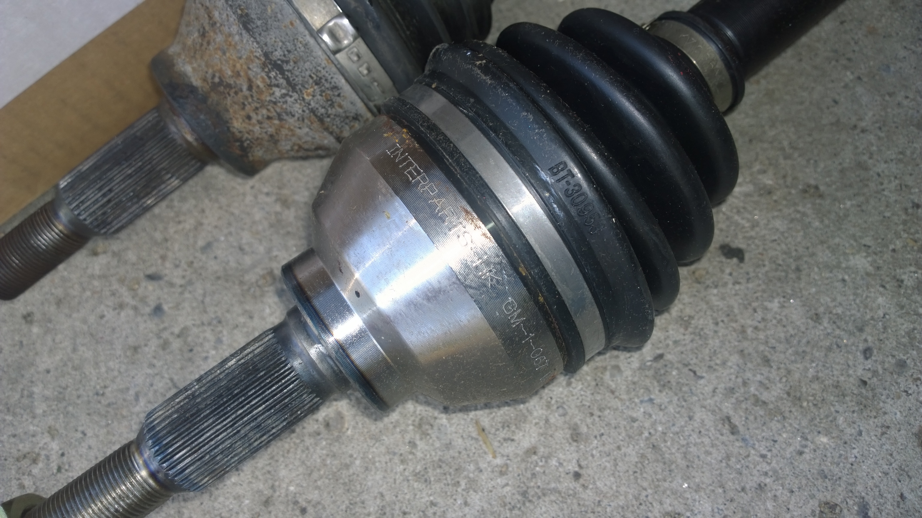

A little update on this, I ended up going with the ZPP axles because they had the axle seals on their site.
Heres a few pic of the OEM axle and the ZZP unit.
After a few hundred miles, a mix of city and highway, I haven't noticed any vibrations or wobbles. Can't comment on their strength because I haven't been to the strip, and it's getting cold so first won't hookup on the street anymore... not expecting to be able to put them through any kind of real test as I only have a header + cat right now.
Attached Thumbnails wp_20151010_14_14_05_pro.jpg   wp_20151010_14_14_12_pro.jpg   wp_20151010_14_14_18_pro.jpg   wp_20151010_14_14_38_pro.jpg   wp_20151010_14_14_46_pro.jpg

I have the same axles.... they are basically NAPA axles.
They are good axles, and I've had no issues with them.
The larger bellows in the boots will prevent future issues with splitting and leaking.
they don't look much stronger then the stock ones. same thickness it looks like??
Do they offer a good warranty with them?
The center shaft is larger, not by much, but they have updated cages, heat treated splines, and high quality grease. Not to mention the updated neoprene boots with larger bellows to resist cracking.
Depends who you buy from... I know NAPA has a free replacement warranty.
They are def an improvement over the factory LSJ axles. They are no GMPP upgrade axles, but for the price, they are great.
This, the updated boots do have larger bellows which should last longer as they would be stressed less.
