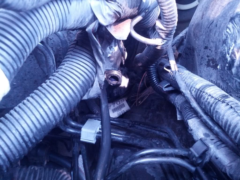

found the problem.. how do i fix it? Looks like I'm missing the clip that holds the plastic line in. Where would i find a clip like that?

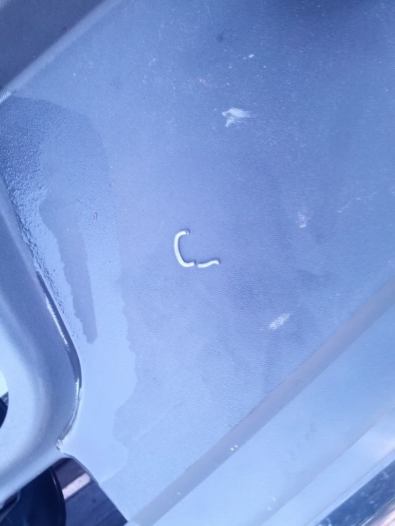

Size:  110.9 KB Found some of the clip lol

I think this is the clip i need, can someone verify this? Is this something i could get from the local parts store?
CLIP, CLU ACTR CYL PIPE 88958853

You could get a whole other master cylinder. They come with new clips. But the clip alone. No.
And btw all master cylinders for all cobalts are the same SS or not.

I ended up buying a different retaining clip and bending it to the right size. I didn't bleed the clutch but it feels fantastic and easier/smoother than it has ever been with great engagement.
