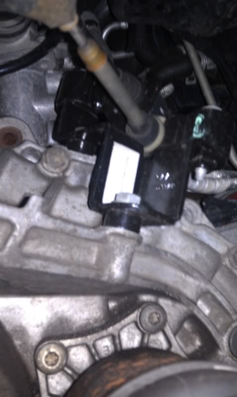

Are you guys pulling on them to release tension? Pull collar back, lift/pry up, pops out.

Here is a picture I took today of mine to better help people see what needs to be pulled and lift/pry up
