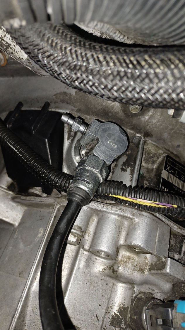

Check the clutch pipe line from the master cylinder to the elbow - I had a similar issue and luckily another member gave me the right info. I replaced it with the goodridge braided line and it's been great since (I also replaced the elbow).

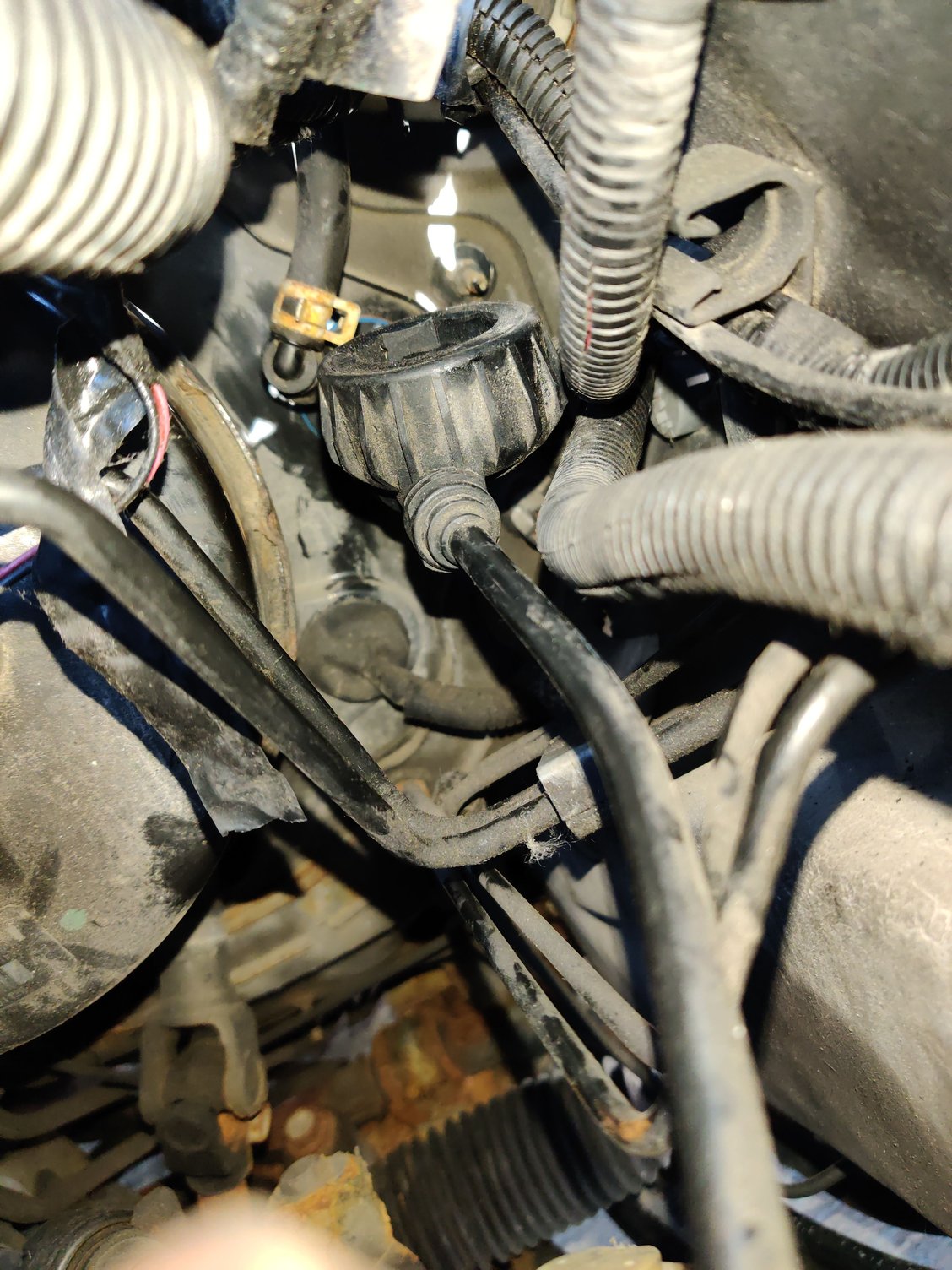

There is no "kit" really; I got the elbow from RockAuto, and the braided line from ZZP which does make a LOT of products for this platform. I think I spent $70 in parts and shipping. The o-rings I found to be fine, the seal itself around it was just expanded enough (it's a plastic line) that it was sucking in air, especially on warmer days. The line goes to the metal elbow fine, but the other plastic piece that looks like a giant knob is what the other end goes into.

This line?
Also when you mean elbow just the bleeder elbow up top of the trans? I have a new one coming if that's what you meant. I'll take a look at your pics soon can't see good on my phone.

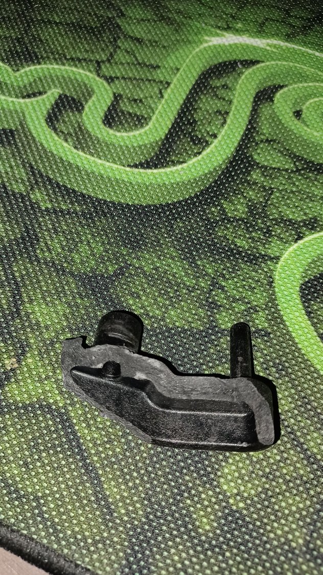

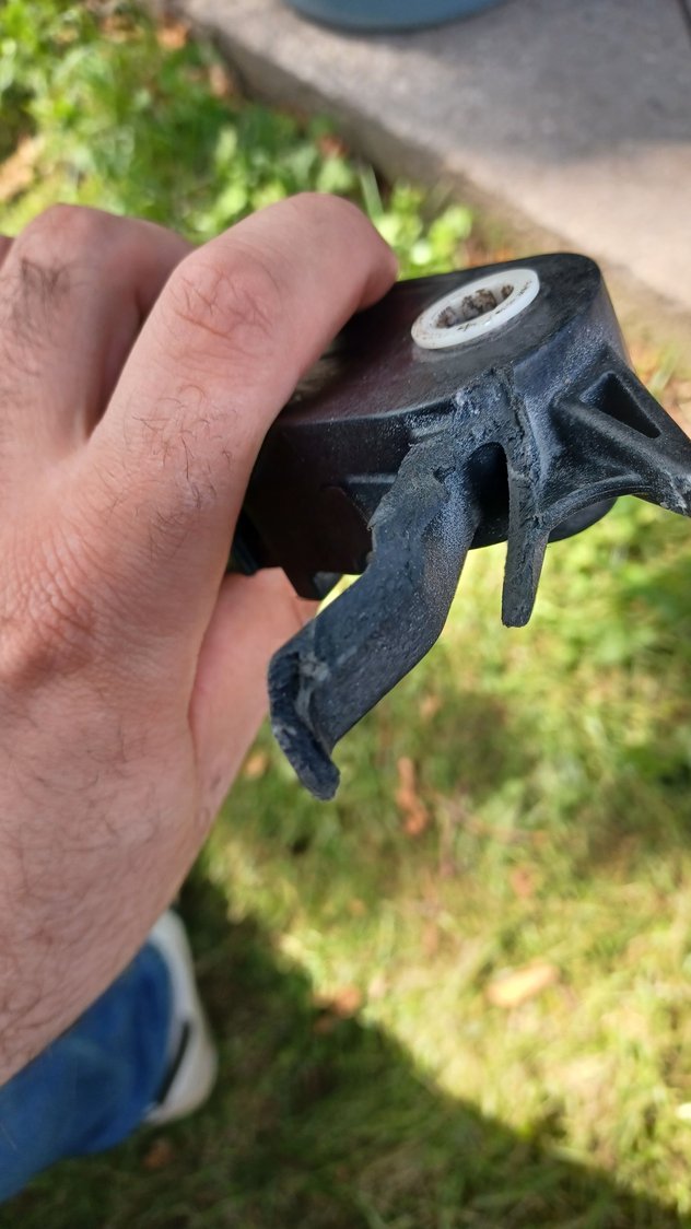

Crap I found something else that might be a issue.
The clutch pedal sensor has that black peg that is slides on and that thing is loose af. Just above it is a yellow piece that looks broken.
It's still actuating the white fork part of the switch though. I just don't know what that yellow piece is above.

Well here's maybe what the problem is. The piece from the actually pedal is snapped. It actuates the switch. Funny enough it was still actually moving it to full height even broken. I'll have to take the master out tomorrow and unbolt the assembly and see what damage there is. I must of pulled way too hard to release the white clips from the master. W t f why me lol 😆 rip

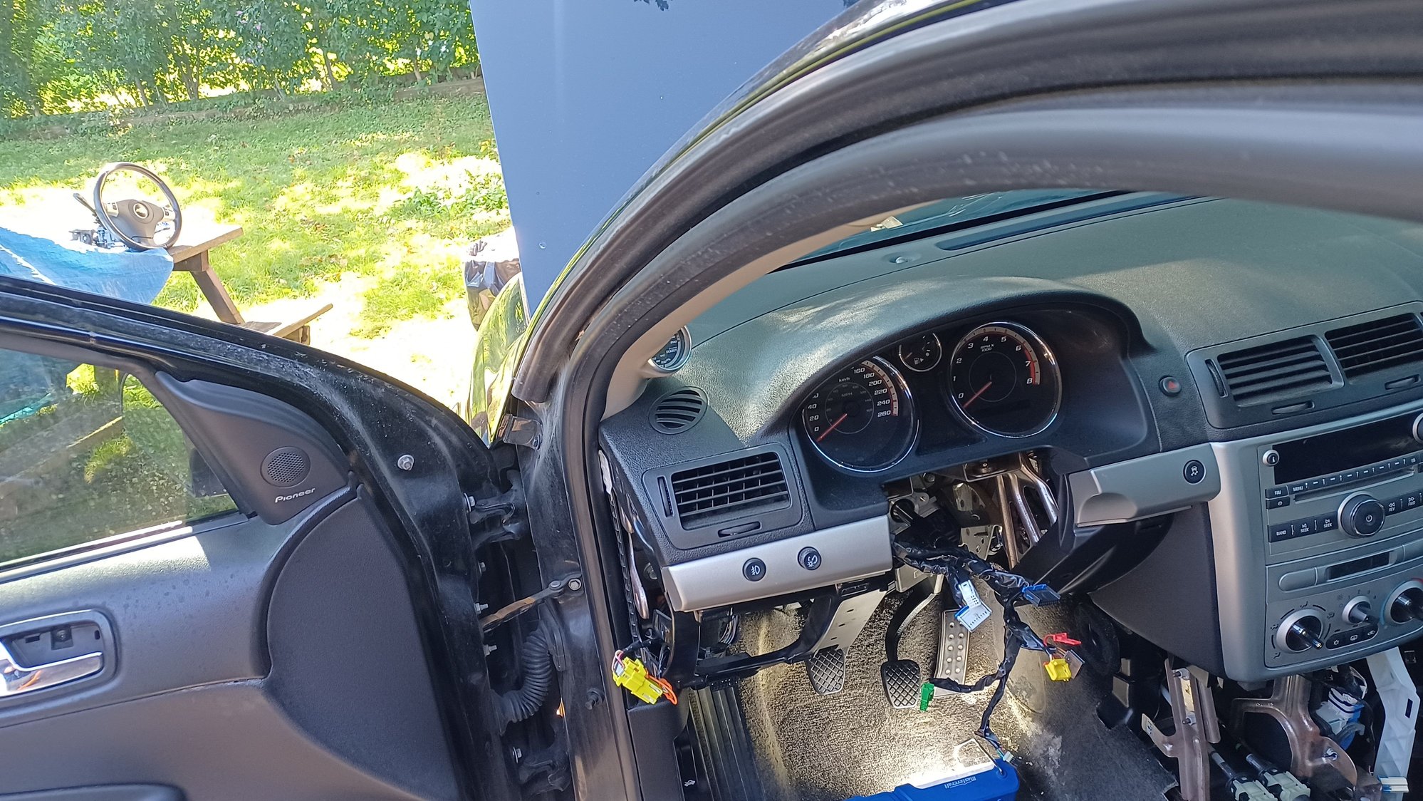

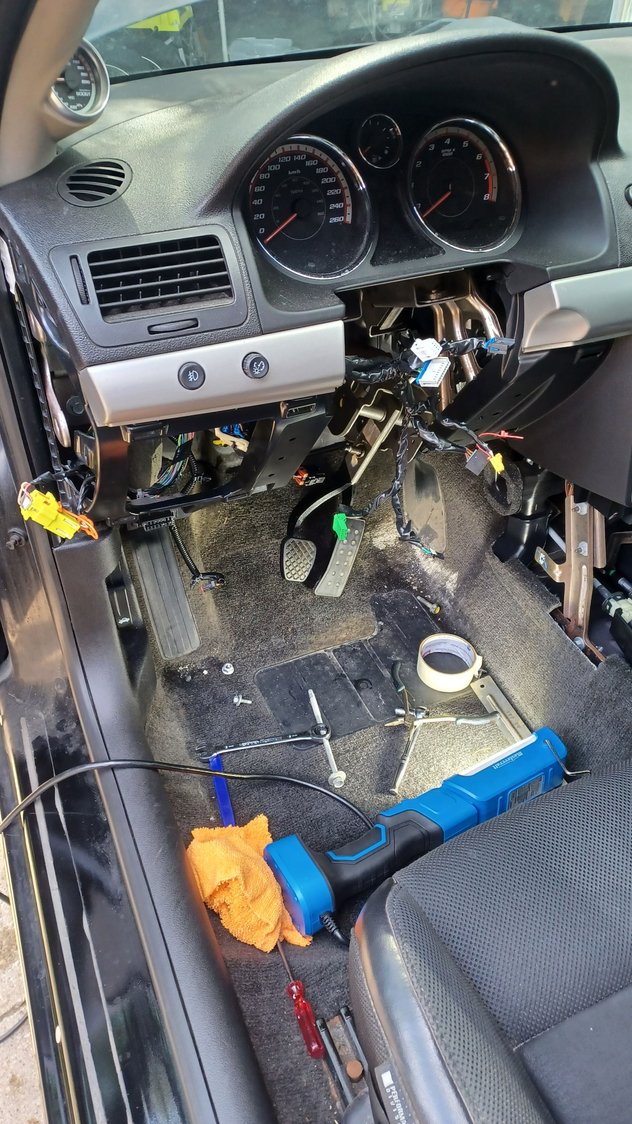

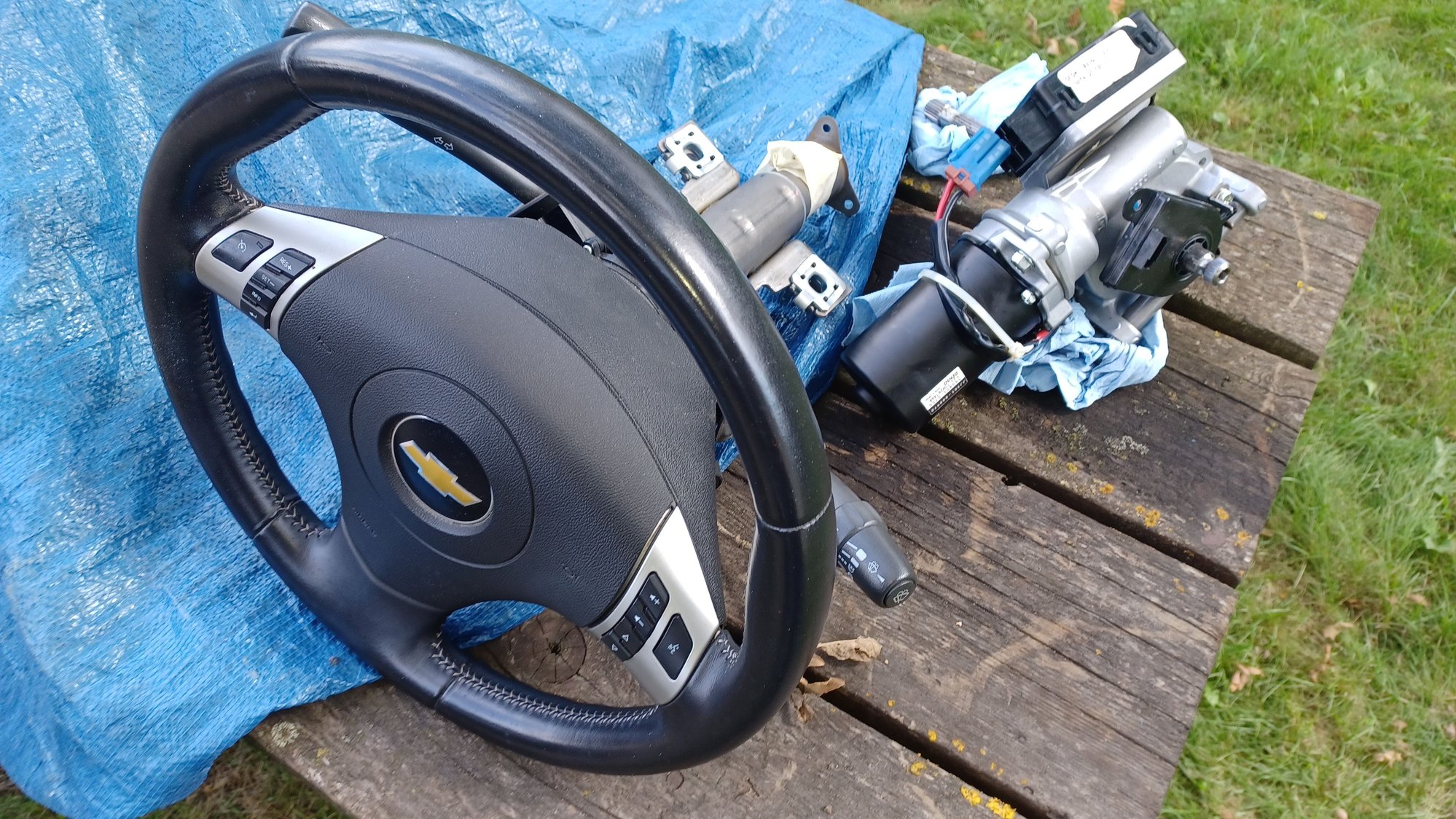

I removed the column to get to switch and remove the pedal.
The last bolt is ridiculous to get out btw I went full ape and got the dremel out.

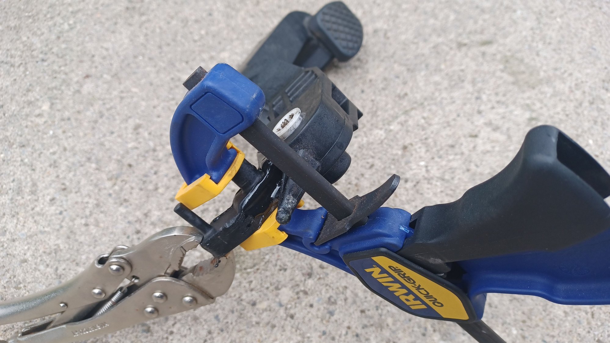

I have a new switch coming from rock auto and I use JB plastic epoxy to put the broken piece back on. It seems to have set super hard already. No other choice really I can't find that pedal.
If my car doesn't start after this I quit living lol!
The column removal actually wasn't that bad honestly. Anyone needs help removing on let me know but there's videos on youtube that are pretty good.
