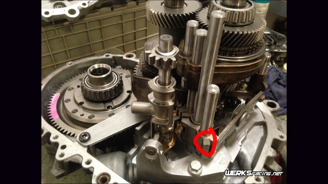

This is the spot the switch touches. That piece moves upward from where it's pictured.

Thanks for the pic. In his other thread I stated either the new switch is the culprit or it may be internal but I did not have the knowledge of how the switch was activated by the transmission. I guess reseat the switch one more time ensuring that is torqued down properly.
