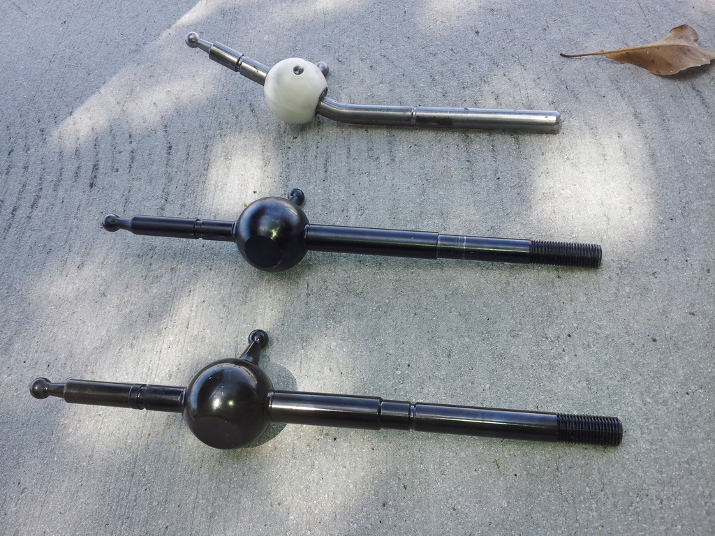

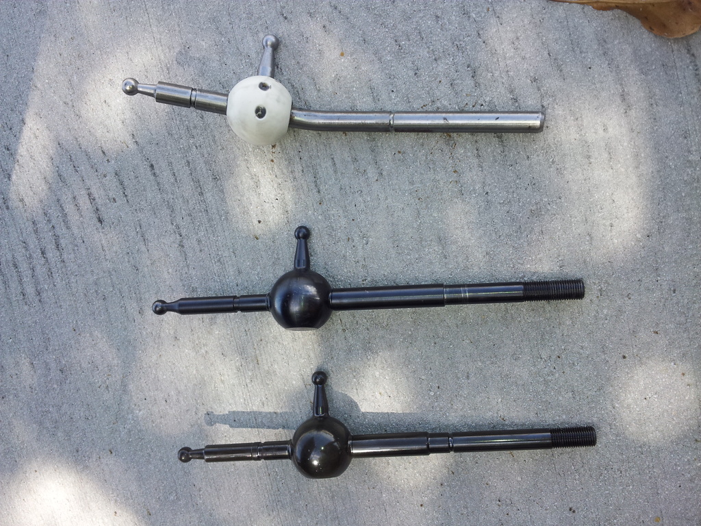

So this is my noob review on my experience between TWM short throw shifter and BPS short throw shifter
A little background, I have been using TWM for 2 years plus some days. My main concern why I wanted to try something different, is because the TWM wasn't as smooth as the stock shifter was. I would need to put more effort to put into gear.
If it was human error during installation, then I just installed BPS the wrong way too, because I followed the same instructions.
Most of us already know the main differences, and advantage and disadvantage of each ones from previous threads. I just wanted to add my personal ones
TWM
Advantage:
Knob adapter works with BPS shifter
Disadvantage:
Not as smooth as I thought going into gears
Expensive
BPS using stock shifter
Advantage:
Smoother shifting
Cheaper

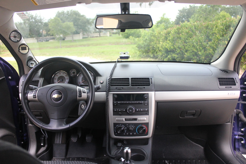

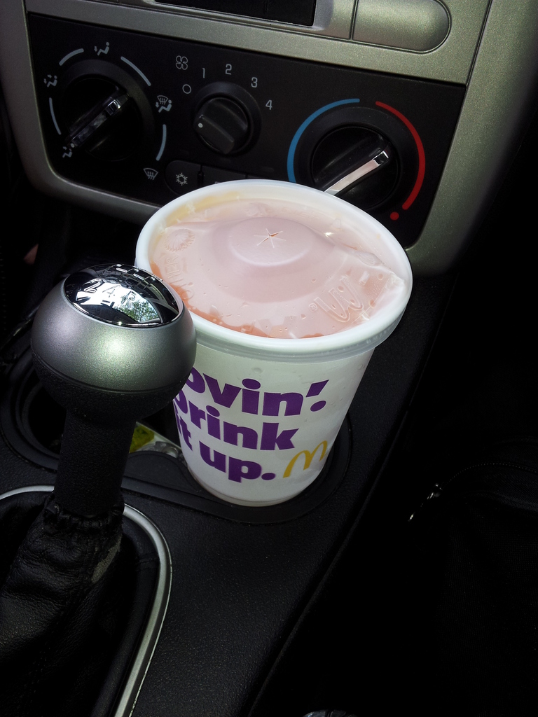

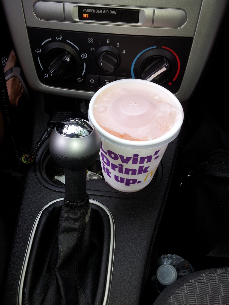

Shift knob is now level with the arm rest lol (my wrist is not twisted downwards)
Disadvantage:
Can't reach the mute bottom for the passport radar
Can't buy large sodas
Stock knob won't go lower, stays as it was stock height.
Both are about the same throw and height.
Conclusion:
For me, BPS is smoother than TWM, I don't need to put so much effort into changing gears. I don't know what was the issue or if it is defective or all of them are like that.
I might just use a weighted knob (have 2, don't ask) from TWM combined with the BPS so is low and how little more room.
I might have missed something, if I remember I will add it up.

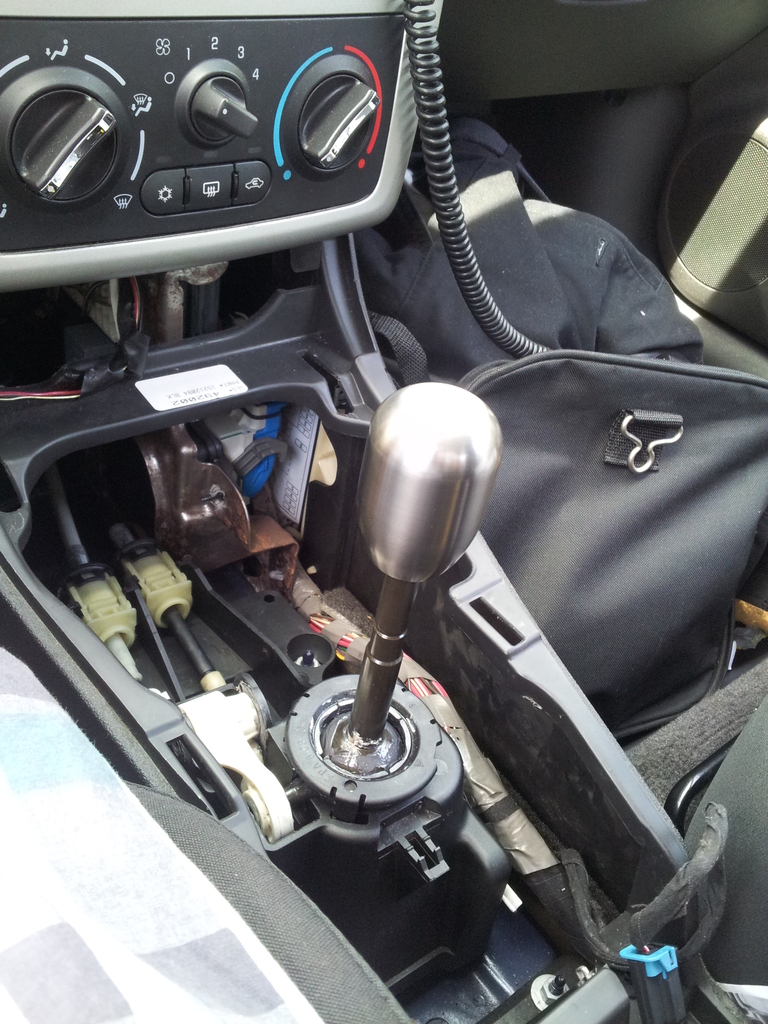

On to pictures:
you know which is which one

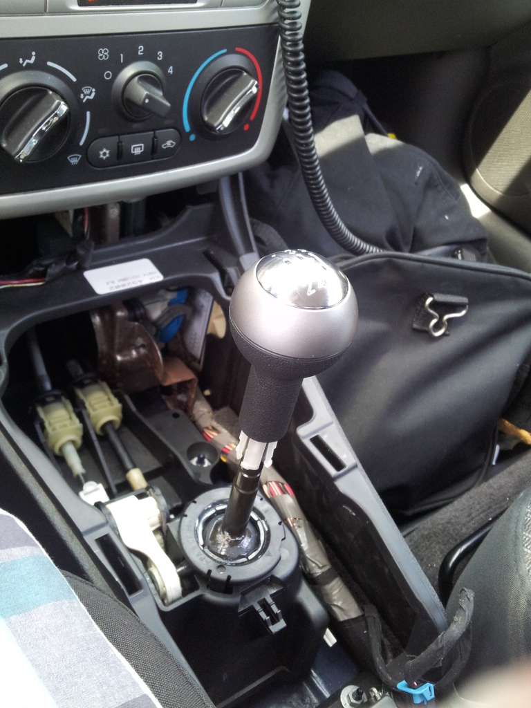

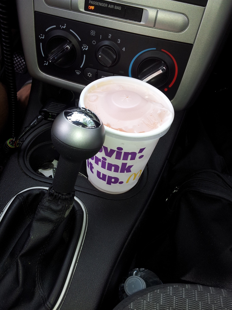

Using different knobs on BPS shifter

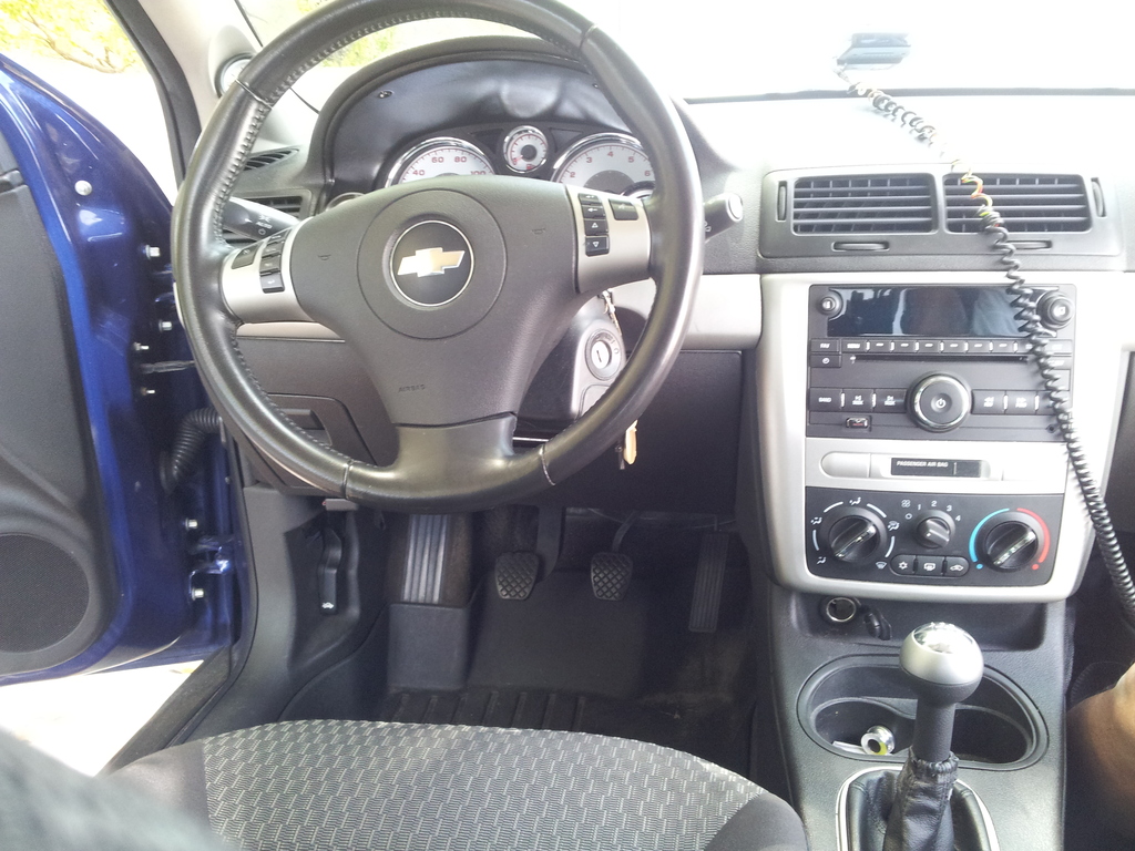

Wasn't able to recreate the picture, (different days)

I'm actually shocked you have a large cup of soda in there. Shoot if I put anything there it's gonna fly. Sometimes I have to face the coffee drinking spout forward and drive slower than normal to be safe . BPS ftw
