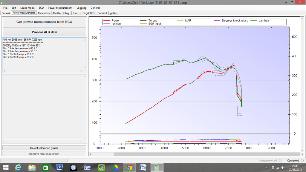

2.2 ecotec tvs 1320 harrop LS4
Old Sep 1, 2015 | 03:43 PM
Ukchilll's Avatar
Joined: 01-04-15
Posts: 98
From: Uk
Old Sep 1, 2015 | 03:54 PM
JapEatr's Avatar
South Central *********
Joined: 05-14-05
Posts: 6,148
Likes: 48
you need fuel up top in a bad way

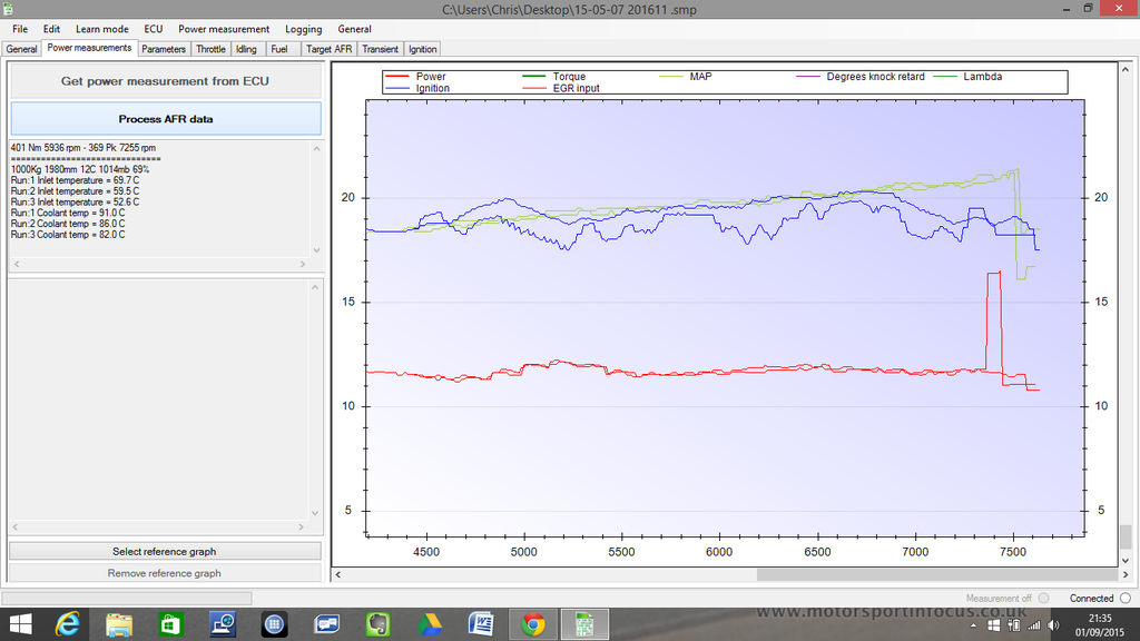

was hoping someone could pin point my issue up top
ive tried playing around with a few things to it smooth off,
do you know what afrs i should be aiming for
this is what i have

you are likely out of pump

ive tried adding fuel in the dip but it gets worse ive also played with the ignition but still not been able to get rid of the dip
my first thoughts were it was aroung the limits of the intake manifold ??
any thoughts

the car is not running lean on these runs its holding at around 11.8

more than likely camshaft/head

so your AFR is logged with Wideband?
Old Sep 1, 2015 | 04:37 PM
Ukchilll's Avatar
Joined: 01-04-15
Posts: 98
From: Uk
yep
red line here
