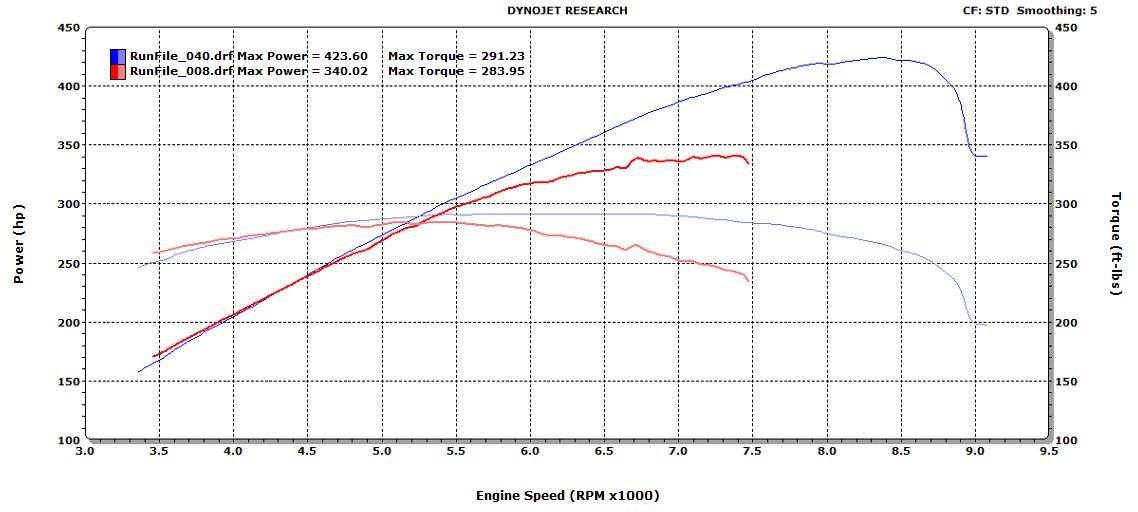

It's official! The 400whp barrier without N20 on a 2.0 LSJ has been passed!
Original Owner - 07 Cobalt SS Supercharged
Engine/Valvetrain:
- Tjolley built Forged 11:1 Compression 2.0 LSJ
- Tjolley Ported Head | ZZP Stage 3 Cams | Supertech #75 Springs
- ATI Overdrive 6.78" | Aux Chain delete | Balance shaft delete | Oil Mains deburred
Intake/Exhaust:
- OTTP 3.5" SS Cold Air Intake | LS4 Throttle Body
- OTTP 1.75" - 3" Long Tube | 3" - 2.5" Catless Mid Pipe | 2.25" Borla Catback
Power Adder:
- TVS 1320 | 2.8 Pulley
Cooling:
- Oversized Ebay Special Radiator | 160* F. Thermostat
- Stock Intake Manifold | Stock Endplate | Tjolley custom made Griffin front mount heat exchanger
- Electric Water Pump
Transmission:
- 07 HHR F23 Transaxle
Final Drive - 4.17
1st - 3.58
2nd - 2.02
3rd - 1.35
4th - 0.98
5th - 0.69
Reverse - 3.31
FUEL:
- 1200 CC FIC Injectors
- Return style | Boost reference
- AEM 320 LPH Fuel Pump
- E85
STOCK THROTTLE BODY / STOCK LSJ INTAKE (AIR BOX MOD) VS OTTP 3.5" INTAKE & LS4 Throttle Body

Minus the block of course it doesnt even seem like all too crazy of a build! Shows what you can really do without a 3 inch catback and all the cooling mods. Would it have yielded lower #s on a 3rd or 4th gear pull?
Anyway as one of the few to get 'close' to 400whp (380 here) all i can say is congrats!
Old Apr 19, 2016 | 01:08 AM
100% METH's Avatar
Joined: 01-02-10
Posts: 3,944
Likes: 15
From: Los Angeles
Awesome dude! Super happy for ya. Saw the vid yesterday and hooly **** buddy!
I did about 7 pulls, some relatively close together
The griffin holds so much water
from 3000-8000 it only rises 15-20*; then it starts climbing quickly after that.
Hits about 136-140 by 9000+. Not bad for a stock endplate

Only 294 torque? Should of just gotten an LNF.
You're funny
Old Apr 19, 2016 | 07:28 AM
Staged07SS's Avatar
Administrator
Administrator
iTrader: (25)
Joined: 12-30-07
Posts: 14,079
Likes: 197
From: NEPA
You're a moron.
Look at the torque curve.... its flat all the way through the pull.
Doesn't peak and drop like most turbo cars. Go troll somewhere else.....

Old Apr 19, 2016 | 07:38 AM
You're a moron.
I dont think he understands what a torque curve is, he just looks at peak numbers and talks about his daddy's super fast scion

Look who the real trolls are having a fat peak number is awesome and it is funny to have all that power and still not too high over stage 2 #s torque, that really is a nice graph. And who needs torque when youre pinning...
S2 torque is like 220-225 ft-lbs at best.... You to miss the point of how well that torque curve & powerband will make that car move.
All the kiddies that just look at peak numbers miss what's really going on.
VW's are making your brain shrink. Ha.
Old Apr 19, 2016 | 08:44 AM
Stage re read me bruh, I agree with you that its not all about the peak! Also agree that the curve for this car is great.
I managed 272ftlbs on 300whp and 282ftlbs at 380 lol, just found it funny is all.
