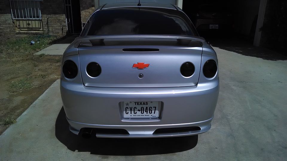

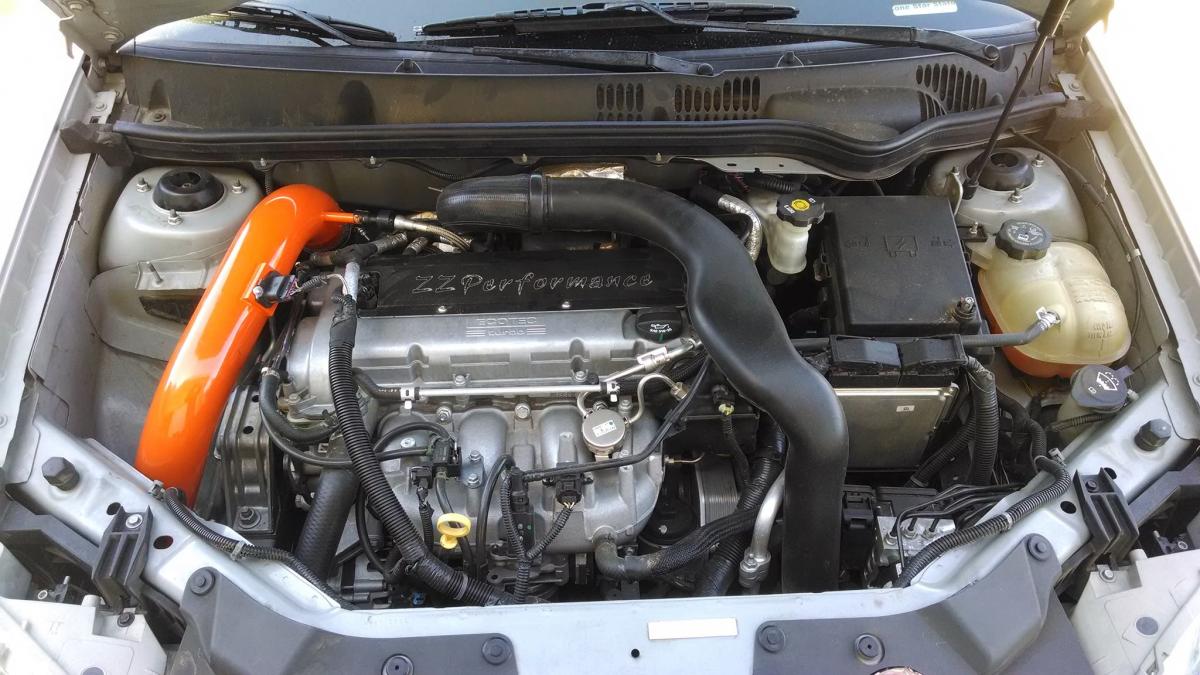

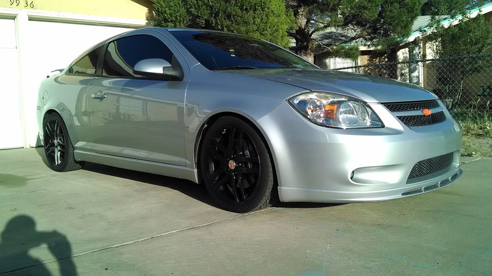

well tomorrow is the big day. looking forward to see where the car is at before I do the rest of my bolt ons and turbo swap this fall. the car is a 2009 ss with an ottp cai and catless downpipe stock turbo with a 24 psi hp tune on e47. ill post some videos and print out tomorrow.

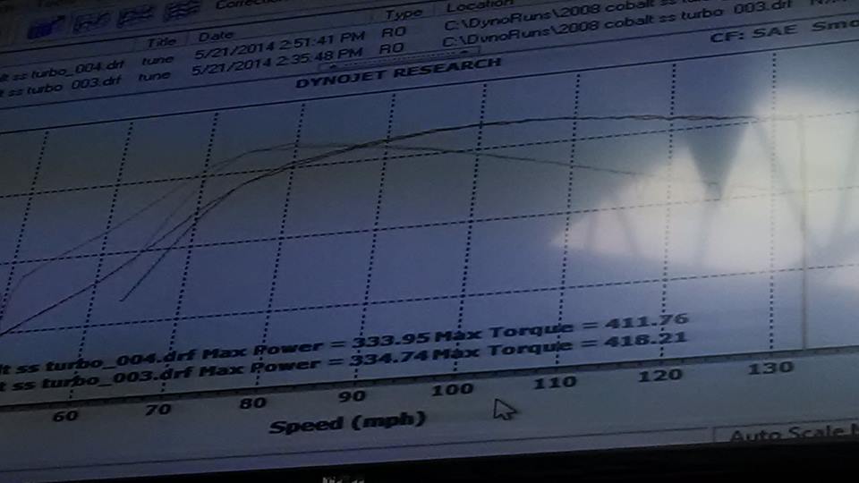

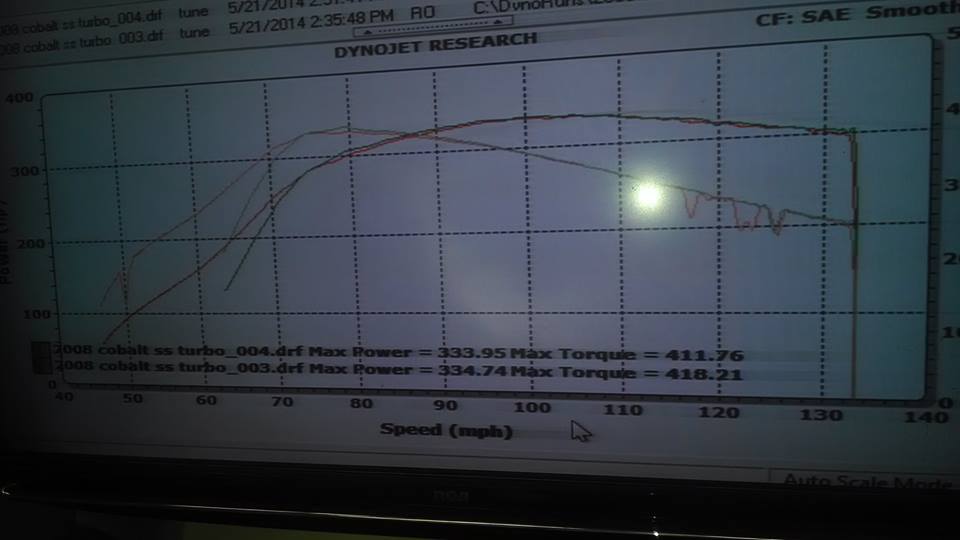

There printer was broken but I have a few pics of the graph

here is the graph

Thats a good graph. HP is nice and linear.

Holy torque batman
That's a nice looking graph your tuner should be happy

Just saw this graph, but he text me the numbers when he finished. I tuned it. I'm glad you're happy with the tune You have a solid car man, have fun in it!

Thanks man just need a clutch now she started to stink on they dyno

No problem! I'm glad you like it.
I don't see any slipping on the graphs. Those dips are his rpm pickup signal....it did the same thing on that other cobalt I tuned there. I personally setup and ran the dyno last time so I know it's not the clutch, especially since the last car I did had a STG4 clutch only making 44x tq. It's his rpm pickup
If it's not slipping on the road don't worry about it, YET.
