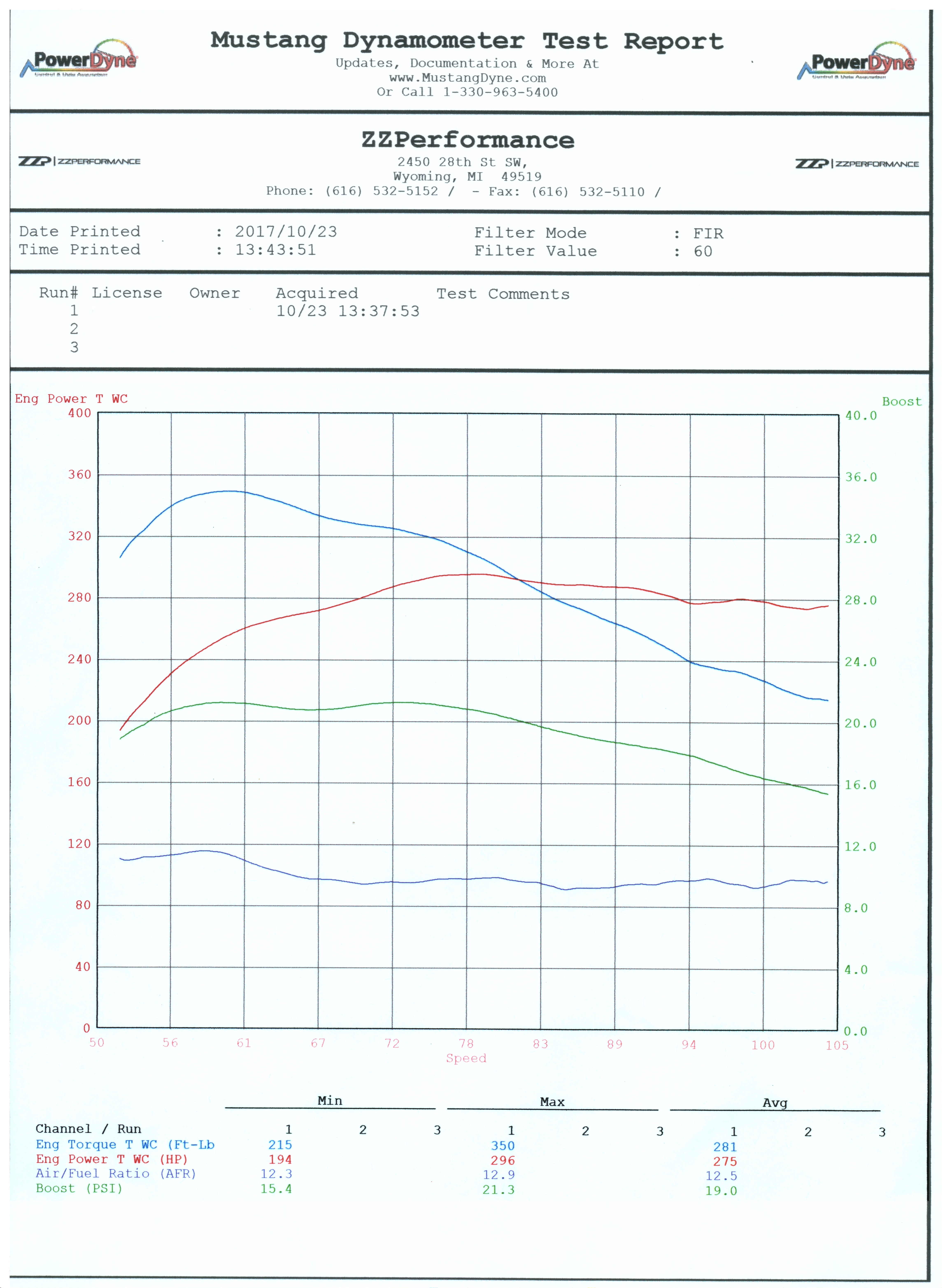

Stock Air box, ZZP catted downpipe, 95 octane,GMS1 sensors.
What do you guys think?

Very nice! 95 octane fuel though? Was that a typo or something weird?

Not too bad. What did they set your max boost at-21-22? It really dies off above what looks to be around 4500.

Whoops, yeah 93...

I dont know, they forgot to let me know when it was going back to the dyno, and I didn't get to go back and talk to the tech. Pretty incredible change from the GMS1 that was on it though.

sounds about right.

Here's my old dyno run just on GMS1, it was a 4th gear pull at the time I didn't know 3rd was closer to 1:1.

FWIW my custom tune back in the day on pump gas 91 was 320 whp 420 wtq.
however, that was dynojet and at altitude so im thinking a 20-25% correction factor so more in line with what you are seeing
