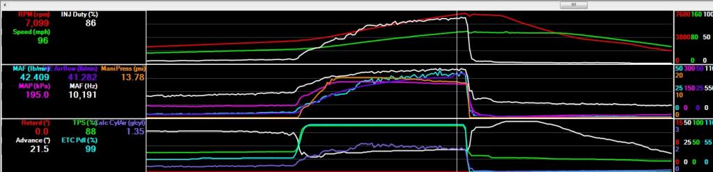

are you talking maf or ve airflow? was the LE5 maf airflow skewed way off from ve?
I'm just wondering because I'm trying to approximate the power of my car, it's pushing 33 lb/min VE but the MAF gets jumpy up top so its anywhere from 35-38

Yeah the maf seems to get a bit jumpy on these engines. I have him setup on both sd and maf tunes. I don't typically tune for just one or the other purely for safety. Plus I like to run sd for smoother idle/spark control and for mild cruising. His maf and ve are both flowing almost identically though. He's a screen shot.
