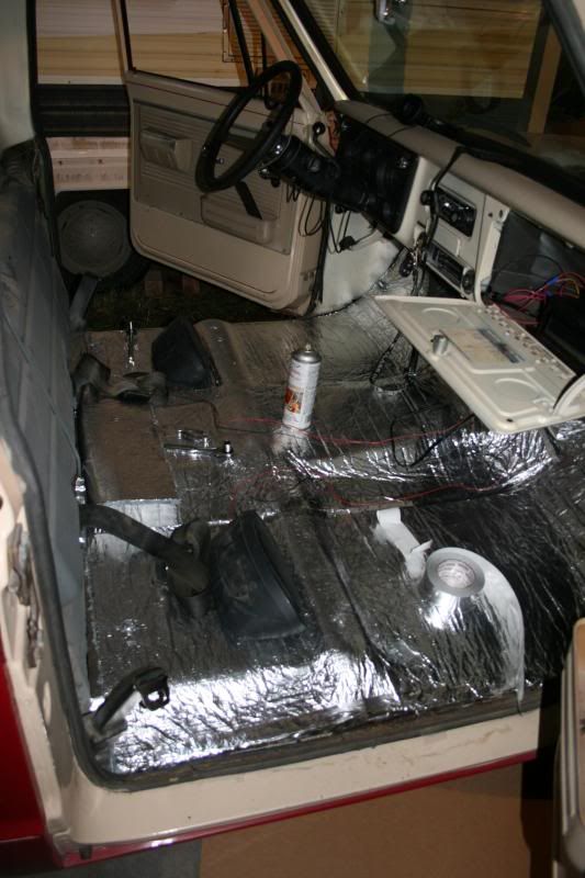

Pics-
Here's a good shot of the depth I'll have once the tank is out. It should be safe to assume the base of the seat will be no further back then the front of the tank currently sits. (make sense?)
Another shot from the other side
This pic shows the entire floor, you can kinda make out the deck in the glove box. Also shows the Second Skin.
If you want different angles I'll have to take some, I don't have any more that show much other then the dash and column (installed a new column and took several pics of it). Pretty nice set of speakers I got there too, huh? I know you're probably jealous, please try contain your envy though.
So anywho, whatcha thinkin' now?

If you look at the 3rd pic above you can see Second Skin deadener on the floors. Painted the floors with POR-15 (awesome stuff btw), then a layer of Damplifier Pro topped by a layer of Heat Wave Pro. I will hopefully get all the firewall done up along with the back of the cab after the tank is removed. Can't really do the roof as there is no headliner, just a steel roof, and that would look weird, someday I'll do a full headliner and deadener. As for the doors, that'll be a someday thing too as the only hole through to the door is just big enough to get your arm through, and I know theres probably some rust in there that needs cleaned first.
