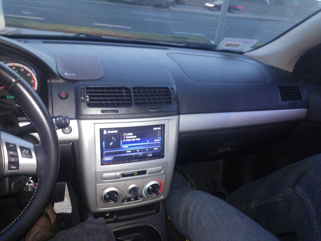

Old Nov 16, 2012 | 08:21 AM
HunterXero's Avatar
Joined: 01-09-07
Posts: 324
From: CA
i will be unable to get to the back of the unit for a few days, work is gearin up for black friday.
however, here is how the install looks.
as for the high pass filter, i did not see an option while floating through my settings. any idea in where this setting is?
i'm also wondering if i dont have my gmos output turned up enough, my half volume lvl is around 26 (of 34.) to the point where my audio is almost completely unnoticable at level 16.
should i consider raising this?
