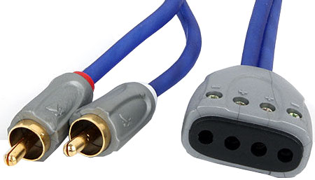

I just purchased a Sound Ordnance M1350 Mono Amp to power my JBL-GTO804 I am using to replace the factory pioneer 8" sub. Now I was told on the HHR forum I am on that I can use the Kicker 09ZISL adapter to convert the low-level speaker wires into RCA inputs to run to the amp. Now my question is will this work using just two wires since I am just running one channel for the sub correct? I can't find a wiring diagram for the HHR w/ the Pioneer stereo so I cam not sure if it's the same as the Cobalts. I was told to use the Brown and Brown/White wire for the adapter, is this the rear left?

Since the stock subwoofer looks like it has dual coils should I use all four wires in the adapter?

it is best to use all 4 wires but not necessary. The reason you want to use all 4 wires is in case a song is using stereo effects on the bass or entire song to make sure you get all the audio you should. But this is somewhat rare so you can use only 2 wires and it would work. you would just want to split them so the + and - are combined. But especially with a LOC like that kicker one might as well use all 4 wires

alot of people only use one side bc they are lazy and its easier. but what you said makes no sense. so your tapping of the stock sub thats a dual coil with 4 wires or your tapping off the stock speakers?
Well the stock sub is a dual coil so it would have the 4 wires, can I use those with the adapter to run the RCAs to the Amp? I suck at car audio.

Alright so I pulled mine apart tonight. So the 4 wires running to the sub are not coming from the amp, they go directly to the sub from the wiring harness. Should I use these 4 wires for my adapter or should I use the left and right rear speakers after they exit the amp?

use those 4 wires.

No there is no ground on the adapter it was just the 4 + - connections. The ground I have is running from the ground on the body near the battery directly to the amp.
