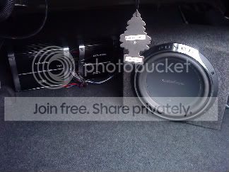

I dont want to bring up a week old dead topic but i wanted to thank all who helped and add that its all resolved now
that amp is amazing. no problem pushing that sub to its limit.
oh of course its louder but the SQ is 4x better than the clarion. Didnt think thatd be the result
