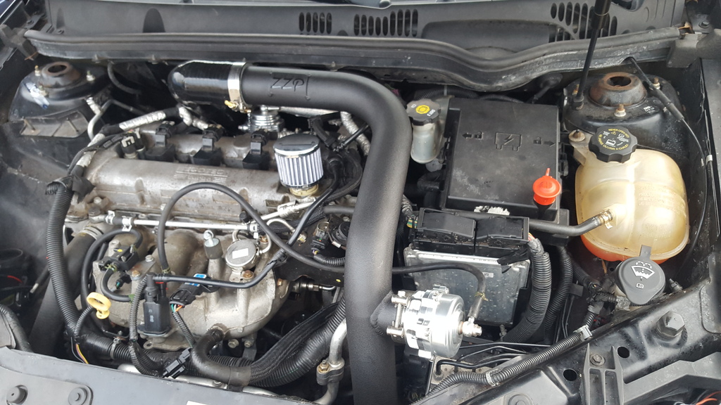

Ok so let me help you some here, as Im running a s257. I ran the stock boost controller to the side port of the wastgate, and vented the top port to air. For the BOV, which you should have with a 256 I ran a vacuum line from the intake manifold nipple to the top port on the BOV. I removed the BPV solenoid and the vacuum tank. I prefered the stock boost solenoid as it can be tuned for correct wastgate duty cycle rather then MBC where you tune around your own adjustments.

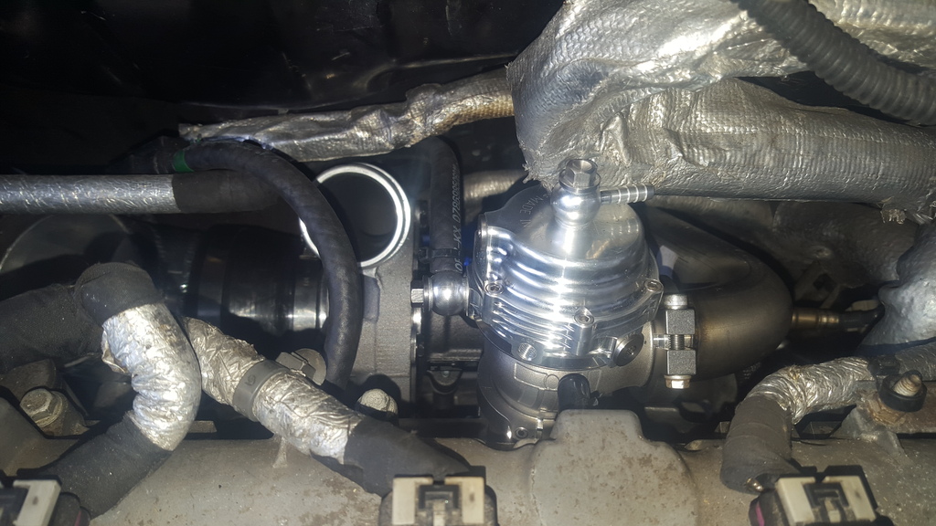

Here is my BOV hook up
And wastegate.
Old Feb 28, 2016 | 11:00 AM
06_ion2's Avatar
Joined: 12-12-06
Posts: 2,904
From: minnesota
Picture of the boost controller?
The top one is used for a electric boost controller.
Use the side port for the line and put the boost controller on that. If it's the boost controller I'm thinking of turn it all the way to the - side while blowing into the port of it, arrow on the side shows airflow.
