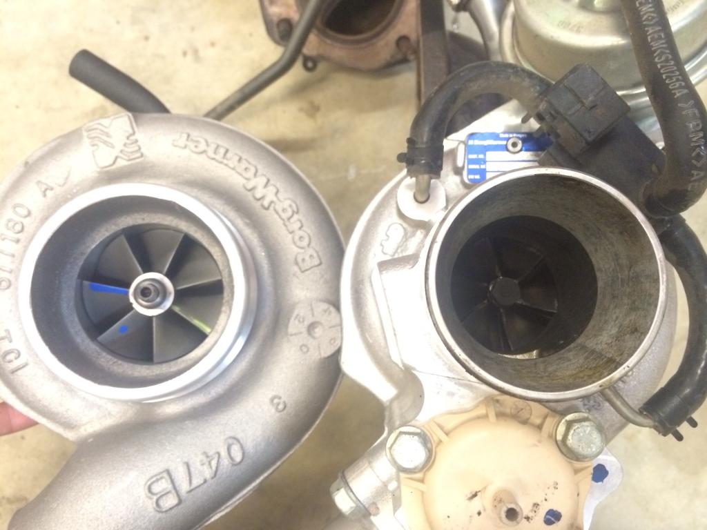

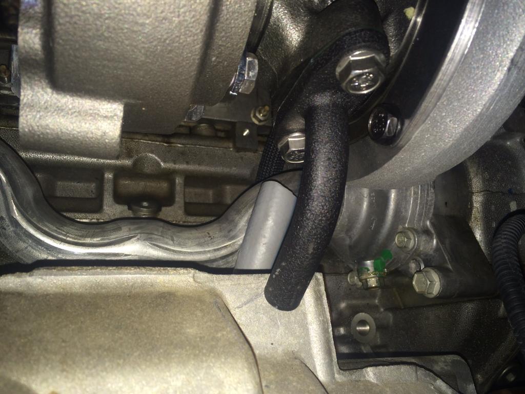

The oil drain back pipe on the bottom of the turbo and the wastegate dump tube run into the transmission. Anybody have this issue?

Can't say too many install it on the auto, engine is aligned slightly different. I'd get the parts to make a custom AN line anyways since even it it rubs on the transmission it won't really be a worry.

Matt feels maybe some wrong parts got packed. He's sending s different oil drain line and a recirculated downpipe. Quickest way to fix. Some of the best customer service I've ever gotten anywhere. Install resumes when parts arrive

Gravity, as all turbo drain back lines.

The oil drain fitting I have is straight not curved like the one you have and I have the dump tube angled lol.

Replacement is simply a longer hose with a fitting on each end. Automatic and manual transmissions are different shapes.

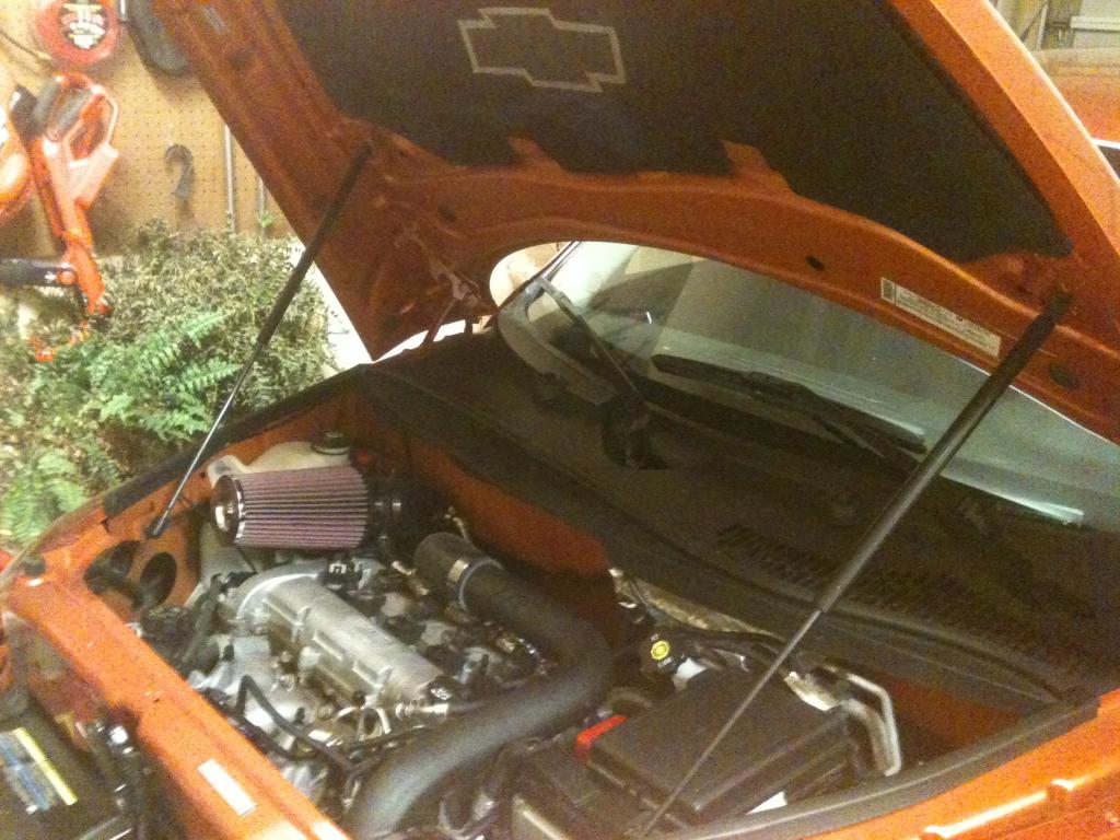

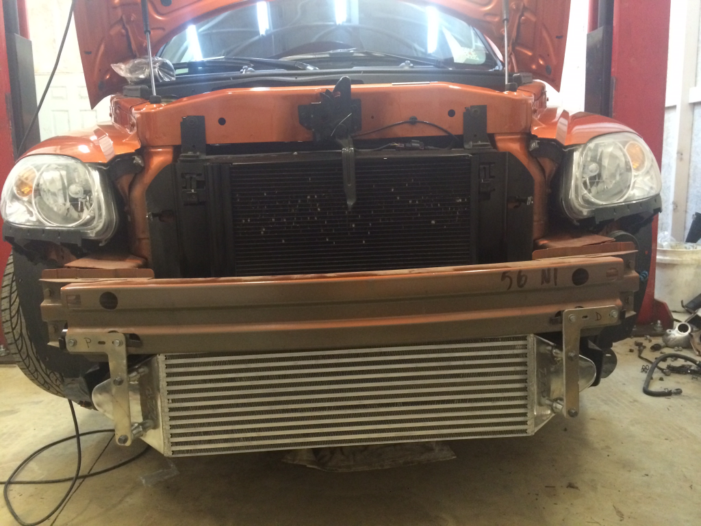

Everything installed and it runs. Driveability is poor. Tuning time, but we're having an ice storm.

Nesbit, Ms just outside of Olive Branch
Sorry for the crappy iphone pictures

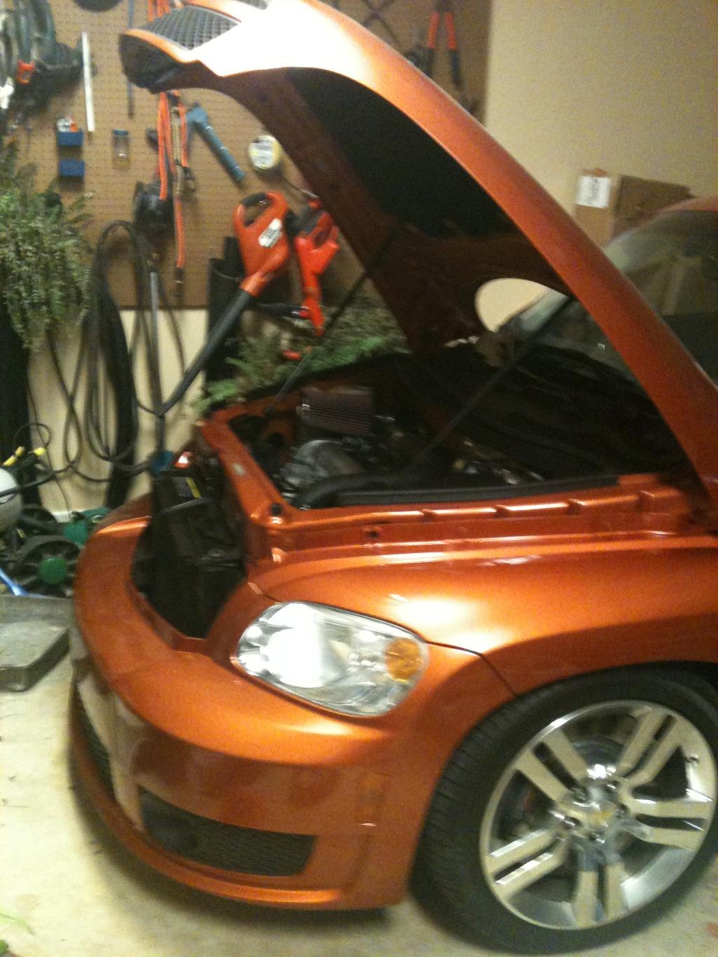

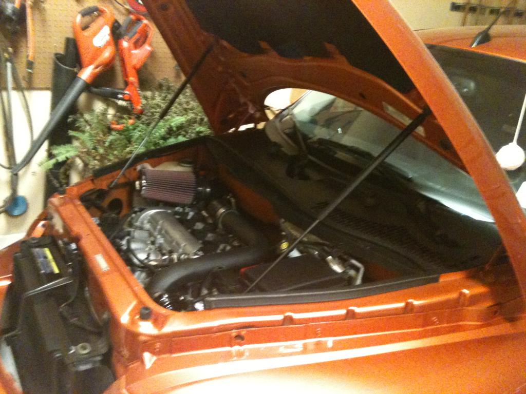

Weather just won't cooperate. Can't test drive, can't tune, just detail, detail, detail. I hope it will pay off come show season.
