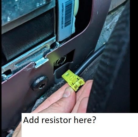

Just install a 2.2 ohm resistor between the two lines going to module that fools it and turns light off. Worked for me

Hi, Thanks for the tip but just to be clear, do I add the resistor to the yellow plug?

Yes into yyellow plug
This is the resistor. Bend like that and stick it in.

Wow. Thank you, I'll give it a try.
