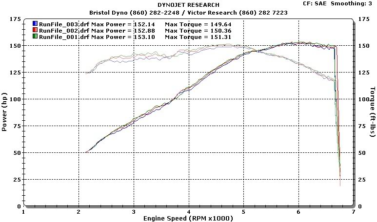

This dyno was done with just under 3000 miles on the car with it 100% stock

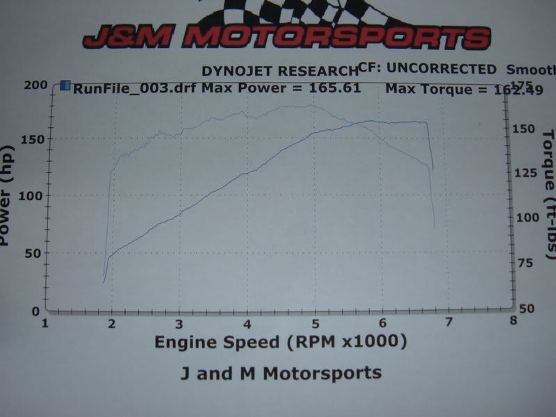

This is it with the GMPP cat back and GMPP inake with 20K on it

Last time i dynoed the car it was to see if it was true if you change to synthetic and with more miles on the motor if it changed anything. It did 171whp ad 169Torque im still looking for that slip. Now i have a trifecta tune and 86K on the car i will bring it back soon.

So you gained 13whp with an Intake and catback?

Is the intake/catback dyno run with a tune as well? Or just slapping them on?

That was just the intake and cat back that's all. No tune.

Nice. good to know that when you slap on intake/exhaust its not just a butt dyno difference lol

LOL..Those dyno pulls are on different dynos AND one is sae correction while the other is NO correction factor. Very hard to compare numbers with those differences.

Totally missed that....lol

a different place wont make that much of a difference.
