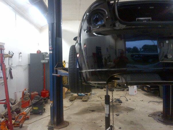

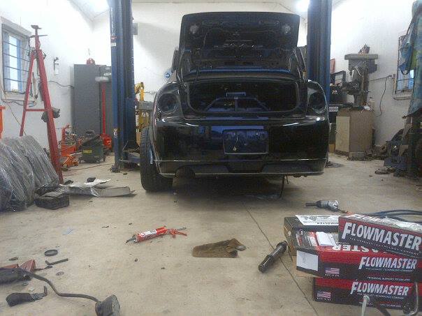

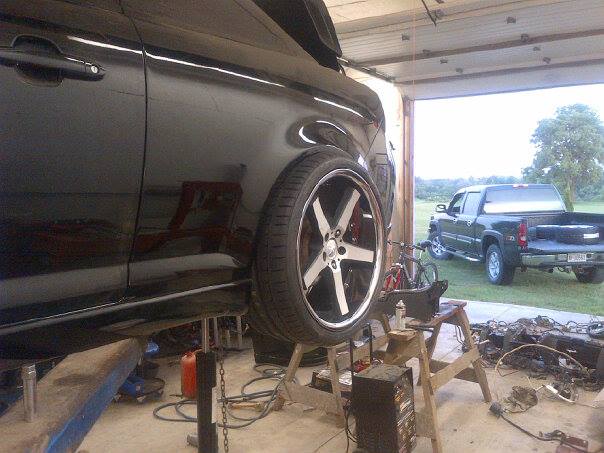

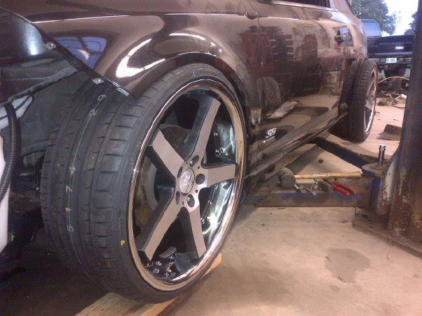

Sorry for keeping you guys in the dark the last couple weeks. I finally got my wheels... images below!
Also couple other things to report on:
1)Power steering is done and hooked up.
2)Front brakes are complete
3)Rear brakes just need fittings and they are done
4)Couldnt get the Cobalt gas pedal to work, had to fab a bracket to put the GTO pedal in.. Done none the less
5)Spark plug coil pack bracket has been modified to clear the master cylinder
6)Basically the front end is ready to be put back together
Still to do:
1)Finish Gas pedal bracket (just need to make it a bit more rigid)
2)Install air ride
3)Exhaust
4)Widen rear fenders
5)Install interior
6)EVAP system
7)Mount rear air bag struts
Almost done people~!
