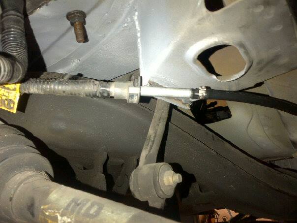

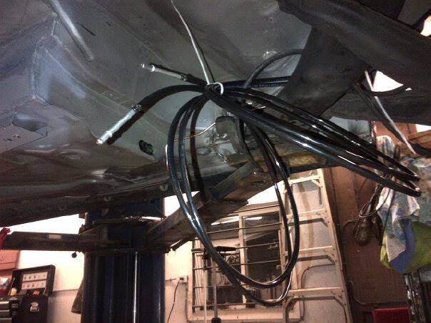

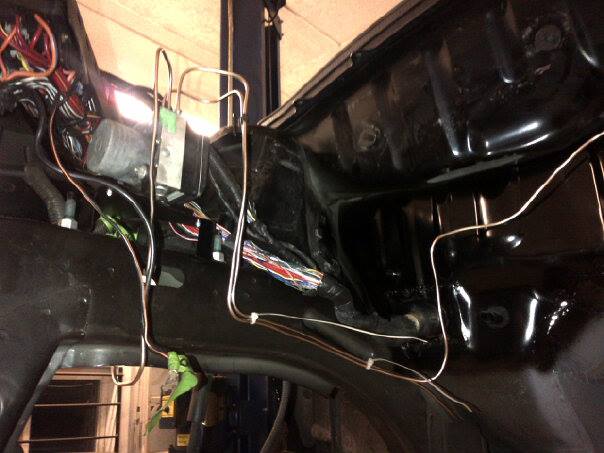

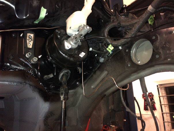

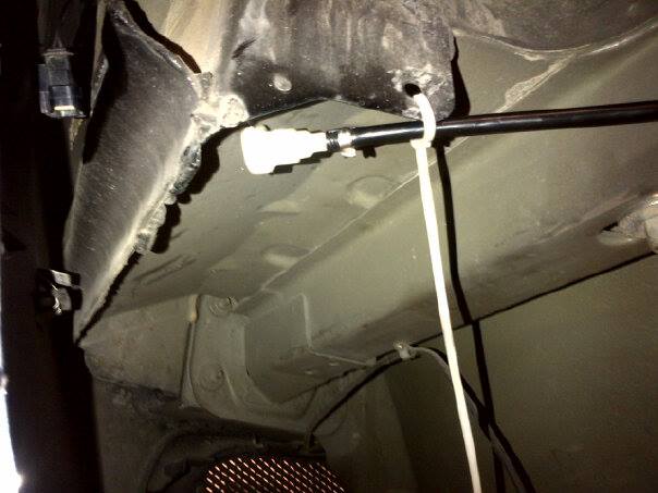

fuel lines and brake lines just about done!!
