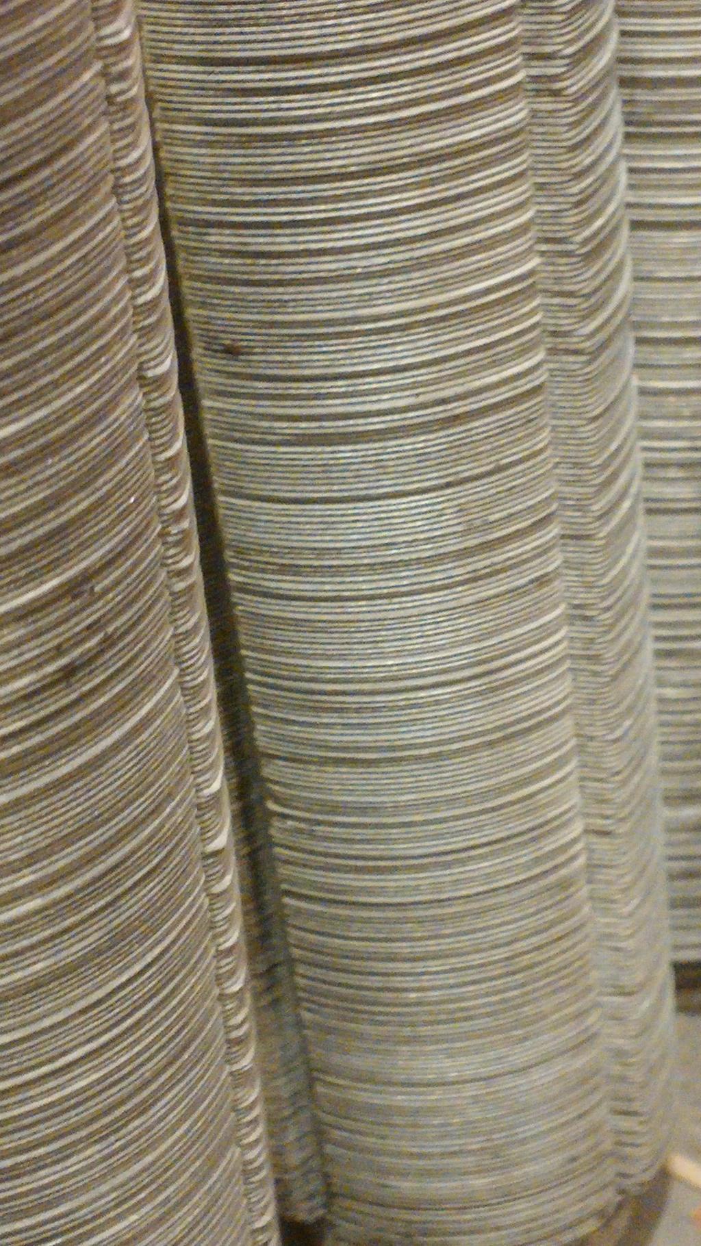

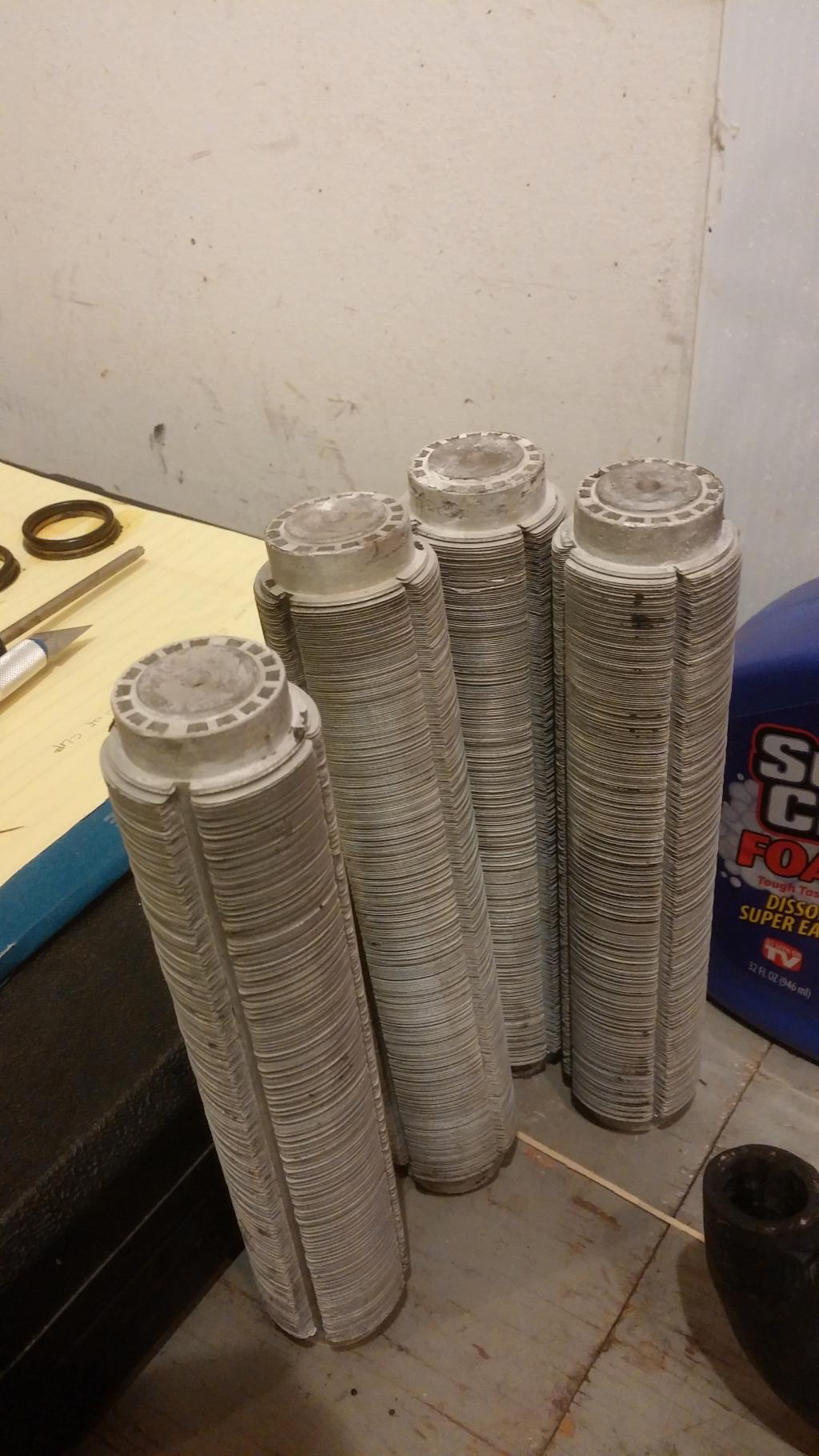

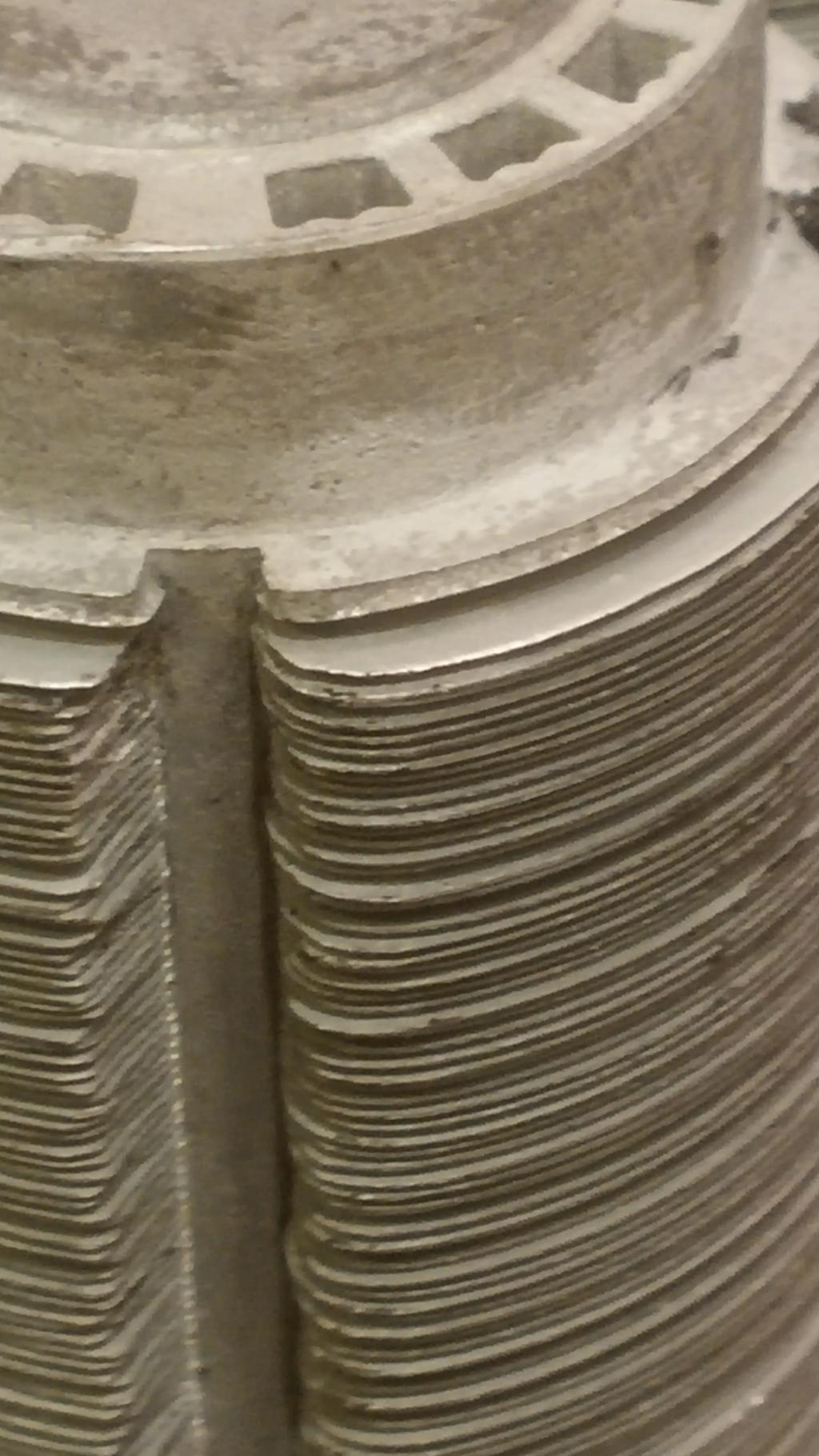

Old Dec 16, 2014 | 11:34 PM
I was using 'super clean'

hard to say exactly if its a chemical reaction that caused oxidation or if its calcium deposits, im more inclined to think calcium then anything. I would mix a 50/50 mix of CLR and scorching hot water in a bucket and let them sit for an hour. I have used CLR on the cores before and never had results like that.

Old Dec 17, 2014 | 12:11 AM
Well I'd bet he made some sodium aluminate, the main chemical agent in super clean is sodium hydroxide, and when you contact that with aluminum it can react to form sodium aluminate.
Rice did you see any bubbles in the solution?
