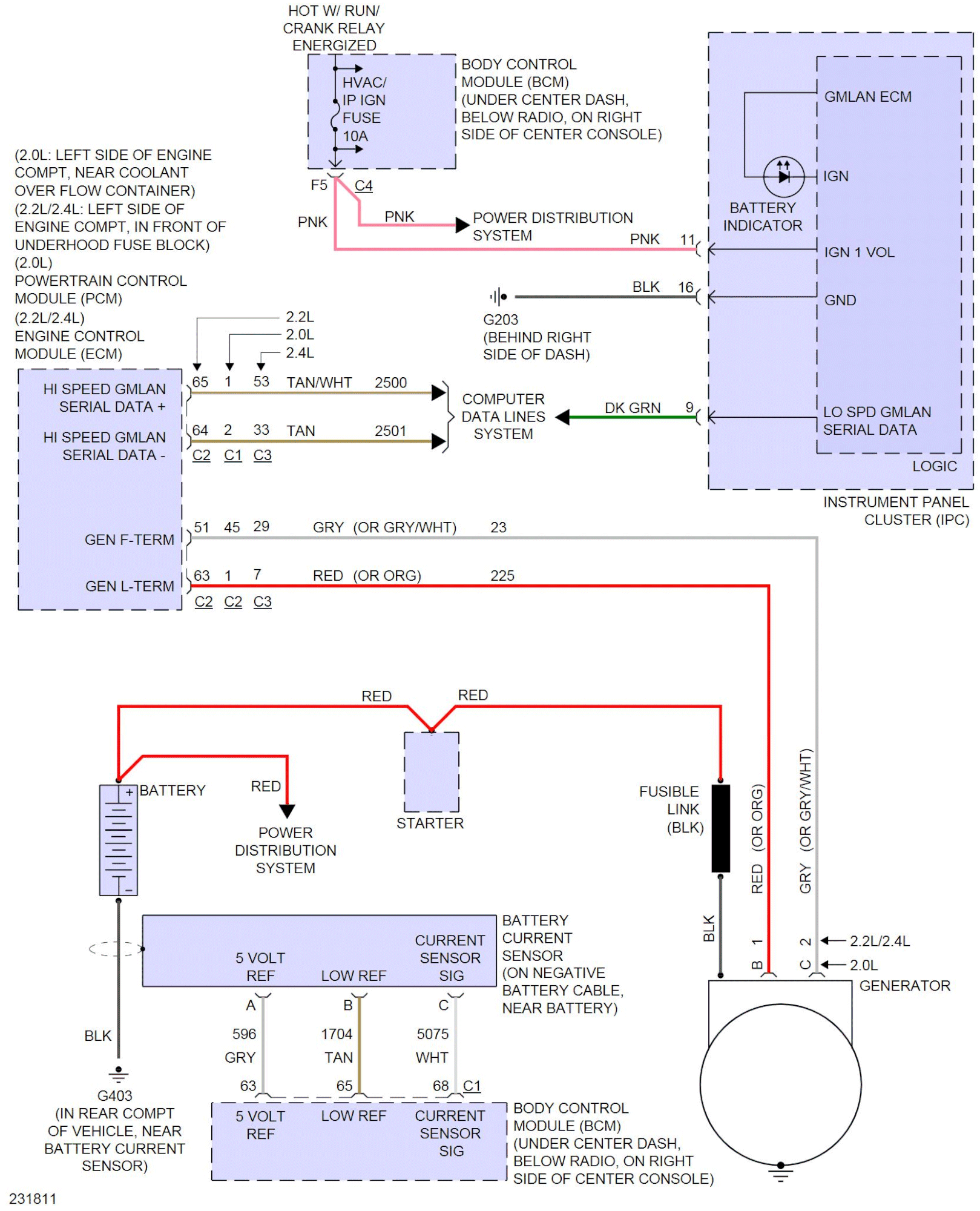

Well it wasn’t my alternator Not my battery either. So something with my wiring

I don't remember if HPT can turn the L terminal on and off and I was just in there last night setting up my fan speeds. That's what commands charging. You can take a Volt Meter to the L terminal and see if there is voltage there.
Is the battery indicator on?
Any codes?
The alternator has a great ground just by bolting it up.
As you probably know, the alt. Battery terminal connects to the starter battery terminal.

No the battery light isn’t on. Just check charge system. We have tested wires. But we have extra harnesses from another car so going to just change them and see. Changing the wire from the alternator to starter and the one that goes to the trunk to the battery. I think something may be grounding out. Like a wire. We were driving home last night and my headlights turned off and back on again and looked at my gauge and voltage was low again.

What kind of battery are you running and is it good. CS alternators do not like sulfated batteries.
Make sure when you were working on the pump that the current sensor wires on the ground cable weren't damaged.

Let us know what you find... Hopefully the PCM didn't **** the bed.
I checked last night... You can turn the L line off and on in HPT.
