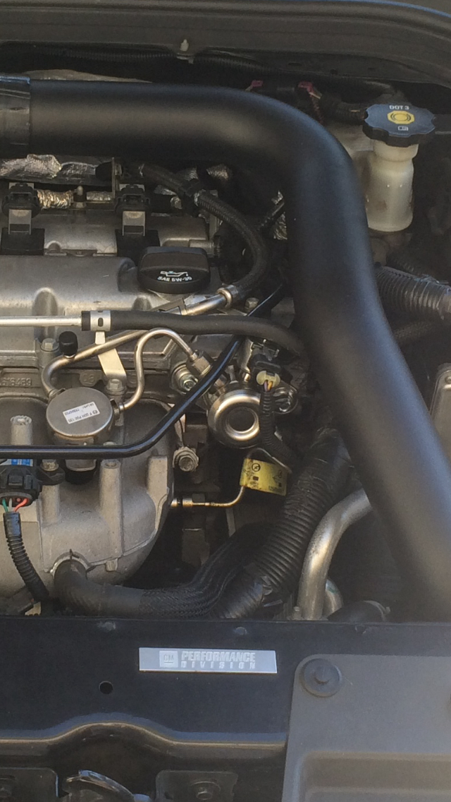

In my photo the circle looking thing above the yellow tag next to the charge pipe with the plug going into it is the HPFP. They usually have a black foam covering over them held on by a black metal plate.

And I believe the torque spec for the 2 bolts is 10ft lbs of torque

I had these codes and ENG PWR Reduced.
The giant wire loom that is running to the right of the hpfp had come undone and was rubbing wires on the Hpfp. I put the loom back over the wires and then put a piece of foam around it to keep it from rubbing on the frame of the fuel pump. This was reported by several people.
If that doesn't fix this issue, then hpfp is probably next.

Right where my finger is the wire loom to the right will rub on the metal frame and the left. When i do oil changes the wire loom will move a little and start the headache over.
With that said, this may not be your issue but please check it before moving to replace pump.
