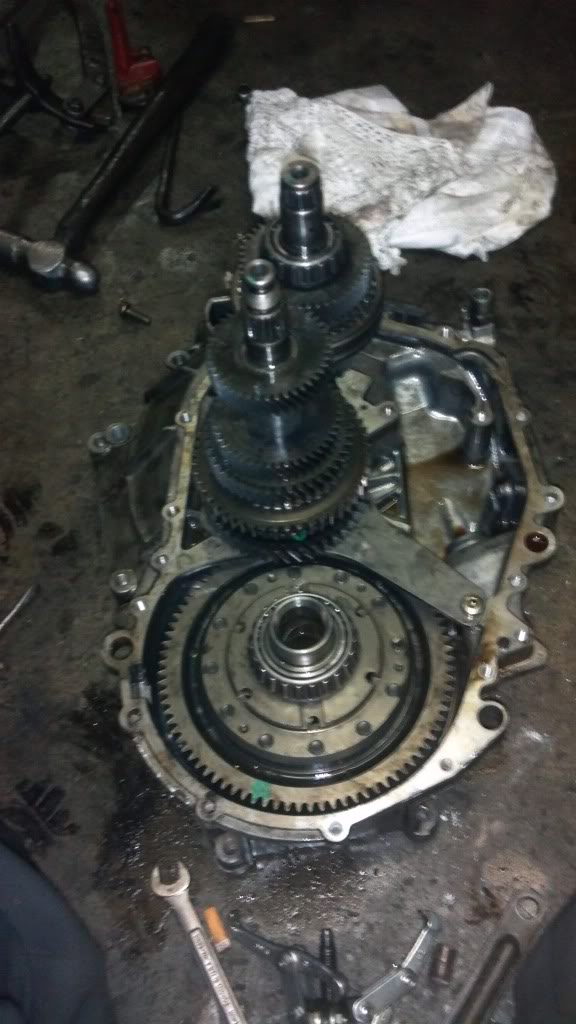

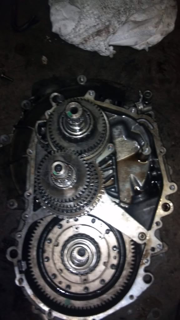

So my balt has been down for about a month now. I had a problem with my diff going out. Luckly i was able to find the problem and fix it befor it blew my case to pieces. I was able to find a lnf g85 trans with a blown 3rd gear on here. The member sold me the trans for 300$ shipped. I cracked the case open pulled the lsd out. Then installed it in my lsj trans. I used a new crush sleeve and new diff bearings. After 60$ for a crush sleeve 300$ for the blown trans 60$ in fluid and 40$you in bearings. I only have 460$ in my lsd swap as i did all the work my self. Spent 4 hours today putting the trans back in and every thing works amazing even better than befor. Im a verry excited balt owner right now.

Its really not as hard as most people think. The hardest part was trying to line the shifters back up with the forks wile putting the case back together.

Thats why you lay every thing in exact order as you come out with it then there is no mix up just assemble in the order you remove. I had the gear pullers already to disasemble it. The case puller i made my self. Biggest thing to remember is to install a new crush sleeve.
