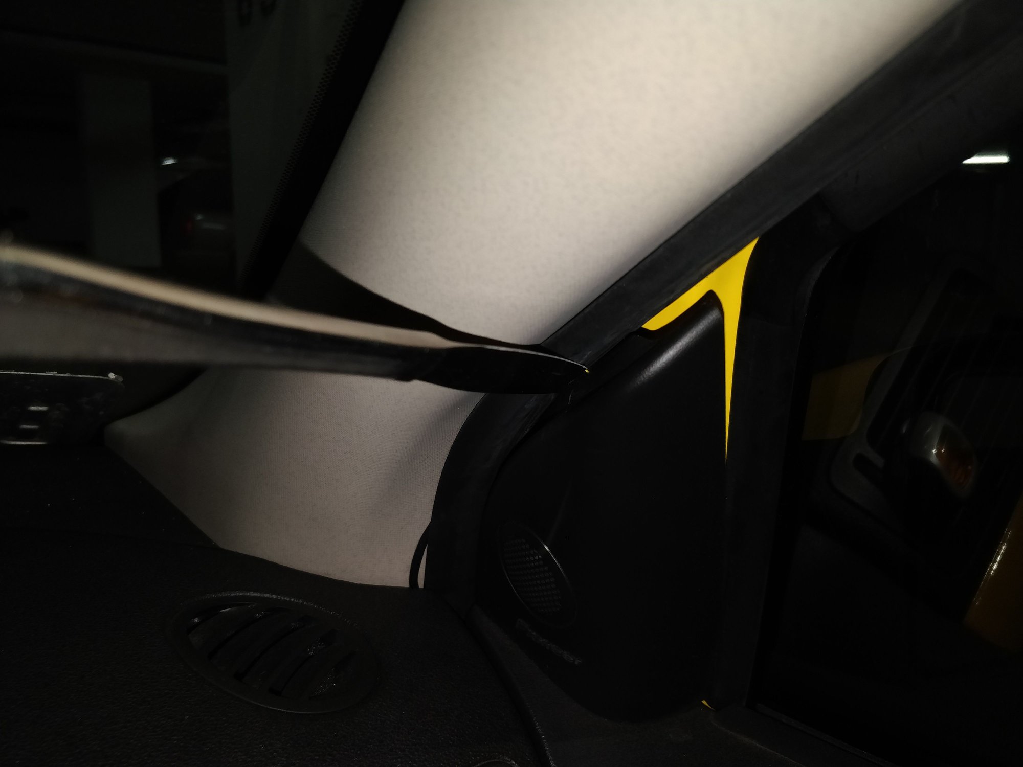

I had to do this once as a knucklehead friend of mine got the seatbelt buckle lodged in the frame and my door was jammed shut. I'll take a picture of how I did it when I get home.

Ok disclaimer - you may break some clips or the panel. If I remember correctly, I ended up having to buy a new panel from the junkyard after this.
Assuming you can still operate the window for the passenger side:
Step 1: Pull speaker clips.
Step 2: Separate the overhang rubber from the window and the door panel across the door
Step 3: Push on the butterknife (you may need multiple butterknives for better leverage) and start separating the door panel from the door
Step 4: Continue pushing upwards on the knife or knives until the clips come off. Continue on rest of top of panel and/or move to the side from inside the car.
