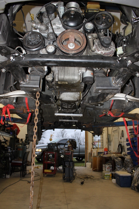

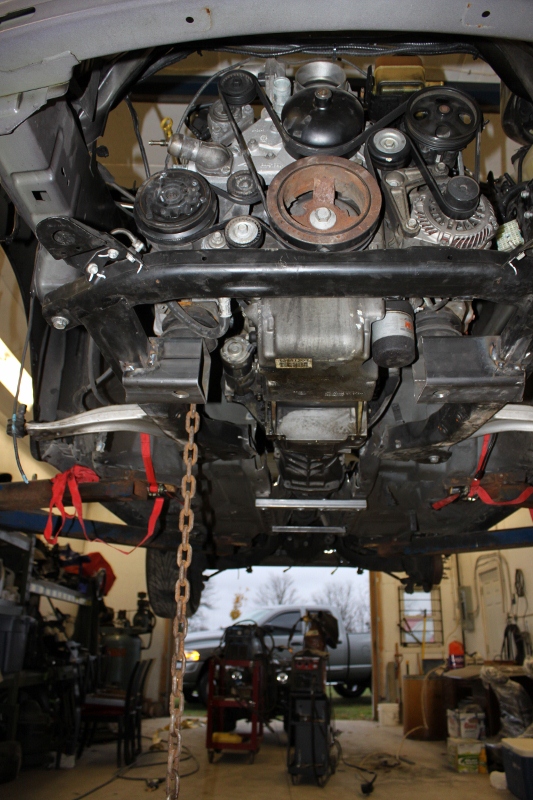

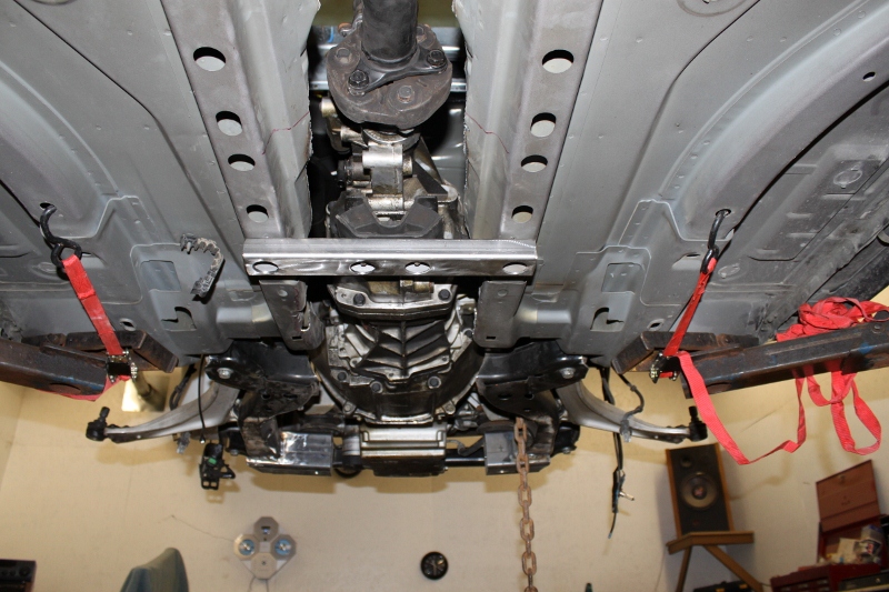

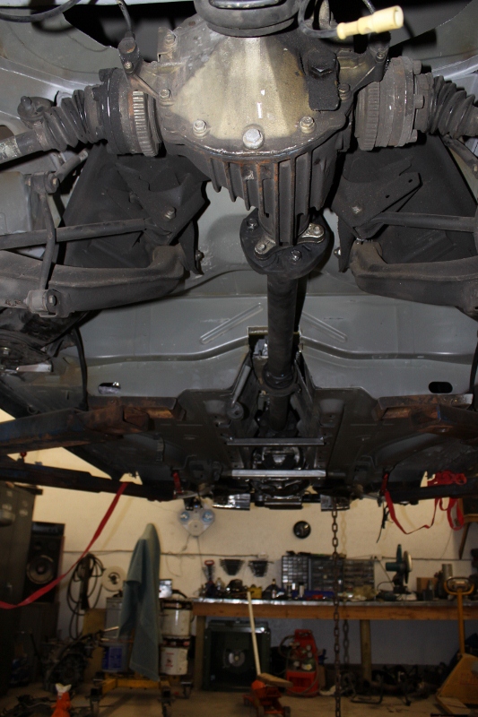

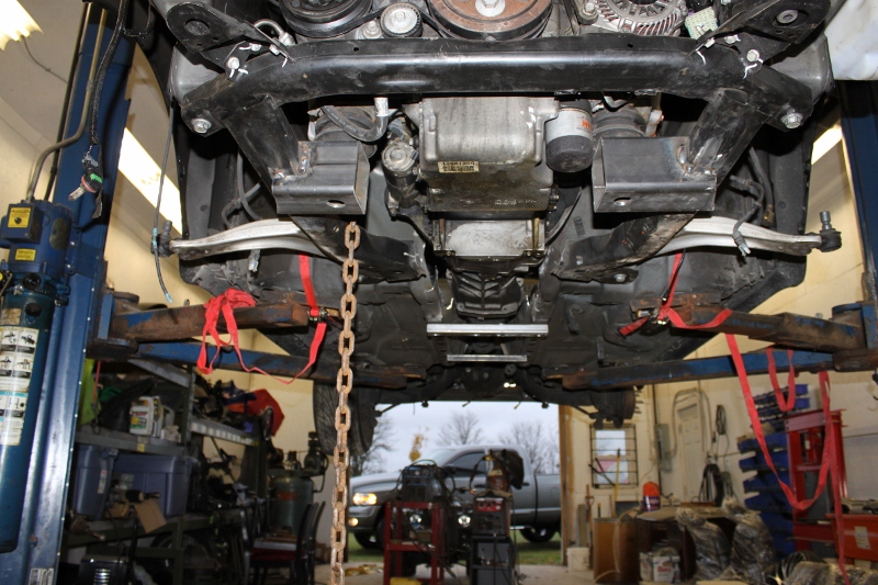

Updated 10/28/2012:
Well the motor mounts and tranny mounts are temporarily in. Need to make the hanger bearing mount yet though. the car can now be suspended in the air with the motor and tranny installed.. Im calling this the halfway point!
