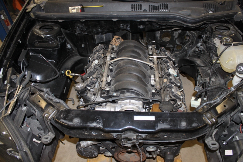

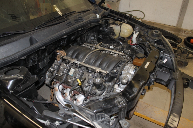

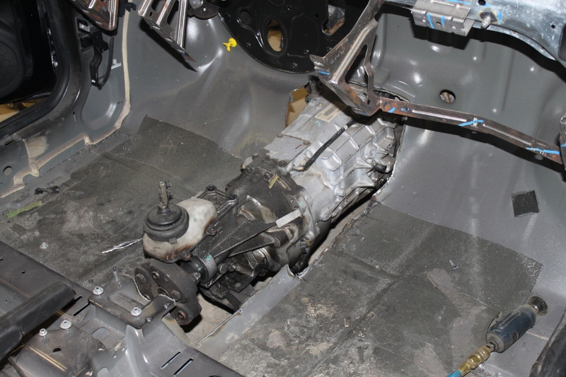

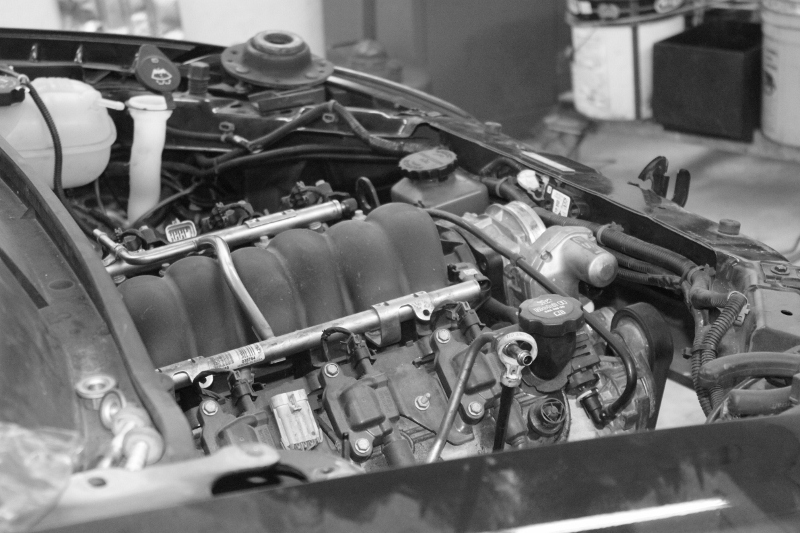

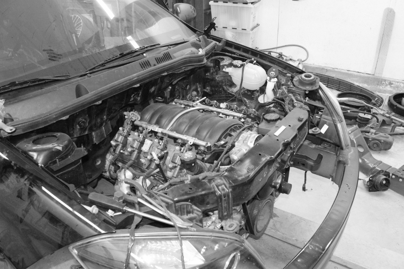

More progress up on the webpage.. Tunnel is cut out and the motor has almost found its resting place.. She's looking good in that engine bay man!!.. Pretty much soaked my pants when I dropped the car over the motor
