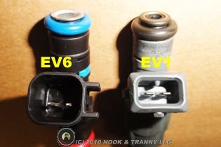

Not a good sign you already have the mallet out lol. Sharkey covered it all. You have mostly everything there you need to swap. You could probably even make the ION intake work if you got a little creative. I'm not real familiar with the ION intake or if the MAF style is different though. Like Sharkey mentioned ZZP offers pieces parts, like a small inline MAF housing section, to aid in piecing together your own intake if you choose to. One thing I would recommend is to buying 60 or 80#/hr aftermarket injectors instead of using the ION injectors to give you more fueling capacity. If the 2007 is like my 2006 the injectors use a different connector style than the LSJ. Of course you could also rob the connectors from the ION and rewire to accept the different injectors but just a heads up.

Thank you to everyone whose responded so far I appreciate the advice. I took the fuel rail out of the ion and they're lucas 42# injectors. Some thick injectors lol. I messaged zzp and they said the lucas 42# injectors would work on upto a 3.1" pulley on 93 octane. I'd need the ev6 to ev1 extensions which zzp sells but I'm debating if I should just buy 60# now since the fuel rail isn't easy to get to with the blower hooked up. I'm going to swap pretty much everything over and upgrade a few things like the intercooler which I'm going through zzp for everything and I'm adding a wide band a/f ratio gauge.

I'm still using the stock L61 fuel rail but I'm assuming yours should be similar. No problem at all pulling injectors with rail with the supercharger installed. If you have the 42# and plan on staying pump gas hell I would run them. It sounds like this is going to be your daily so probably no reason to go below 3.1" pulley for a while anyway.
