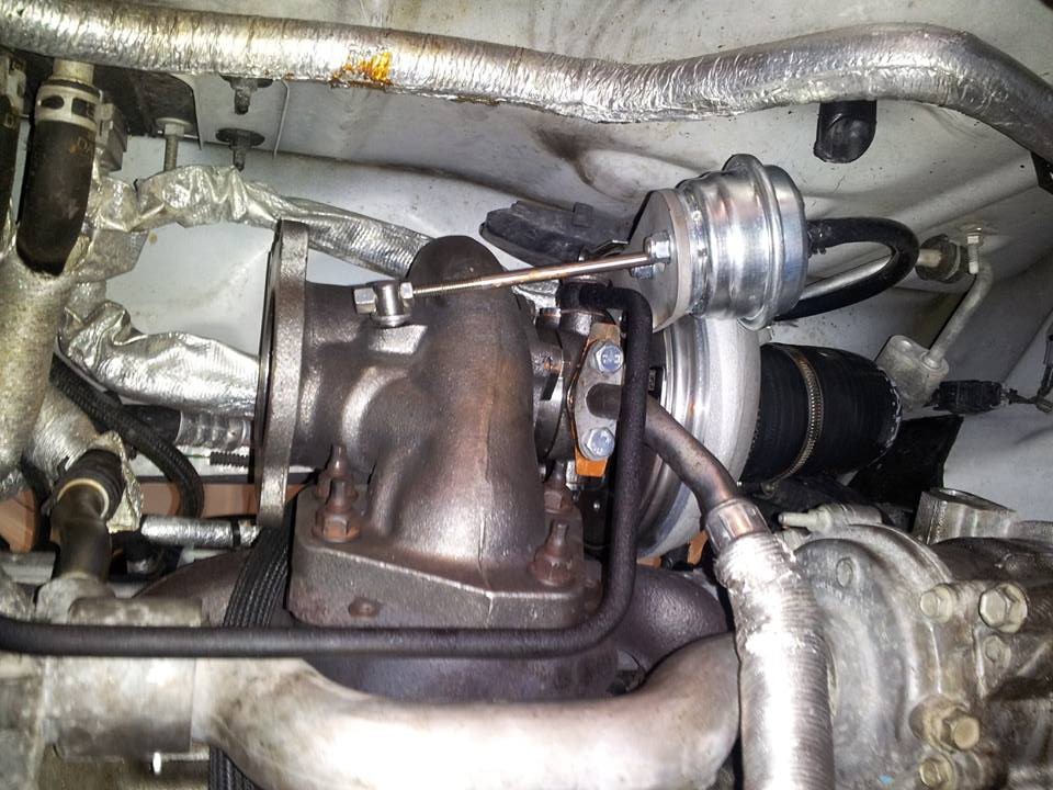

finally done. now to see zzp on monday lol.

^^ Is that a ZFR? If so, do yourself a huge favor and tighten that waste gate rod a bunch. Term and I wasted probably 10 tune versions/logs before adjusting mine and finally reaching higher boost levels. Also, put a second nut on either side, they tend to work themselves loose causing you to lose all boost (ask me how I know) Here's a picture of what mine is currently set at. Mind you I'm at 5,200 feet so I need a little more boost ;-)
(This is obviously the inner set of nuts tightened before putting it back on the turbo)

well wtf! lol. wish i saw this before when i had it up on the lift :P so may be a stupid question, but how do i tighten the rod? didnt really look at it. lol.

Well if ZZP is tuning you I'd check with them since they've do a lot of these. If you tighten it too much you'll get surge which has to be adjusted in the tune.
But how you tighten it is basically move everything over to the right in your picture. I'd at least install extra nuts. The stock turbo has a little bracket to keep the rod from moving but the ZFR doesn't. Better safe than sorry, it's a nightmare to adjust this once everything is on the car. You may want to take the WG off to do it like I did.
