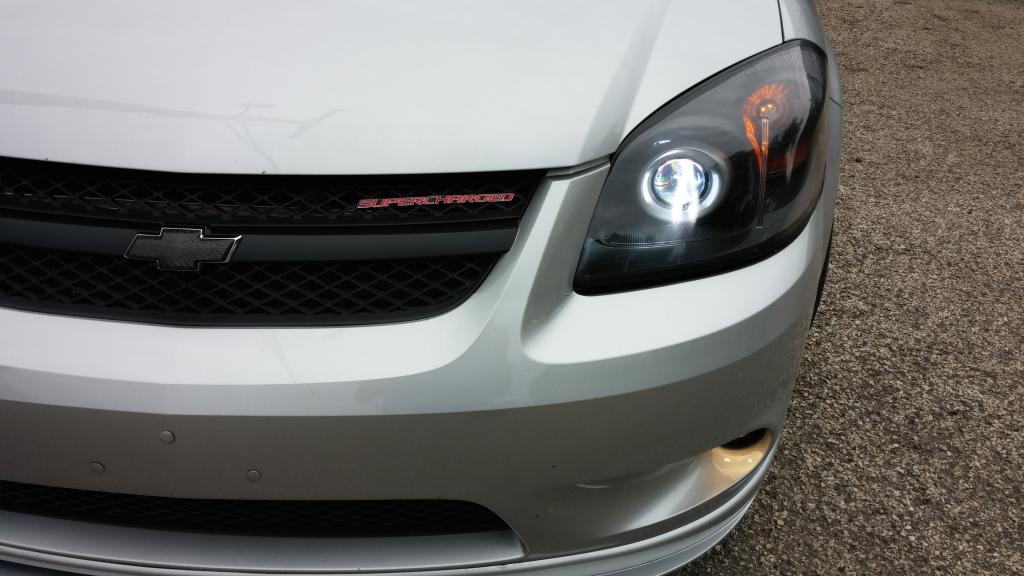

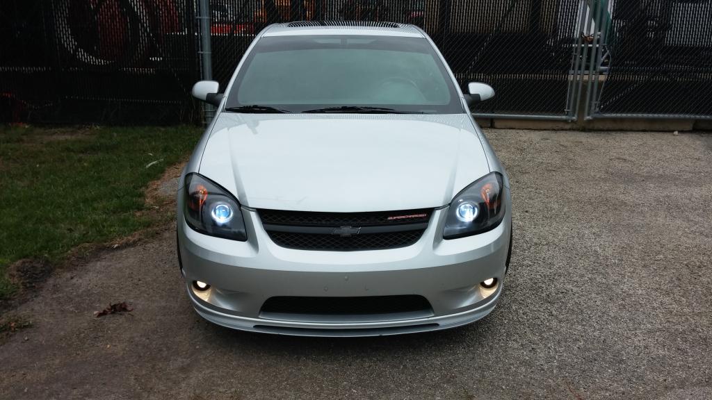

recent stuff...
put new foglights in... my hid kit crapped out on me and i just didn't wanna get a new one so oem bulbs it is
supercharged logo

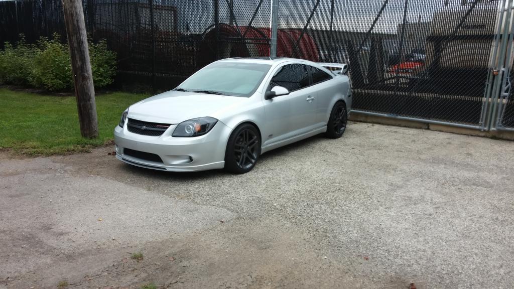

new wheels semi recently

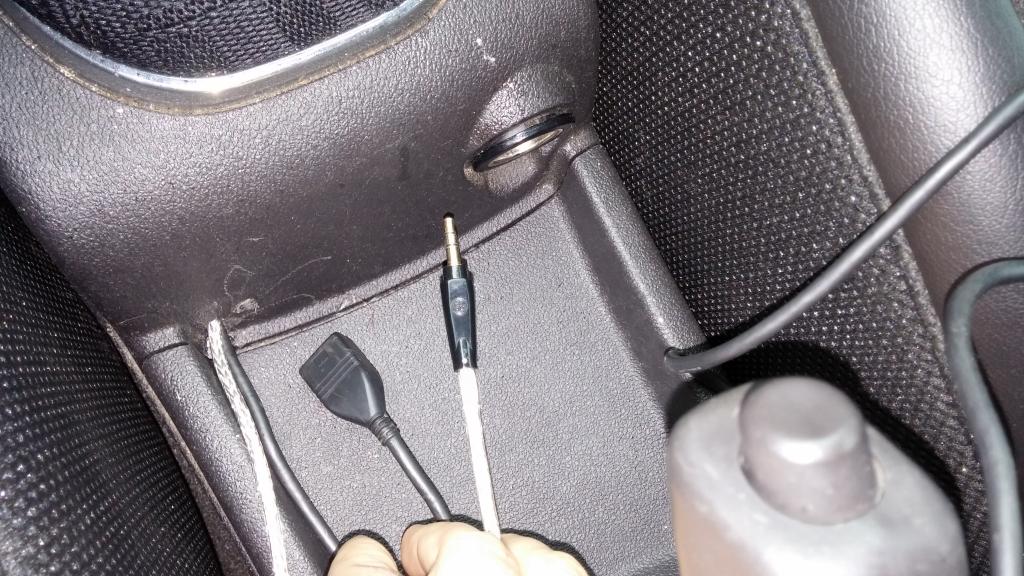

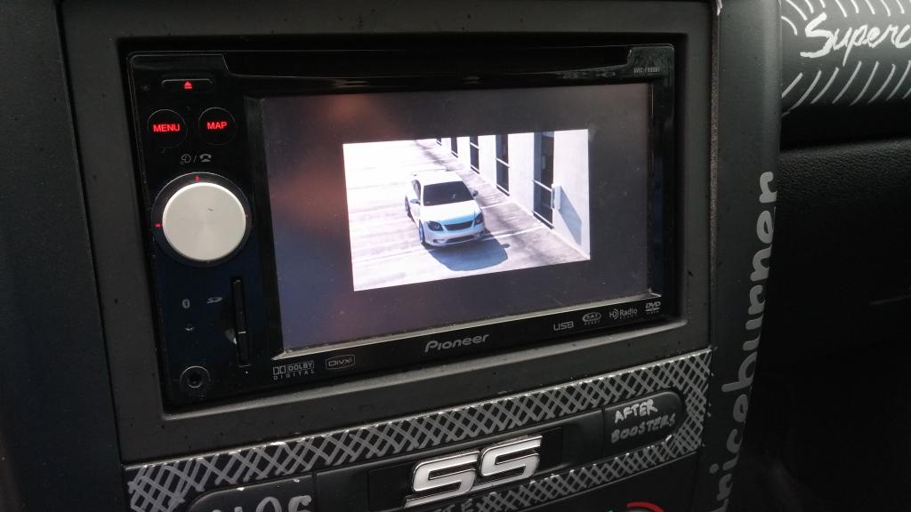

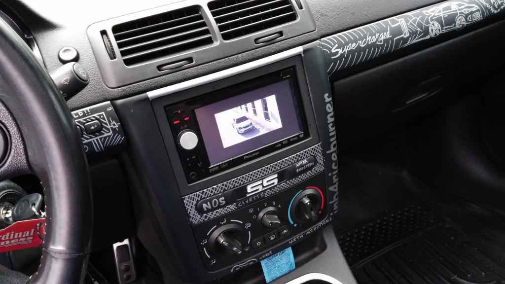

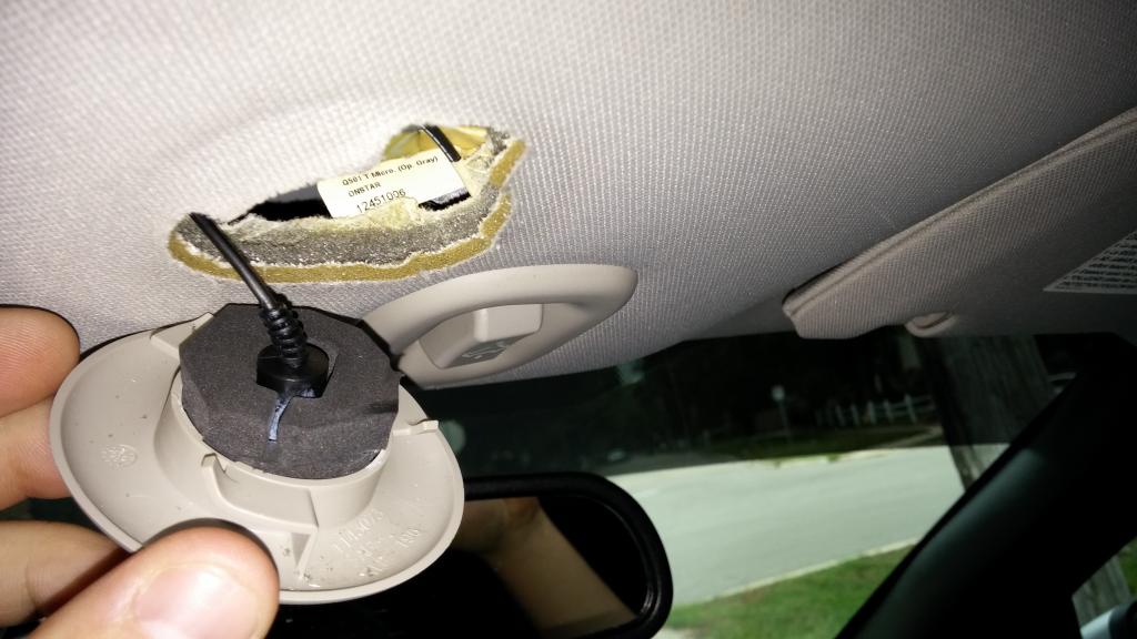

and installed a pioneer avic-f900bt. had gps, bluetooth, and dvd playback etc.
didn't take many pics of the lengthy install but after a few days of jerking around i got it all sorted out. wired a switch so i don't have to deal with the ebrake, mounted the gps antenna behind a rear headrest, and got rid of the stock onstar mic so i had a place to hide the bluetooth microphone. out of sight, out of mind
also ran the included usb wire and a new headphone jack wire to come out by the ebrake.

Thats a Clean install bro! love the AVIC line, had one in my old cobalt, yours have the free GPS to?
oh and as for DVD's and such I just bypassed the ebrake thing, no switch needed.
i bought a bypass unit off ebay that does it

yeah I ended up using some youtube video, was a while ago but it involved pulling a wire out the harness from the unit and putting a different wire in its place, I know the wire was yellow lol, like I Said it was a while ago but worked perfect

The new units have micro switches in them you cant just change wires or use a relay/switch. They make modules for doing it now.
my units from 20012ish so it had micro switch
however the cheepo unit i put in my truck doesn't and i just grounded the e-brake wire

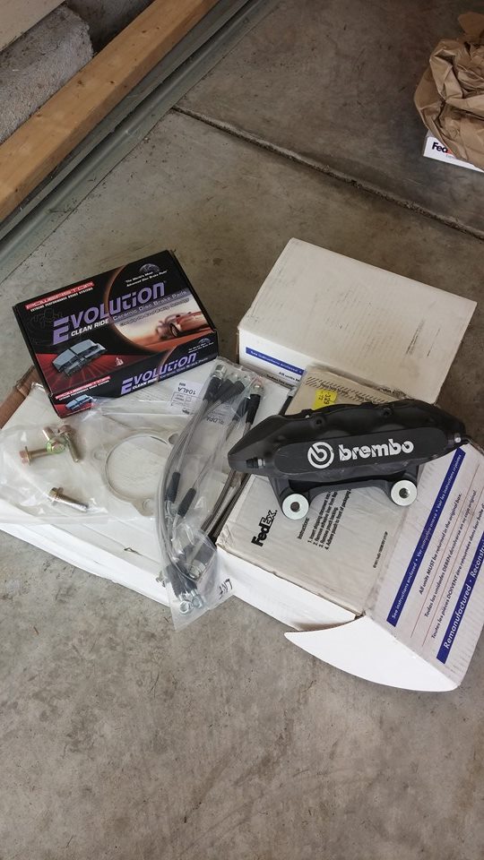

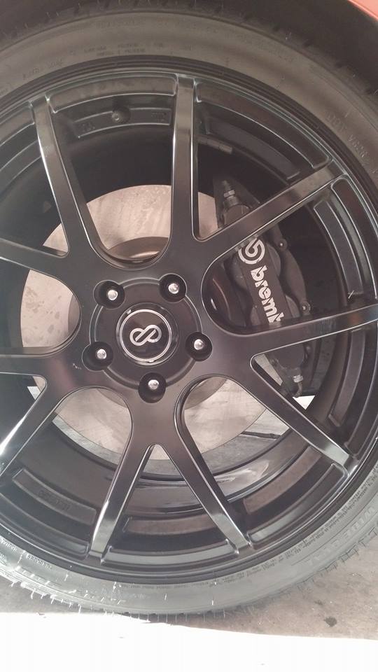

Installed some brembos on my 06 ss/sc Getting ready for some track time coming soon and the stock brakes were not cutting it. I have a different set of rotors and pads for track events, the ones pictured are just for street use.

Did you wire in a switch for the video playback? If so why not wire in a relay so you dont have to mess with the switch? Also do you have anything in your secret compartment? When i was using my Iphone as an Ipod i ran the wires over to that compartment. You could also go to radio shack and they have the double female audio plug that you can install by your ebrake so you dont have those wires coming out like that, because i know how clean you like stuff to look lol

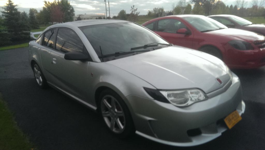

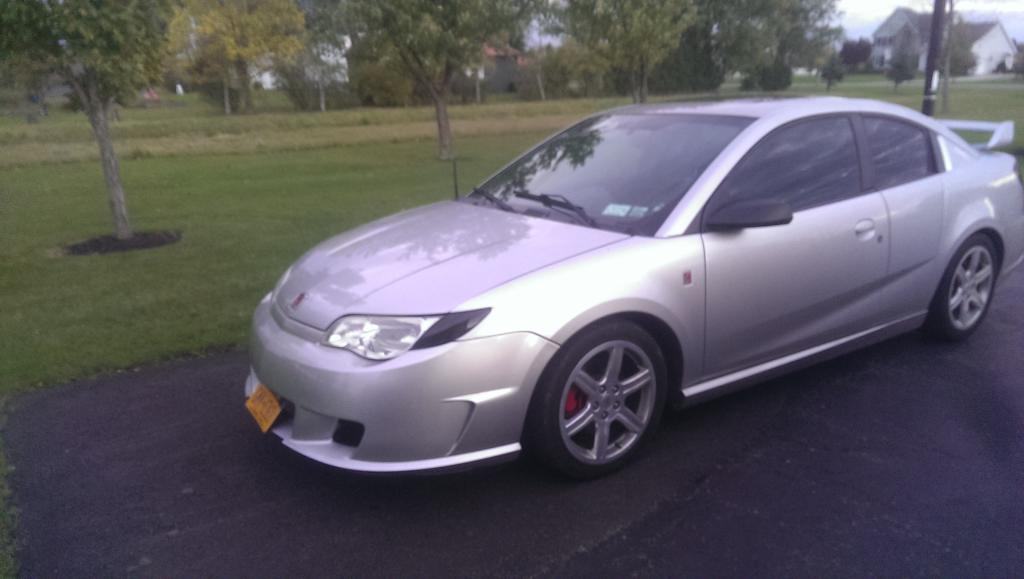

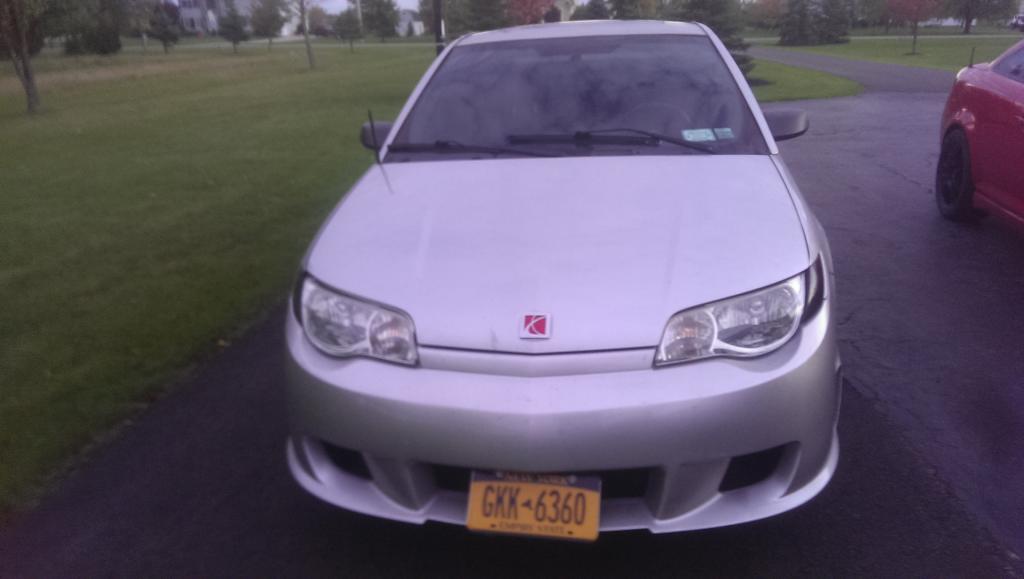

Parked this next to it
Say hello to my second car, sitting at exactly 68,900 in my driveway. Amazing considering it's an 04 all stock too besides a K&N intake and a Hurst STS (which is absolute crap FYI). Those are the old plates, new ones will be on tomorrow and to order the custom plates as well. To be honest I probably will make some modifications, on another note I now have 3 sets of Ion Redline wheels...

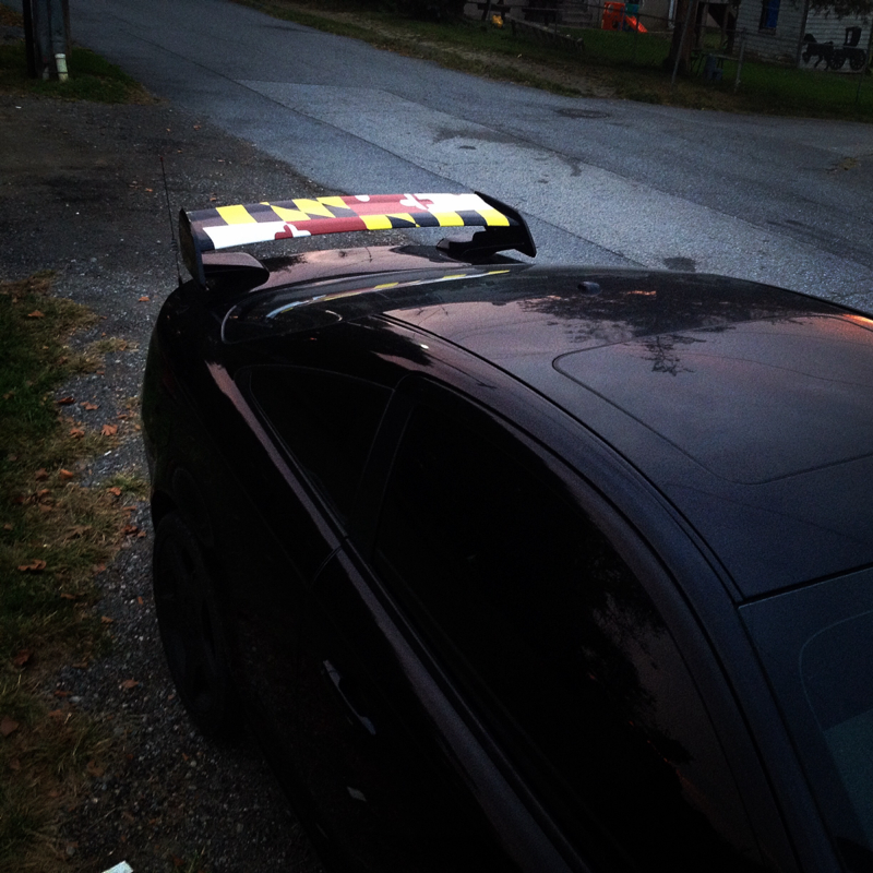

Put Maryland flag vinyl on spoiler
