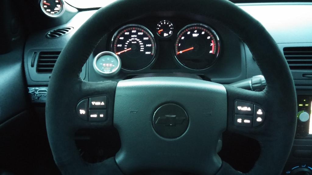

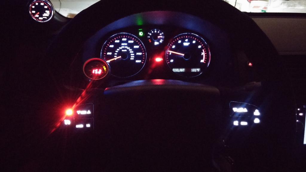

thanks to rains_crusader i got white leds installed everywhere. gauges, window switches, hvac, everything. red leds in the cruise control and ac/recirculate/defrost buttons. modification to the gauge face was needed to really shine white and red. no it wasn't cheap, yes its worth it. lol

Looks nice! I eventually want to do something like that
right that looks bomb

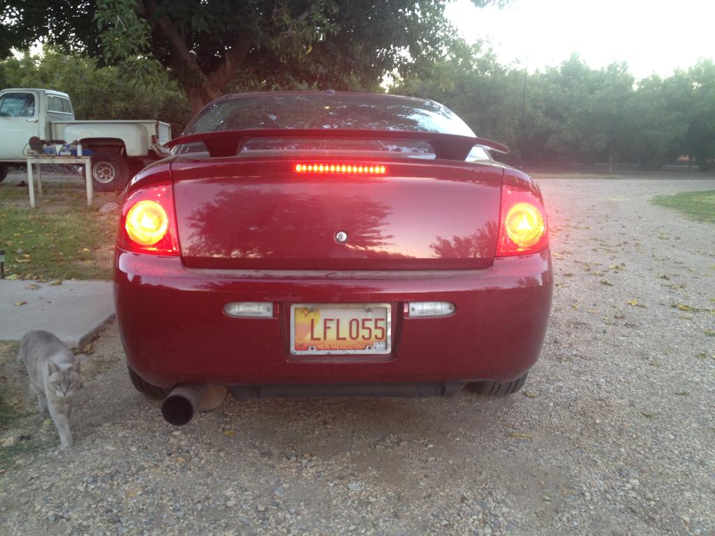

I got my third brake light working again and put my second one up for sale on CL

how much were u selling it for? led?

For anyone on CL, $70. For you, $50. Give me your stocker and $35 if yours isn't melted like the one I got from my G5. I can't buy a melted one because no-one would buy it once I swap it too. This one isn't melted at all. And kinda yes LED, technically it is called CMD but you get the idea. Got the board from the Impala/Monte Carlo.

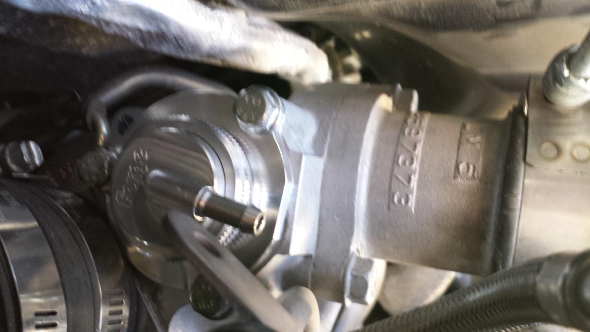

Installed my forged bpv sounds way better than with just the intake on it. Only thing is im not to sure i placed it correctly lol
Well turn the pic left idk why it came out like that so the bpv is facing up and towards the engine.

Is the bpv hard to change?

Nah it super simple. Take your intake out for more room take out the 3-10mm bolts. change bpv and put the bolts and intake back up and your good to go probably took me like 10 to 15 to do wasnt keeping time lol but wasnt long

Eddie there's a slotted hole in the BPV make sure it's facing downward.

Thanks mate ill look to make sure it have it installed correctly
