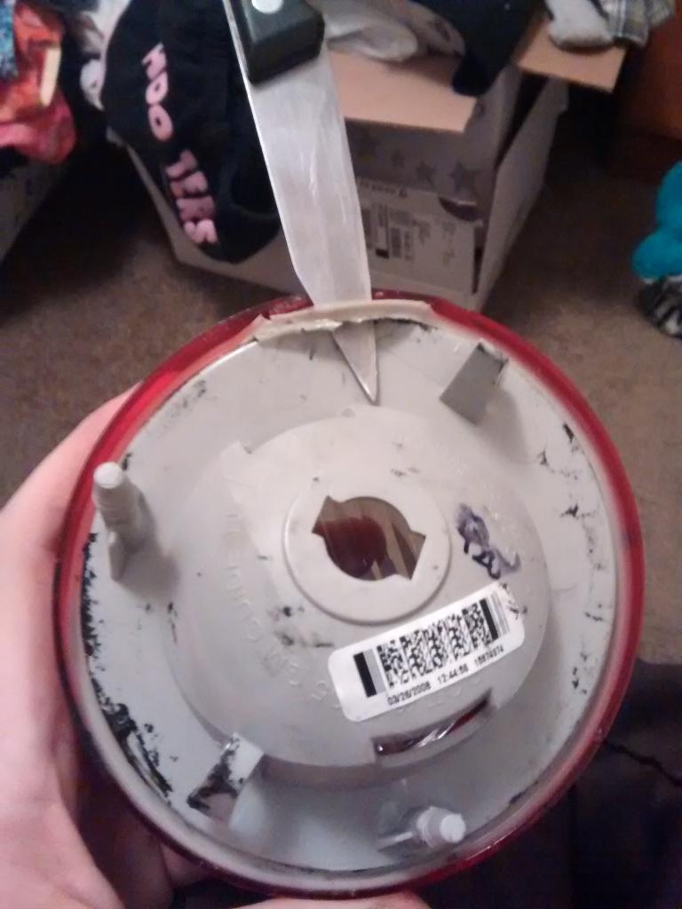

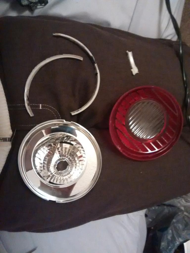

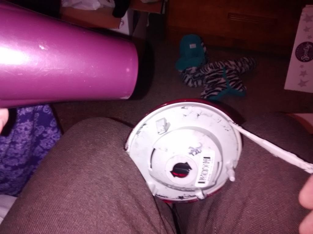

Managed to get one middle tail light apart last night.
It turned out to be much easier than I anticipated.
People said you have to cut them, but I found that is not the case.
I just heated up a 1-1.5 inch space of the sealant, jammed a knife in there, popped out the sealant, then just started to pull it out as I heated it up with the hair dryer.
Thanks SteveoElSupremo for some tips.

Had to do that **** in my gf's room... She wouldn't let me take the hair dyer out ro the garage because "I'll break it!"
Took the other three to work today and used a heat gun.
Only took about 15 minutes
